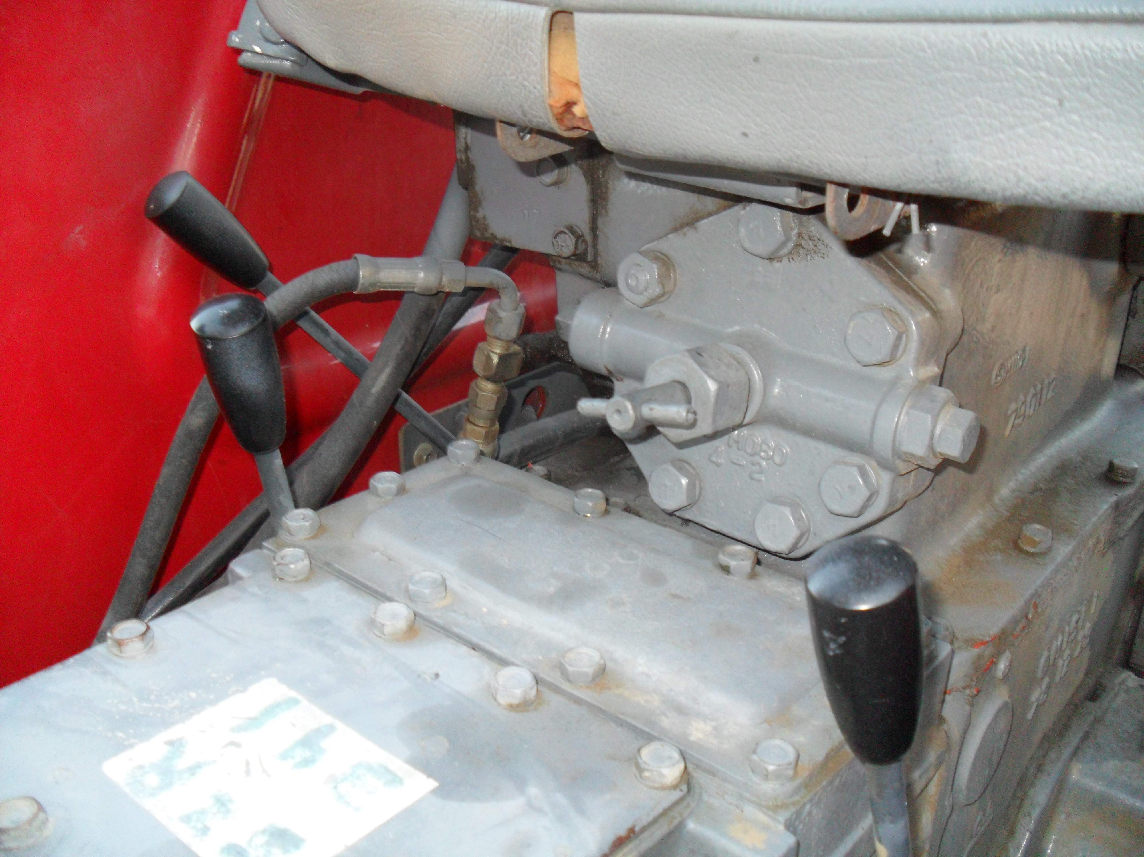

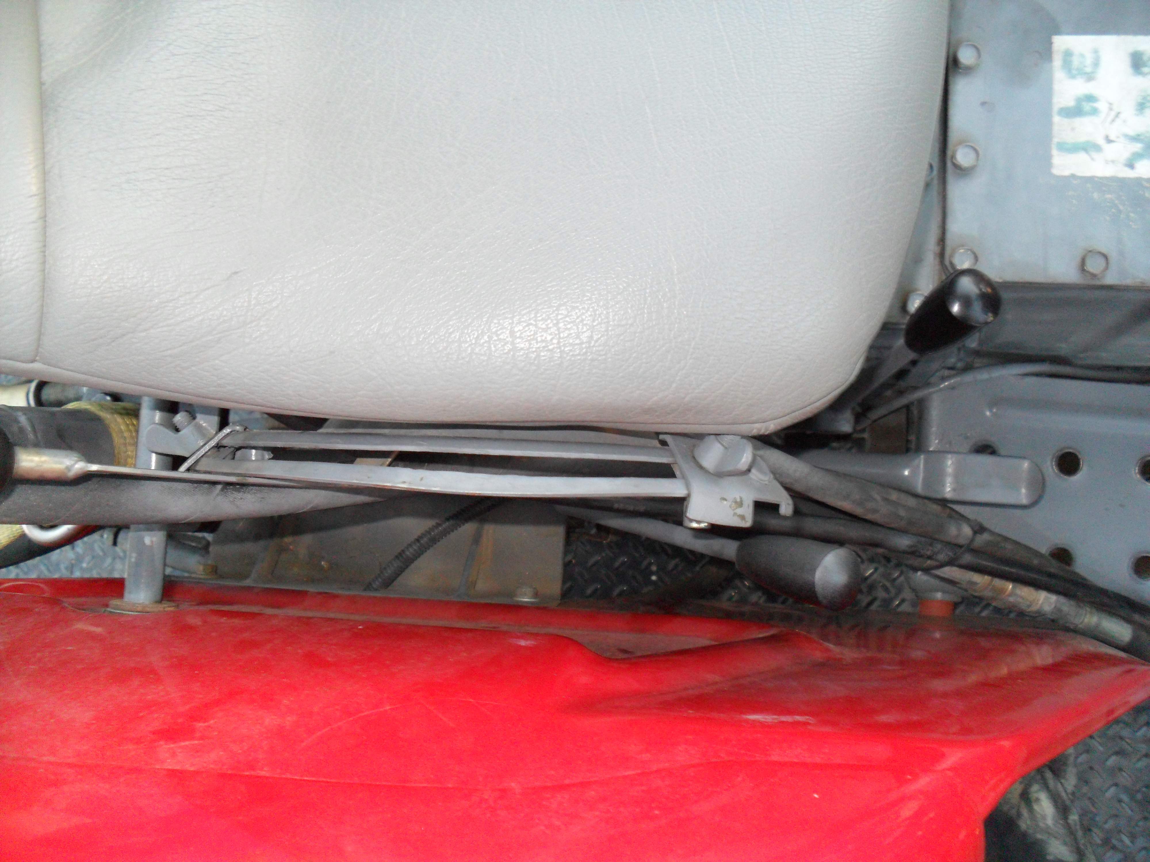

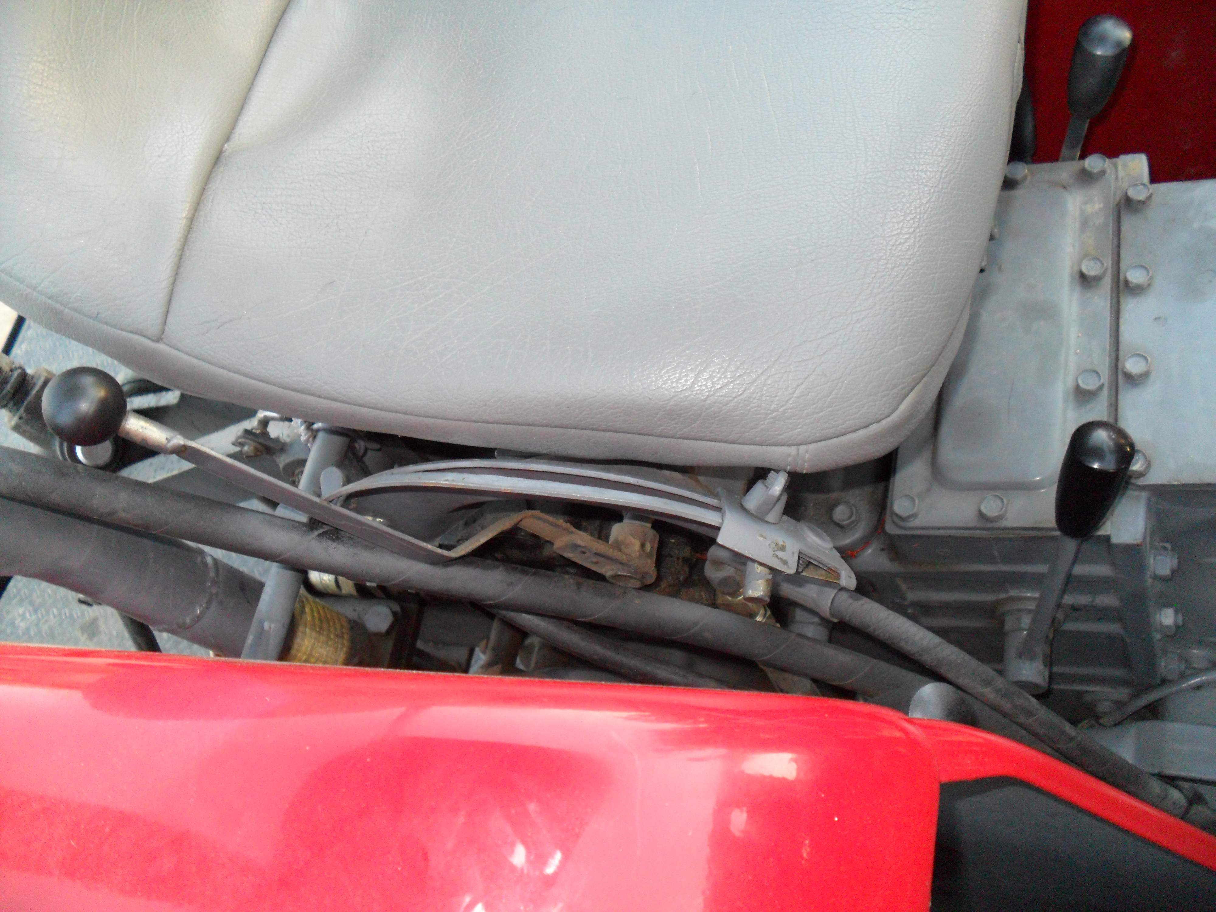

Wolfy,
Here are pics of the controls aroundthe seat that I'm unsure of about name and function. Thank you for your assistance

   / Shibaura SD1840 manual & hydraulics question #19
I would think, the flat gray is the diff lock. Looks like your 3pt hitch has draft control. The black lever to the right looks like my 4wd. The black lever to the left looks like a creeper shifter...I can't be sure though, since I don't have creeper gears or draft control. But I have seen pictures and read about them.
   / Shibaura SD1840 manual & hydraulics question #20
The black tilted lever to the far right, below the 3pt controls, that one looks like what engages the PTO. The little valve under the seat adjusts the 3pt arm lowering speed.
