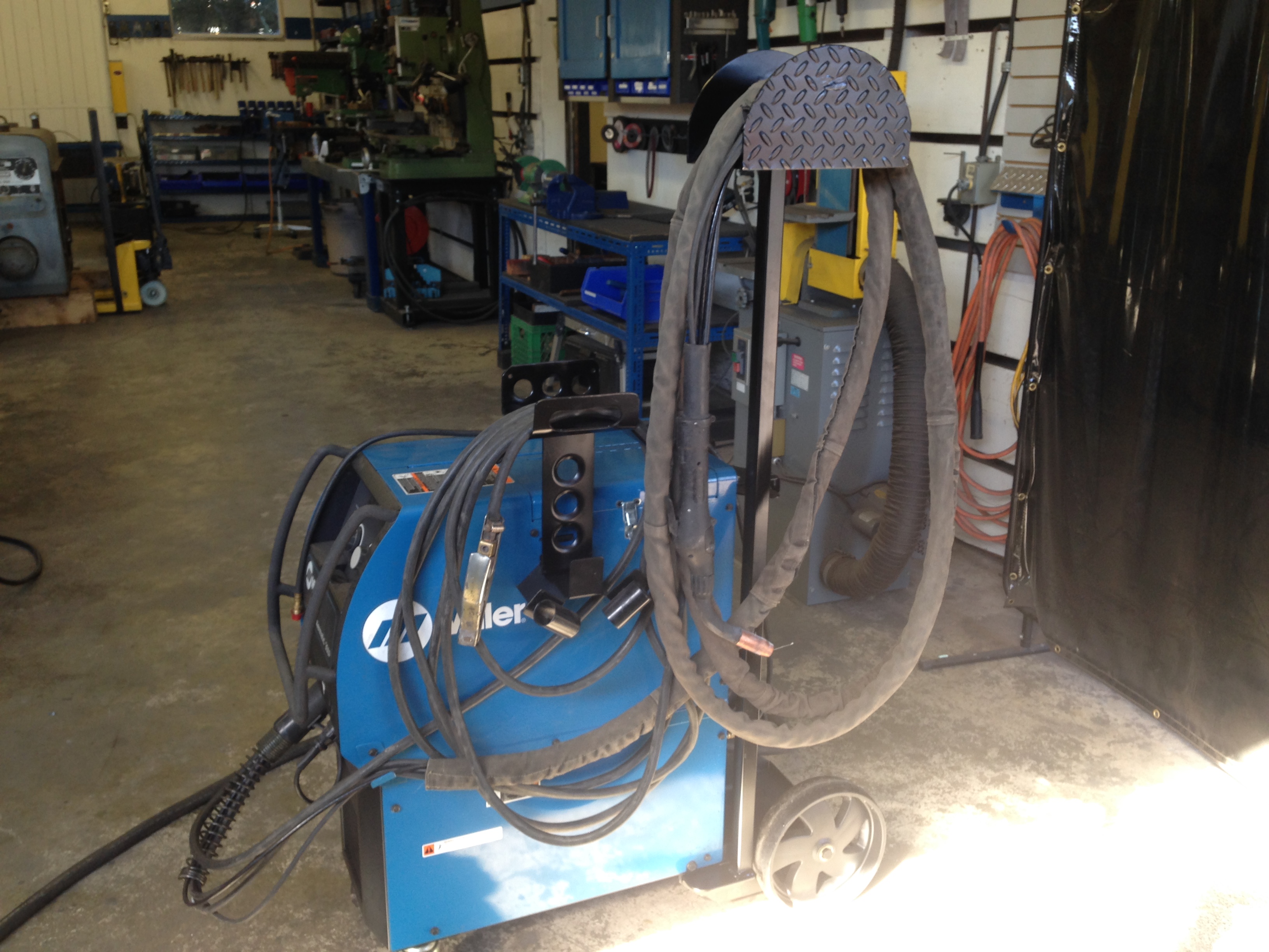

This is the cart that holds my XMT350. It is set up for two shorter tanks which would not be suitable for you. It has holders for a spool gun and a spot for the WC24 contactor.
Feeder on top and BB “tip and drop” holder to secure Miller Extreme plasma cutter OR Miller Maxstar 150

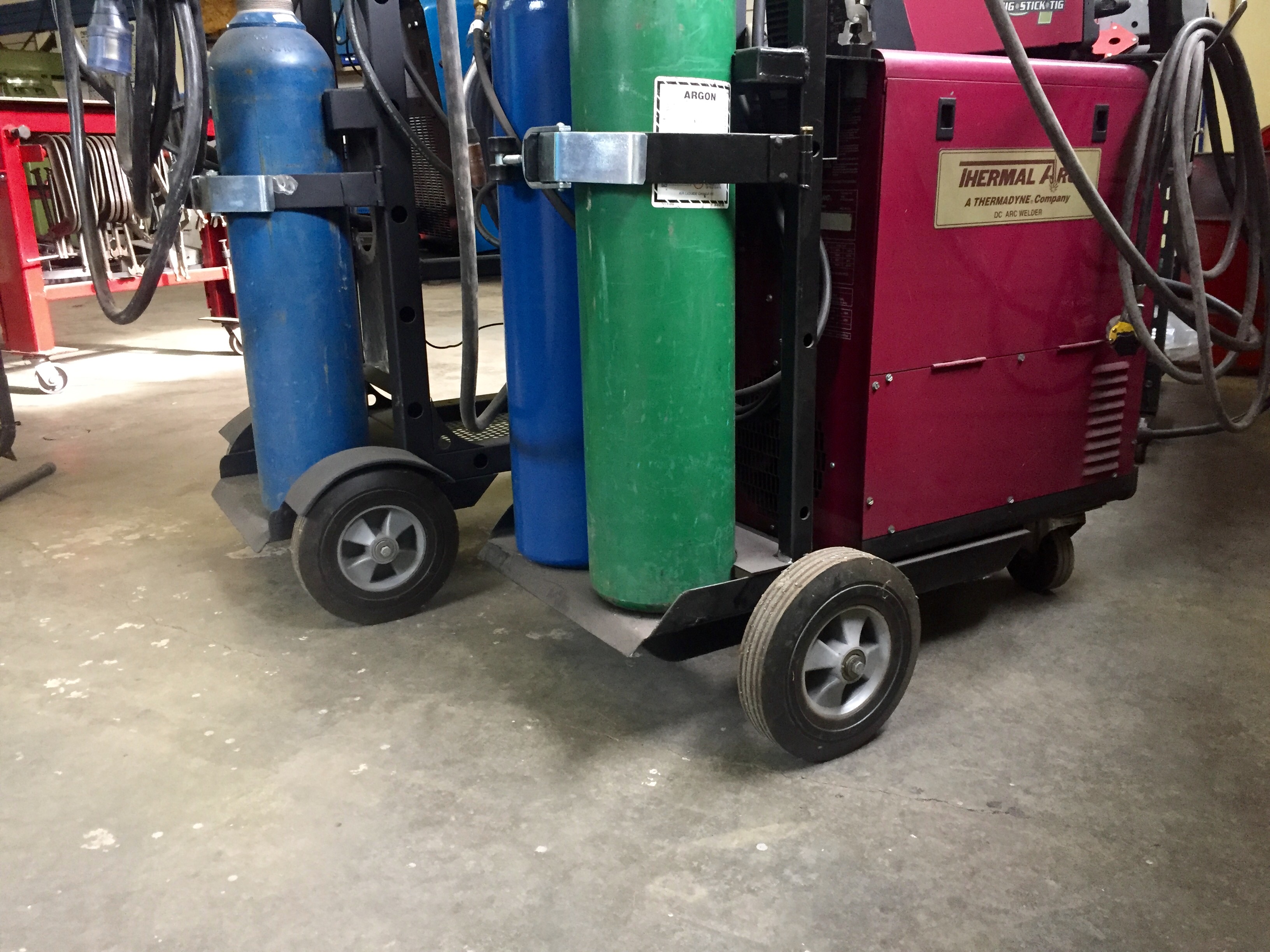

Here’s a pic of two tanks per cart
Here’s the original cart I posted with a Syncrowave I have since sold. The cart will need to be modified to accommodate a different welder if it requires two tanks.

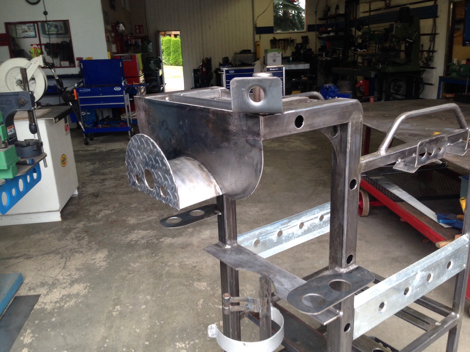

Perhaps a more revealing photo prior to paint.

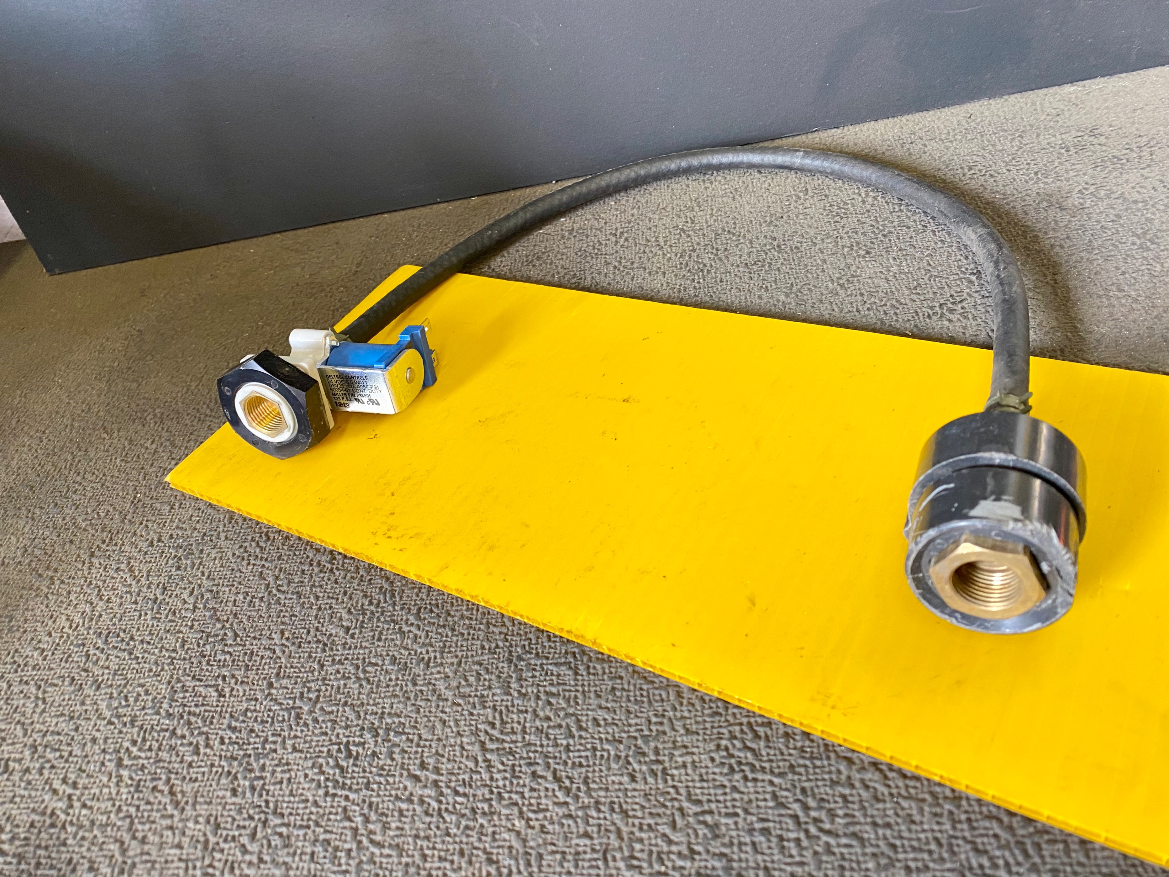

Let me know if you decide to DC tig with the XMT. I have an extra gas solenoid valve with pig tail for plug and play (if your machine doesn’t have one) that you can have. It’s light I can just mail it out to you.
I sold one of my two XMT 350’s and I saved the solenoid for the welder I kept but I will never need it. I can just use the torch valve if I tig.
I just looked to be sure I still had it
It has a panel plug for the front of your machine.
