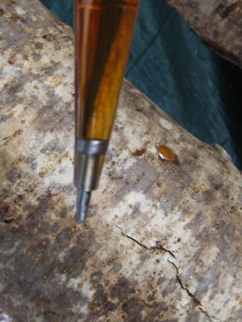

I've settled into logs 42" in length and 5" to 10" in diameter. I have also started looking for the straightest and smoothest ones, as they are easier to work with. My speeds of inoculating have gotten much faster with practice.
What's slowing me down now is waiting for the wax to get stiff so I can go onto the next row of holes. I am going to try drilling the next row on an angle while the wax has time to harden up. I tried this before and gave up, as I had a hard time getting the rows to come up vertical when the log was rotated up for waxing. It's been hard for me to judge it right when I tried it before. If the rims of the filled holes are not horizontal, the wax pours out the low side. I try to get a nice neat seal on each hole.

My book calls for the wax to be between 240 and 300 degrees. At lower temperatures the wax doesn't bond well to the sides of the drill hole and forms a little wax pill that easily falls out when solidified. I've seen this myself.
So, I had been using 300 degree wax until I built the waxing tool from a turkey baster. 300 melted it. I have been getting away with 275 degrees with the cheap turkey baster from the supermarket, but the tube cracked after a week or so. I see there are glass or stainless ones available online. I will be upgrading to one of those.
The tool is made by cutting off a nail so that the end sticks out of the baster about a 1/4" and the head inside the baster acts as a valve. It works really well.

#69
Here's a pic of the wax tool. I used a stainless screw with the threads ground off instead of a nail.
   / Shiitake Growing On Logs #70
Thats a real nice set up. How long does the wax stay liquid in the tube?
