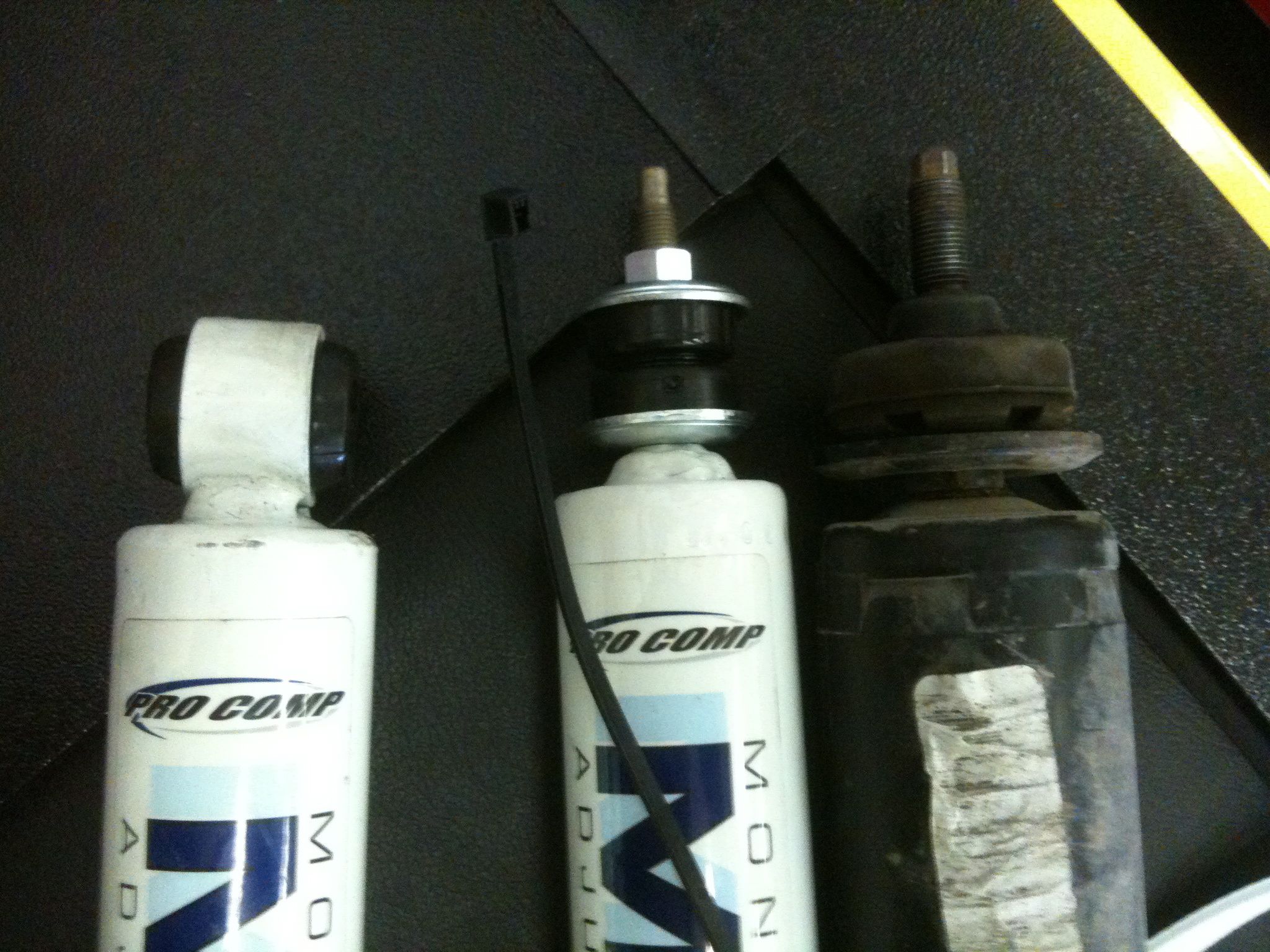

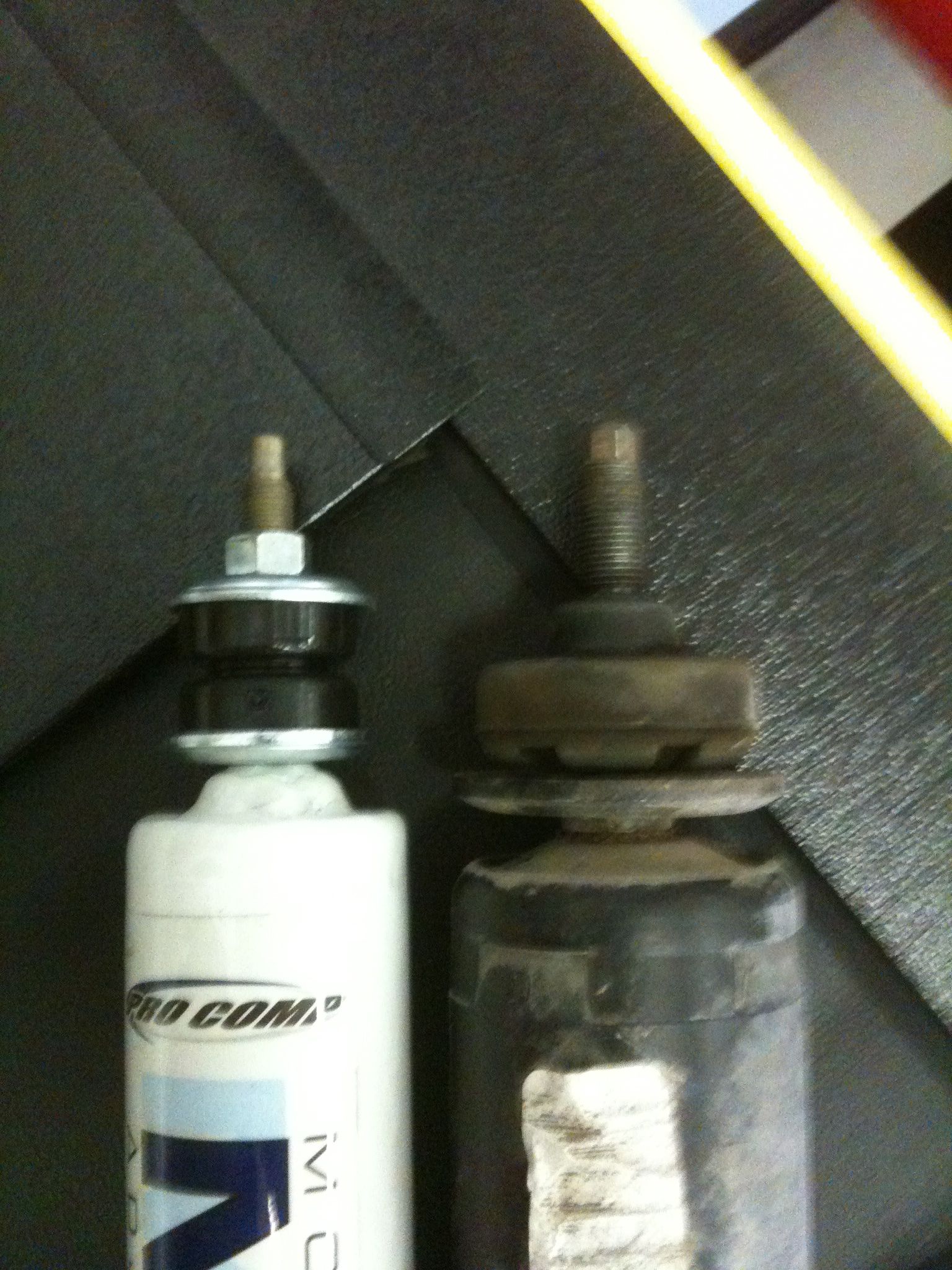

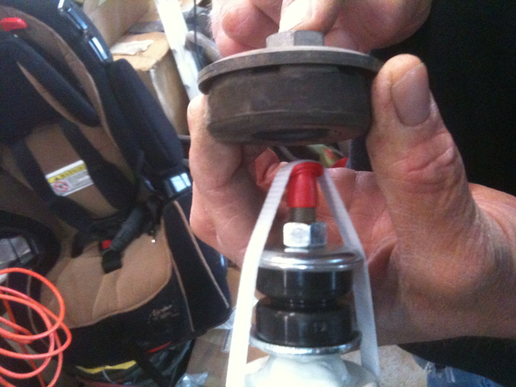

I got my procomp MX6 shocks. I put the rears on no problem.
I went to put the fronts on and the replacement shock looks kinda small on the top. It took a 15/16 deep socket to pull the top nut off.
The new shock rubber bushing, etc. is really small in comparison.
I just called the 4wheelparts line to confirm the part number - they say it is correct.
Comments?
D.

Wow!, that's a size difference all right. And they say that's the right part number? I don't know if I'd feel comfortable putting something that much smaller in place of the stock piece. Have you checked out any of the Dodge forums?, maybe some other owners have run into the same issue.

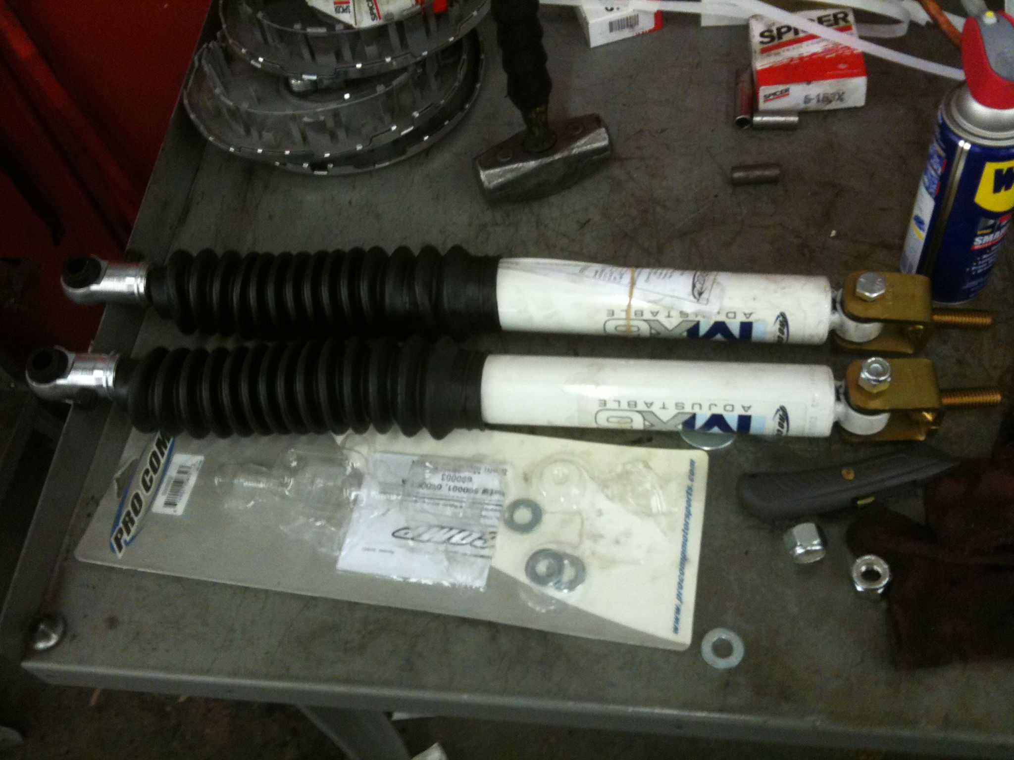

Ok - problem solved.
Mike and James at the 4 Wheel Parts store in Dallas rock.

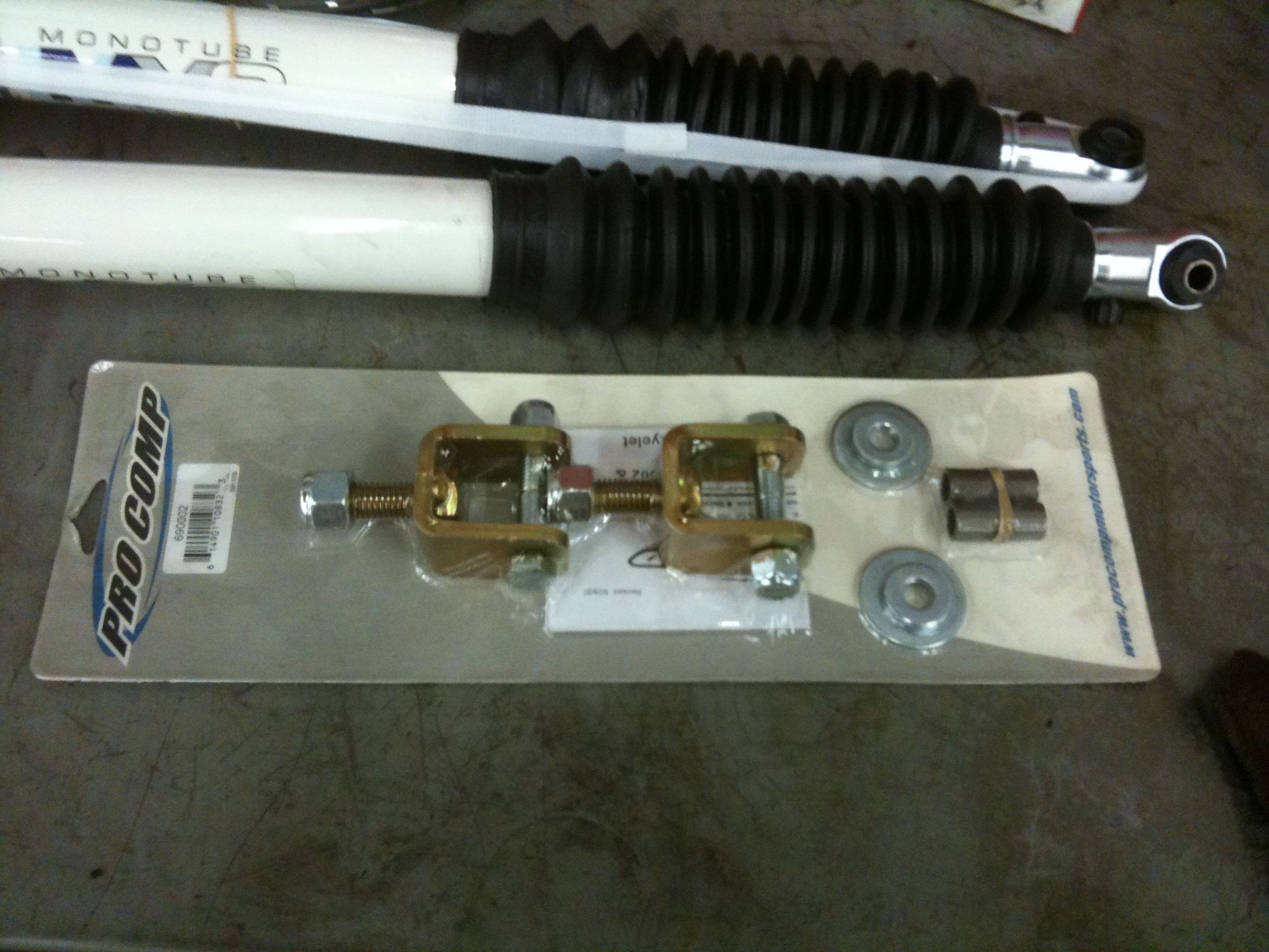

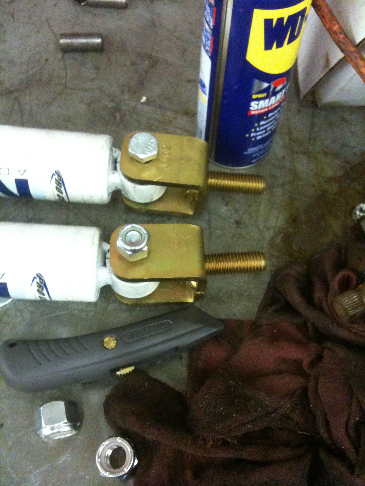

We replaced the MX6087 shocks with MX6004
Then we used a ProComp 690002 shock mount kit. Stem mount to eyelet.
It is stout now. I will post pics when I get home.
These MX6s sure ride better than the stock ones with 79K miles on them.
D.

Here are pics.
It rides so much better. I have the shocks set in the middle setting.
