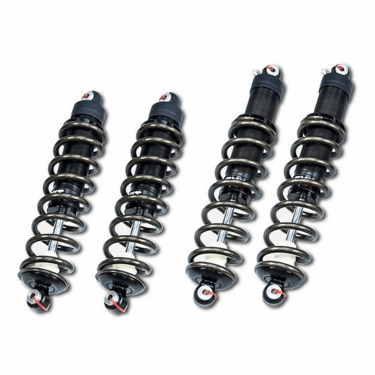

I'm no pro but I believe your springs, not the shocks, might be weak if you are bottoming out to much. This was what I found when I did a search of your machine.
  • zbroz-custom-x0-ifp-exit-series-shocks-set-of-4-2009-14-full-size-polaris-ranger-xp-800-and-2016.jpg
