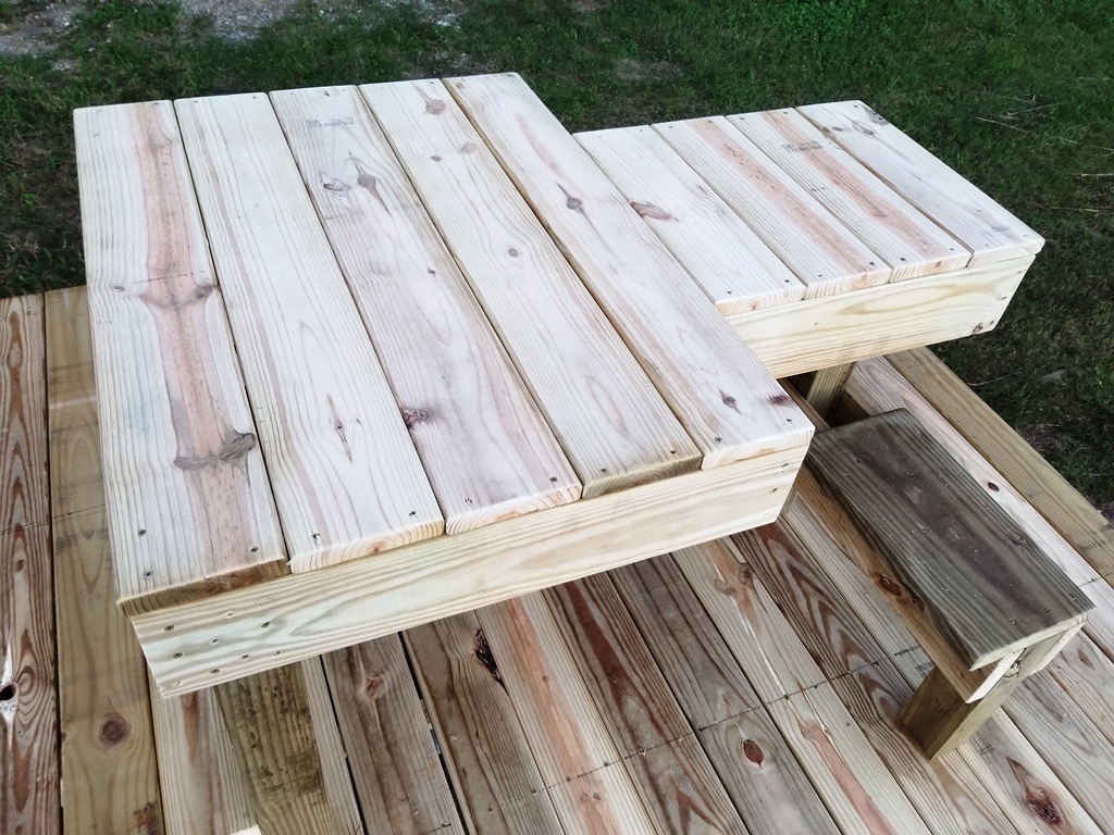

My land/range has an elevation change about midway so I need to be elevated to "shoot down" at the 300 yd berm. Otherwise would have had to build that berm 15' high. Anyway, making a platform to shoot from was much simpler solution. Version 1.0 lasted several years but was too small, a little wobbly, and just not done right the first time overall. So this weekend made a new platform and a new shooting bench. The bench just sits there so I can grab it with pallet forks and move it around if I want to shoot from a bench at some distance other than 300 yds. But still heavy enough to be pretty solid - not as solid as concrete or with legs set in concrete, but sturdy enough for my needs. Turned out well, but I need stiffen it up a little. Side to side, it's solid, front to back, has a little movement. Makes sense due to the direction of the wood and all the deck boards tying the top together that run side to side.

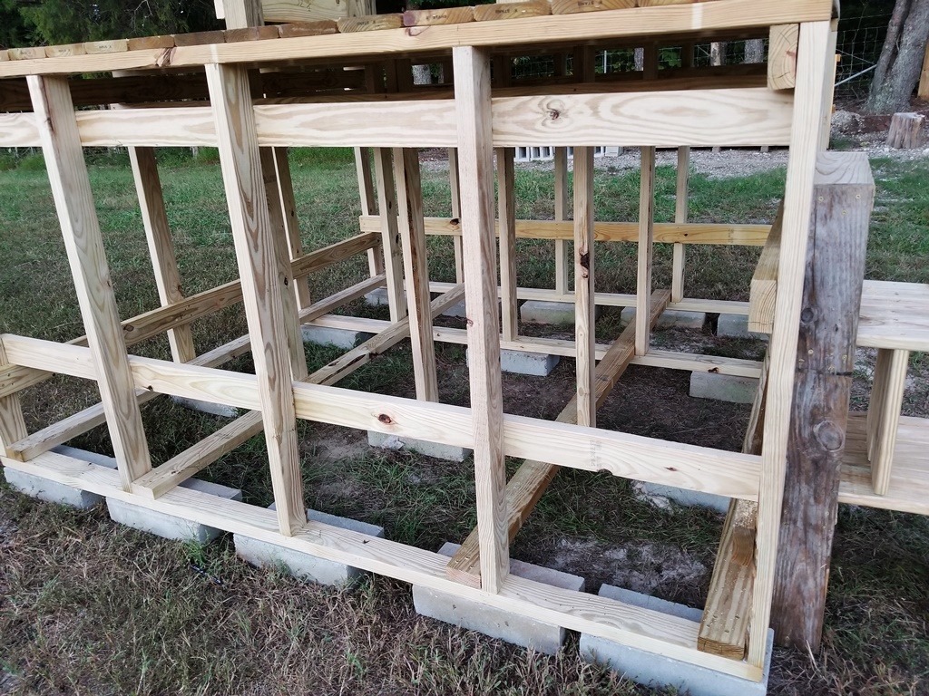

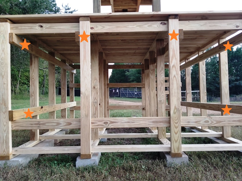

Other than sheathing the sides with plywood, what would make it more stable front-back? It is basically 4x 4-ft walls made from 2x4 on 24" centers. Those are spaced 32" apart. Tied together with 2x4 and the top is 5/4x6 decking. The pic with the orange stars shows where the pieces are that stabilize it front-back. Do I just need to simply add more? Or do I need diagonals running that direction? It's not "wobbly" and I don't feel like it's swaying about when I'm up there. But If I try to rock it side-side it just doesn't move, front-back it will a little.

Good grief - - open the front on that "shooting platform" and you have a good start to a substantial storage shed. To stiffen the shooting table - front to back - need front to back angle bracing of some type. From up under the fascia board on the front - down to the center leg back on the butt rest portion. A doubled up 2x4 would look right in place and give good support.
For that matter - you might want to go with an "X" pattern under the table for ultimate stiffness.
Somebody is a fine carpenter. I know families whose furniture is not as nice as that shooting table.
As far as staining/sealing - take a short chunk of that material used for the top of the shooting table. Set it out on your porch - where you can easily get to it and check it. Check it on a routine basis - you will know when the time is right.

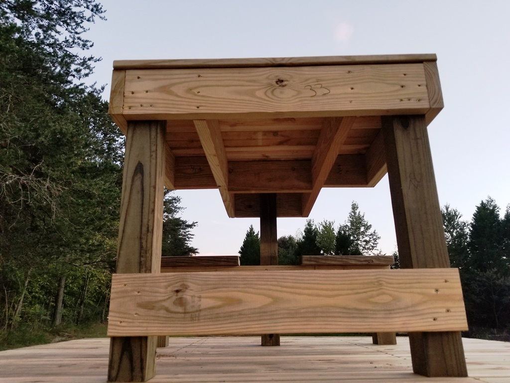

Nice bench;
I would add some eye bolts (6) top and bottom of the front and rear center leg.
Then use heavy smooth wire or cable with turnbuckles to preload the legs in an X,
that should take any wobble out and allow for further tensioning or relocating.
Also in the lower section (8).

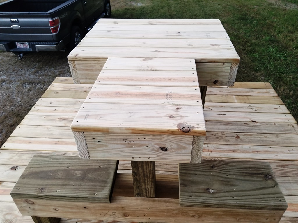

The last shooting bench I did. This is my neighbor's bench. I did the concrete table top, he did the treated wood work.
In a tub soaking up some water after I pulled it from the form. It stayed in the water about 3-4 days.

To stiffen any platform diagonals are needed. The strongest form is the triangle, not the rectangle. Since all the support pieces are 2x4s, all you should have to do is add a 2x4 diagonally in the direction it wiggles (top front to bottom back - or - bottom front to top back) and I'd fasten it to all the vertical boards it crosses as well which will help stiffen the diagonal brace (you probably only need one).

Thanks. Platform is probably overbuilt - since ver 1.0 didn't do that well, wanted to avoid the issue of needing to rebuild in a few years due to poor construction.
This is the shooting table: Free Shooting Bench Plans | MyOutdoorPlans | Free Woodworking Plans and Projects, DIY Shed, Wooden Playhouse, Pergola, Bbq Very simple build but like how it turned out. I cut the legs 10" shorter since not setting in ground and substituted 5/4x6 decking for the 1x6 boards for the table top since the deck boards were cheaper. Also subbed 2x10 for 2x14 for the seats because (1) Lowe's didn't have any PT 2x14 and (2) 14" or even 12" seemed too big for a seat.
The table itself is sturdy enough as is. Was going to add a little bracing since not setting in ground/concrete, but do want to be able to lift it and move it with pallet forks and additional bracing ideas seemed like they'd either get in my way using it or lifting it.
The larger 8x8 platform is what I'm wanting to stiffen up a little more in the front-back direction (or opposite direction that the top decking boards are laid). If diagonals best, how many? Would just one ~9' diagonal along each side be fine? Or all 4 "walls" need their own?

Re: Shooting bench & platform
You must have had a pile of 2x4s setting around...
Big waste of materials and as you k oz, it still isnt stable. Built way wrong.
But at this point, I'd do just what you stated, buy at least two sheets of half or 3/4 plywood. Might as well buy treated. Rip lengthwise and nail or screw one 2x8 sheet near top of one side and the other low. If close to 4 ft height, just screw whole sheet on either side. Put nails or screws in top cent and bottom of each 2x4.
it wont wobble then. Like the shooting bench.
I would have built like a real deck using 2x6 or 4x4 posts. Way easier......
Finish? Use deck stain and sealer if you want. It wont really help preserve. Just change color.
And wait 2 or three months.
