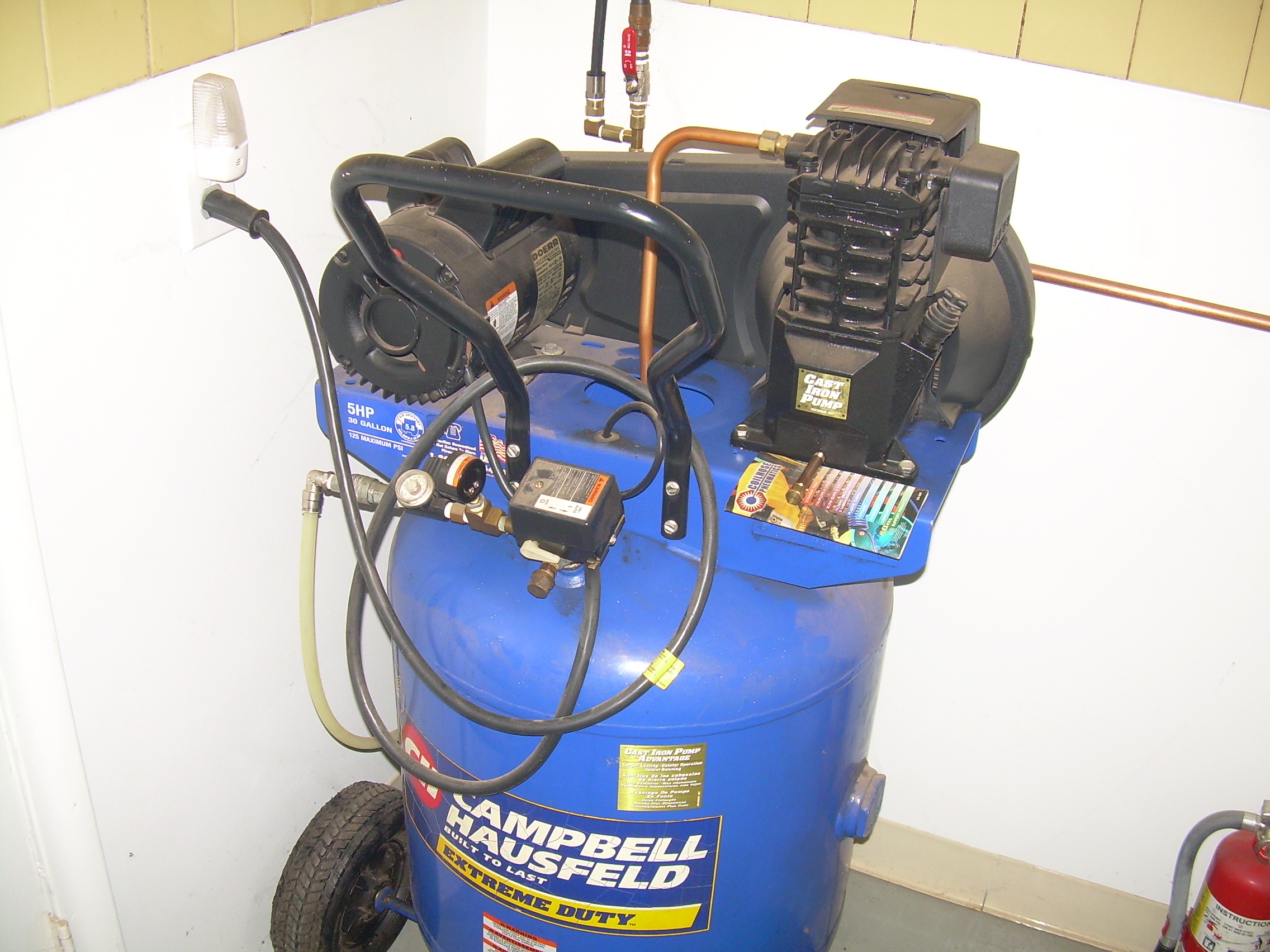

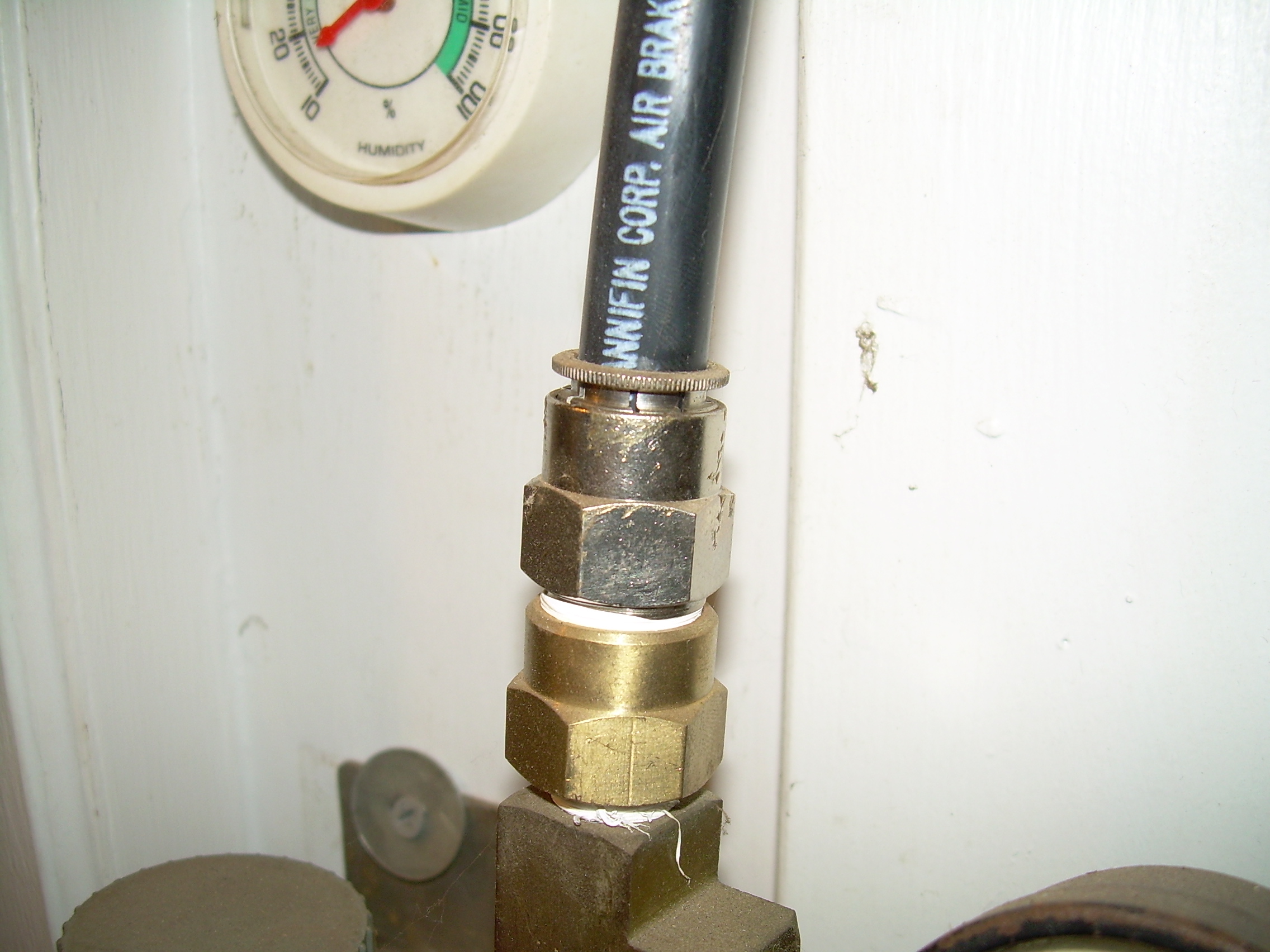

If your looking to use a flexible air tubing to plumb your shop why not use air brake hose. Get a spool of Synflex DOT rated truck air brake hose and plumb away. It is rated for air, is UV resistant and safe in cold temps. It's what I plumbed the air system on my mobile service truck with.
When I first read this I didn't think it was a good idea for a shop application, but when I looked closely at mine that's what it is.
I have 2 types of flex line one is black and one is white/clear, this is what it says on the black line; "Parker Hannifin corp. Air Brake PFT-8B SAE J844 type 3B 1/2OD A DOT" it has those fittings that are reusable and just slip on with a locking collar, do they use those type of fittings on trucks?
The white one has no writing on it, I guess there are many manufacturers making a similar product.
