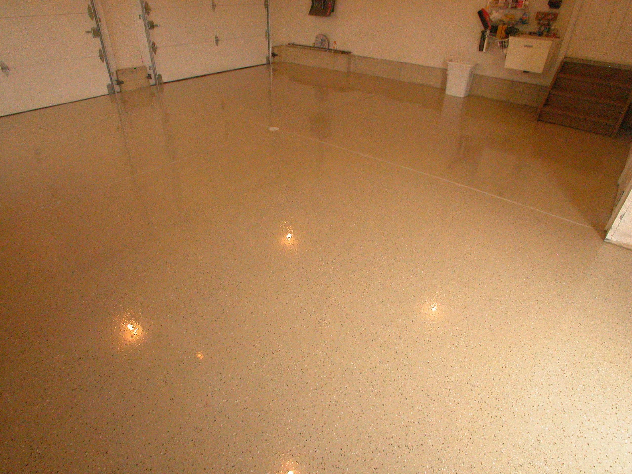

I have done several of these, and have a close friend who does it now almost daily.
If your going to do it, do it right.
The best way to prep concrete for paint, is to surface grind, or shot blast it. This roughs up the surface and guarantees adhesion. Anything less than this can work, but is a gamble.
I rent a concrete grinder, and remove a thin layer from the surface of the concrete. This also allows you to be able to remove some pitting, and surface imperfections. Then, completely vacuum all the dust from the surface.
Before making a choice on a product, check the technical bulletin and see what the solids content is. You want to use a 100% solids product. That means 100% of what you buy, ends up on the floor. Other products are as low as 50% solids, that means 50% of what you buy, evaporates.
Sherwin Williams does make a good 100% solids product, Armour Seal. But it is labeled for professional applicators, and has a very bad odor.
I prefer: Epoxy Coat, Epoxy Paint For Garage Floors Epoxy-Coat.com They can sell you a kit with everything you need to apply it. And, they sell it in smaller amounts, so if you need more, or want to make samples, you do not have to buy a full gallon of epoxy, and a gallon of hardener. (Most other products only come in gallons). Epoxy Coat is available in just about any color, is low odor, and is as close to bullet proof as you can get.
Note: Epoxy floors can be extremely dangerous when wet, without the proper amount of anti-slip sand, and color chips, (which also helps with stopping slippage), applied to the wet paint.
Make sure you plan this out, watch videos, (Epoxy Coat has several), and take the time to learn how to apply it properly. It's pretty easy, once you have done it.
Having 2 people, (one wearing spikes), helps a lot. But, I do it by myself. You can get the spiked sandals from Epoxy coat or, Lawn Aerator Sandals By Miles Kimball. With the spikes, you can walk right into the wet paint to distribute the sand and optional paint chips.
This image is my garage with Epoxy Coat on it. It's completely cured, and ready for traffic. There was no clear coat used on this floor.

There's some good advice from Ray66v but I'll differ on a couple points. With the Sherwin Williams I did, the anti skid was built into it and the product and the surface is still smooth but not at all slippery. I mop my floor and any added sand or other physical marks would be a dirt trap and tear up my mop unnecessarily. Soaking wet my floor is zero percent slippery.
As well, grinding concrete is indeed the textbook answer for a commercial application but I have found that reasonably new concrete that is properly cleaned and then muriatic acid etched and rinsed has worked 100% for me. On a commercial job I might still grind but my barn came out fine and I had to clean some serious oil spots.
After we etched the concrete, we wet it a little more and then used an old shop vac to take up the mess. Then we rinsed the floor and used a squeegee to move the water out. Actually night have used vacumn on some of that as well--i forget. Then we rinsed again and let thouroughly dry on low humidity days. No probs, not even remoely.
