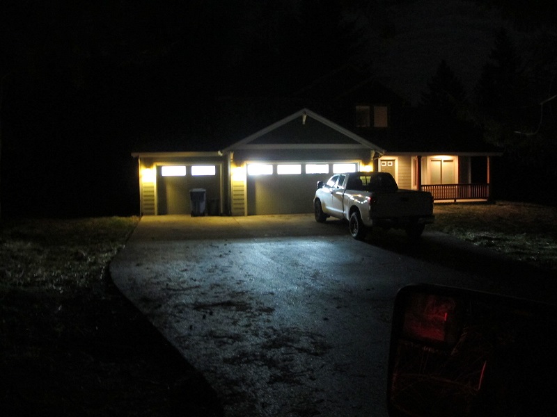

I added 2 more of these shop lights this weekend, if it was any brighter I'd need sun glasses. Look at the front porch flood lights, now look at the garage lights, they blast clear out into the yard. Lithonia Lighting Industrial 6 Light High Bay Hanging Fixture IB 632 MVH at Home Depot with Phillips Daylight Deluxe T8 bulbs.
Cops are going to think your growing pot.
