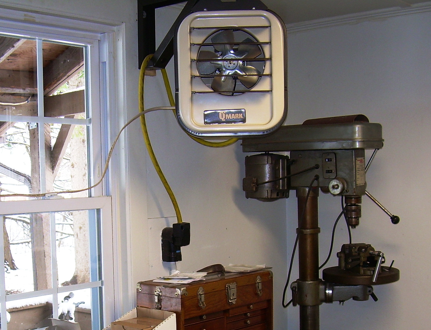

I have one of these. I see it's more expensive than I remembered, or maybe the price is up from two years ago. $350
Dayton G73 5000 Watt Electric Garage Heater
5000 watts, 230V 17,100 BTU
If you were paying .15/KW it will cost about $0.75 per hour to run it on max. Since the heat element likely isn't on all the time, it would be a bit less than that.
I can't really tell you how well it works. I have mine incase I need to be in the detached garage to fix something when it is real cold outside. So far, that hasn't happened. :D
I have tested it and it gives off very nicely warmed air.
Dave.
Granted my garage is not insulated but 17k BTU is not enough to make much difference to me. I had a 20k BTU heater and you had to be within 1 foot of it to notice much. I would buy at least a 40k BTU heater. I would rather turn it down or off then not be warm enough. We have a unit at work that is similar in a common area that is concrete and brick and very drafty. I cannot tell when it is running, it seems to make no difference at all.
I should explain my set-up. My garage is 28x48 with 10' ceiling. The overhead door on the east end is 16' wide by 9' high. It is well insulated and has earth berm on the most of west and all the north sides for the lower 8' of wall. Across the south side are eight 46"x76" double pane clear glass windows.
Our low this morning was -4* and now it is 14* with a light NW wind and clear skies all day. Inside the garage right now it is 59*, with no heat other than sunshine.
As long as we get reasonable sunshine, I don't really need a heater. If the tractor broke and we had 2-3 days of cloudy, cold weather, I would probably turn the heater on for comfort while working on it. Passive solar buildings work pretty well in my area.
The OP said his garage is well insulated and normal sized, he may not need a lot of heat. I agree 17K btu isn't near enough for an uninsulated building. But, better to have some extra capacity than to be almost warm :)
