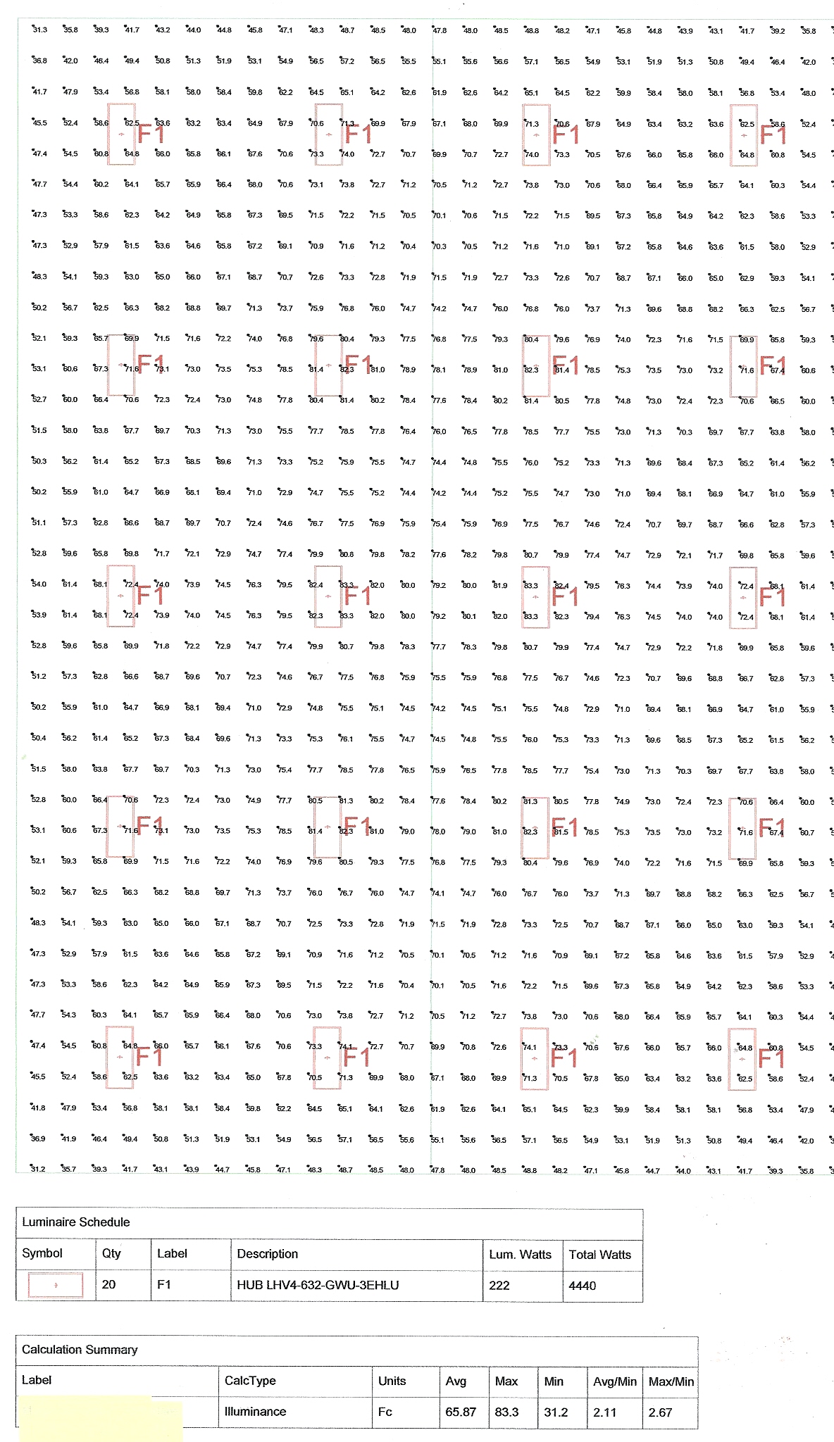

I'm not having any lighting problems in my unheated tin shed, but I do have a finished ceiling with plenty of blown-in insulation. I had a lighting engineer evaluate my lighting needs and he came up with this plan. It uses T8 bulbs, 6 to a fixture with 15' ceiling height. The lumens average 65 at the floor in my empty building. This is a printout of his work. The red rectangles are the light fixtures.
