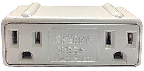

I should say that I already have all those adapters. I would just need to source the cube (Lowes, HD, Ace, etc have it).

Heat tape, turns on at around 35 degrees i believe.

If I may recommend a hot water recirculator. Generally used to maintain near-instant hot water at fixtures at the end of a long run from the hot water tank. So that the cold water in the line isn't wasted while waiting for the hot water to arrive. In your case, it would simply take hot water from the hot line cross it over to the cold line (when not in use) and flow back to a T in the cold supply on the heater. The pump could be connected to a Thermo-Cube (described above) to maintain the closed flow of heated water during times of potential freeze. It would also cost MUCH less to run than an electric heating element. https://www.amazon.com/Watts-500800-Instant-Recirculating-Install/dp/B000E78XHG

I'm leaning towards installing a thermostat switch at 35F or possibly getting an electronic controller to do the same. The cubes would work, but I'd have to do some ugly adapter work. The tstat switch is inside the cube anyway, so it just make implementing easier.
   / Shop sink anti-freeze heater #18
I store my tractor in an unheated shop that has a sink inside some repurposed kitchen cabinets. There is a small hot water tank next to the sink and the cold water supply line also feeds a hose bib right behind the sink on the outside. The shop has insulation in the wall, but I've had the bib rupture in the past.
There is a light bulb under the sink that I turn on in winter. With the bulb on, there really shouldn't be an issue with freezing. However, incandescant bulbs are necoming harder to find and, more importantly, the bulb has burned out 2x this year (don't know why).
What do others use to keep things from freezing? I can't use pipe heat tape as the lines are mostly PEX. Also, that doesn't help the sink drain line. I picked up a fish tank heater today, but I'm not convinced this is the right unit or approach.
This: 71MkYrwZcgL._SL1500_.jpg
Plus this:
https://www.amazon.com/Farm-Innovat...id=1544232204&sr=8-3&keywords=plug+thermostat
Plus this:
https://www.amazon.com/Lasko-100-My...coding=UTF8&psc=1&refRID=69S2JD2MDPG0PTGXTQ33
Neat and tidy.
