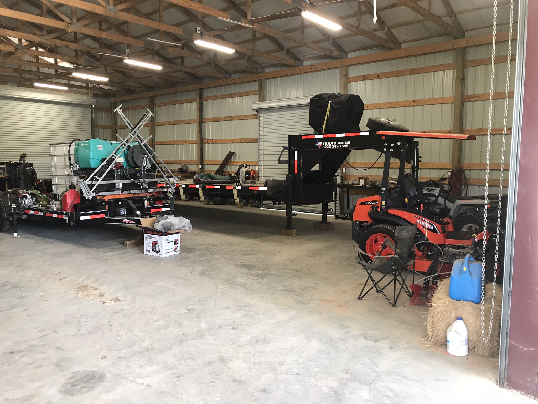

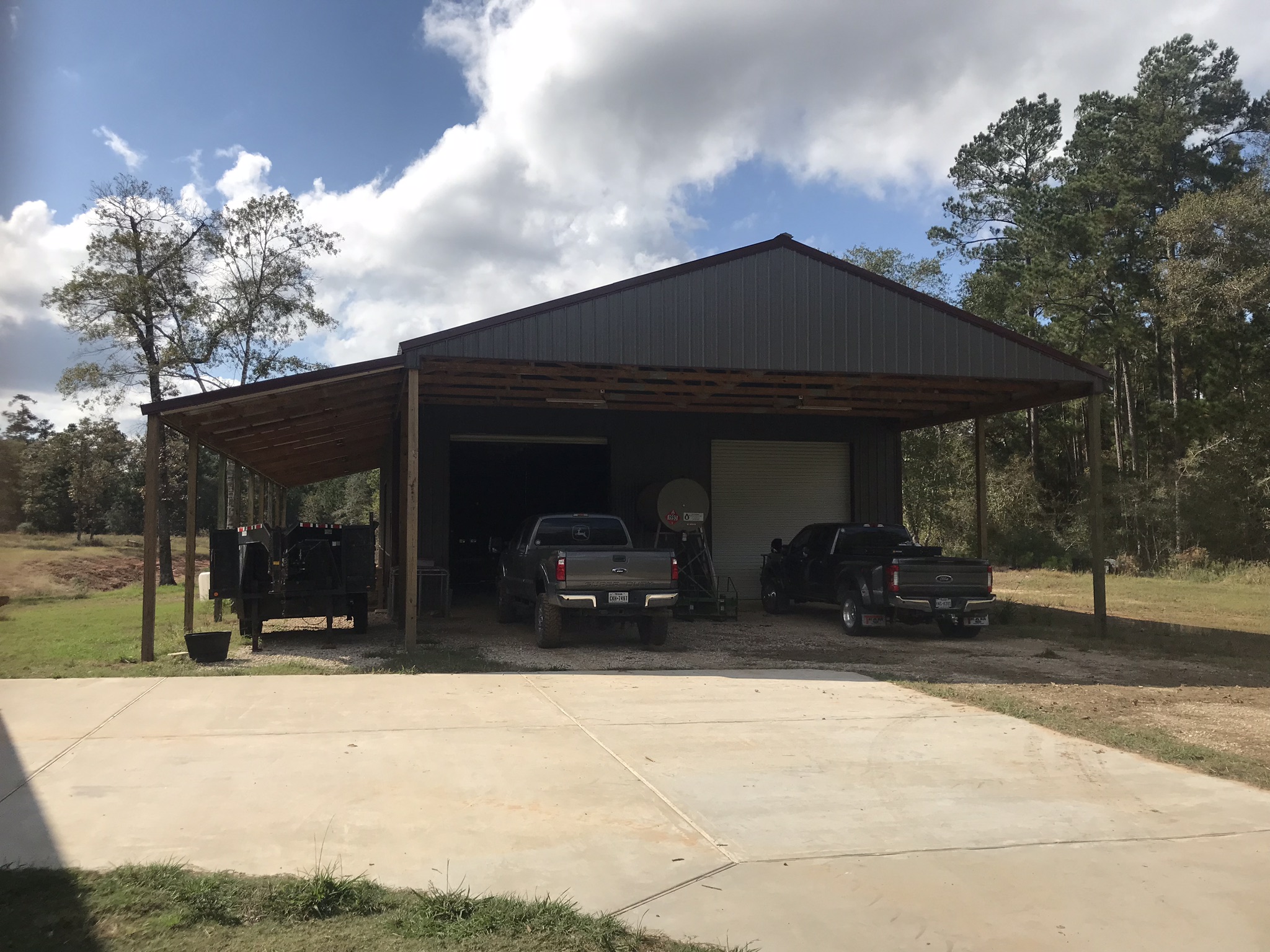

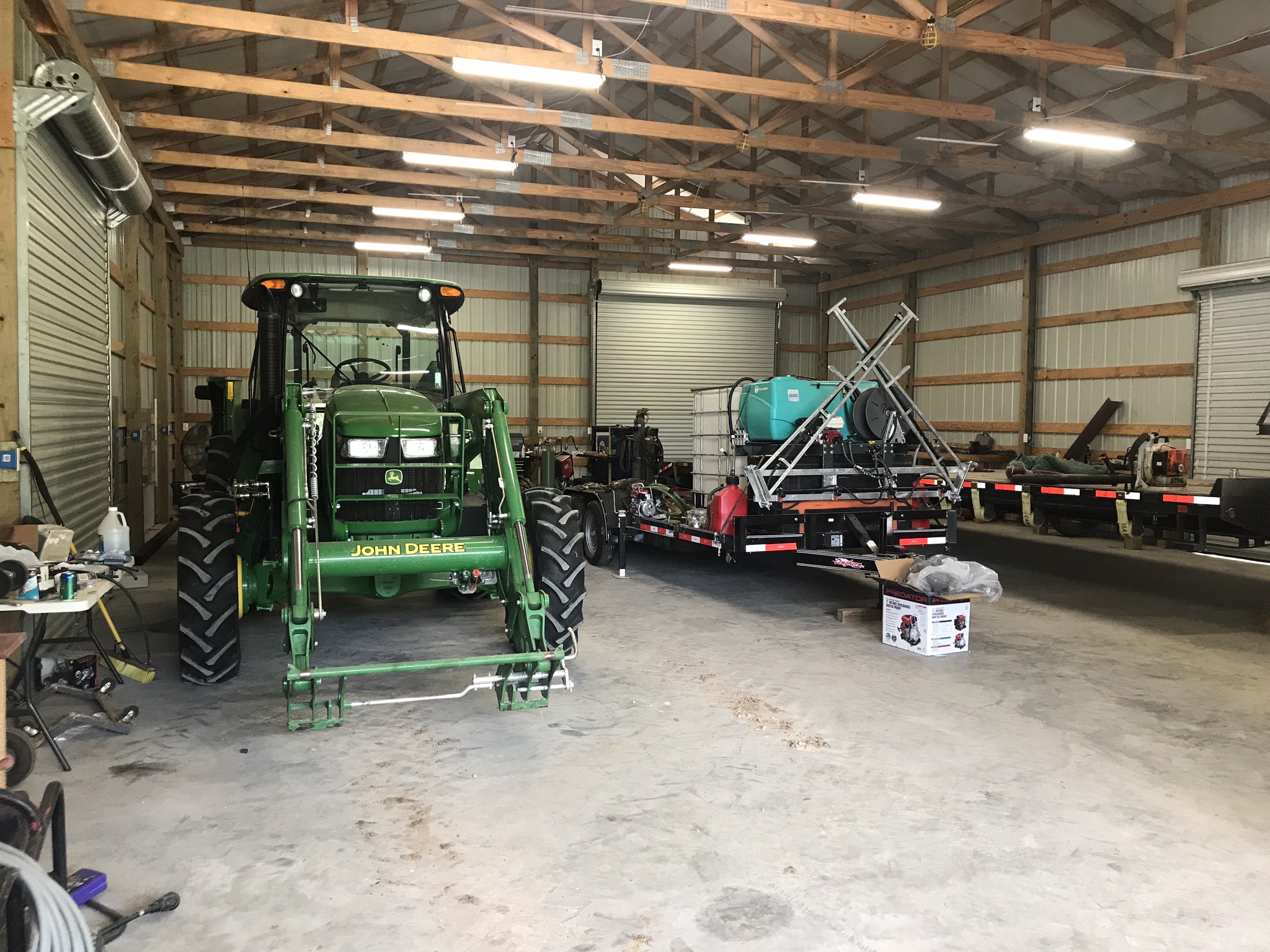

Mine is 40x60x15. Total under roof with lean-to and awning extension is 52x84. It gets full quick but I keep nearly everything tractor related in it. Used to keep the box blade and bucket or forks but the they are outside now. It痴 nice keeping everything out of the sun.

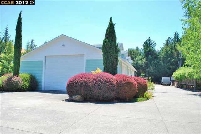

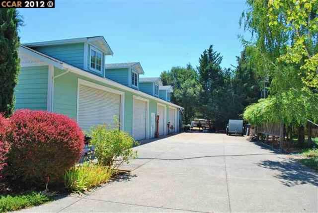

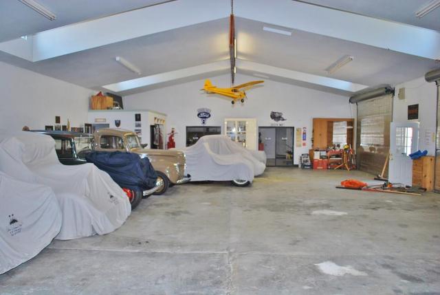

My perfect shop is 40x96 with multiple roll-up doors... too bad it is not mine.
Picture 40x72 for equipment and a 40x24 for metal working and repair area... the large gable end door allows for a center isle which can be a real time saver in that any piece of equipment should be easy to get out with minimal effort and 40 wide is about the minimum to do this right.
