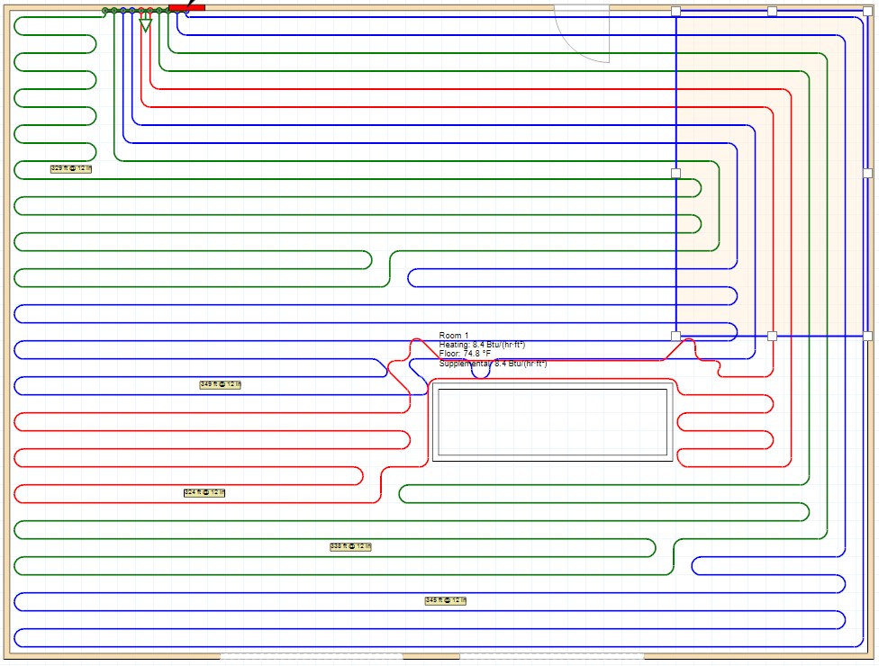

I think I'm going to do the run to the metal yard next Saturday... The attached is my first go at a layout for the PEX, roll up doors at bottom, man door middlish of top, blue box on top right is office area which will be loft over it, the blocked off section is the lift area and manifold area top left will be near where I think a wood stove should go...

Those look like the drawings the guys that designed my system gave me. Maybe I'm simple but I laid it all out, one "loop" at a time and used marking paint at direction changes and a few mid points. I don't know if you plan on the 6x6 wire mesh, but if you put it down neatly and squarely it's a great "guide" and eliminates most of the measuring. Another helpful item is a un- spooler or un- coiler. The tube is just like a rope,cable or hose, it needs to be un rolled so that it lays flat and 90* corners add up to trouble without one. I found that I needed to secure the tube fully at the corners or bends, then I'd go back and secure the straight long runs. I used zip ties and fastened to the wire mesh.
In simple not so long winded terms,
You can't just lay your loop out on the floor, it will need to be fastened and making adjustments because something got "off" means completely redoing what's done to correct things. :thumbsup:

Sounds simple enough, I hadn't thought far enough ahead about unspooling, thanks for that. I'm just doing rebar on a 2' mesh so not quite as nice but I'll try to make it work
