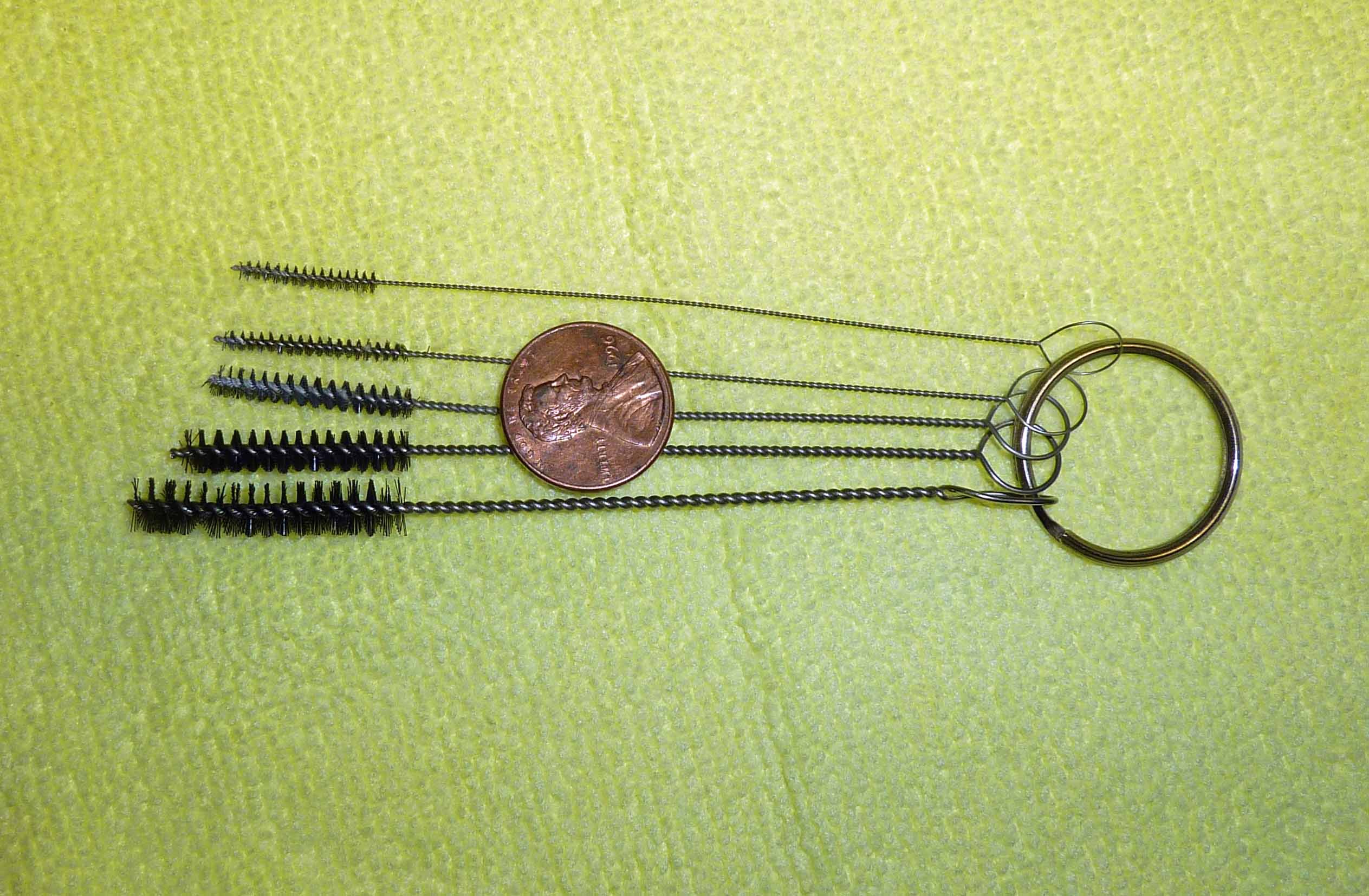

These mini brushes from Harbor Freight are pretty good for small orifices.
- Harbor Freight Tools - Quality Tools at the Lowest Prices
Mini brushes specialized for cleaning the smallest areas, including tubing, spray guns, air caps, air passages, and fluid nozzles.
Brush sizes: 12mm, 20mm, 23mm, 25mm and 30mm; Length: 4"
Smallest is 12 MM (about 1/2 inch) I wonder what kind of a spray gun they clean with that. :confused:

It would seem that Harbor freight got the numbers wrong in the description.
That is the set I bought, here is a pic.

Ken glad you caught that.Sounds like i could clean my chimney with the big ones lol
