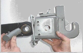

It would be the same since we're measuring Center to Center.
Going from Category one to a Category 2 would only require opening the attach hole ¼ (1/8th per side). As far as the measurement...take a look at the attached picture. Using your hand, you can estimate the distance from the center of the pin hole to the center of the implement lug. Just use the pin hole (7/8th's) or the hand as a size reference. You won't get the distance to the nearest .001", but you'll do pretty good
Note that the width of the slot of the implement lug is considerably wider the the hole diameter. The basic weldment (I was mistaken on calling this forging in my first post) is quite robust and is probably used for both categories.
But, call Pat's if you'd like...let us know what you find out.

The cat #1 extend about 3-1/2" and cat #2 about 4". The receivers and hooks on the cat #2's are bigger. Same design, just larger. Hope this answers everybodys questions. Thank you all for your continued support.
