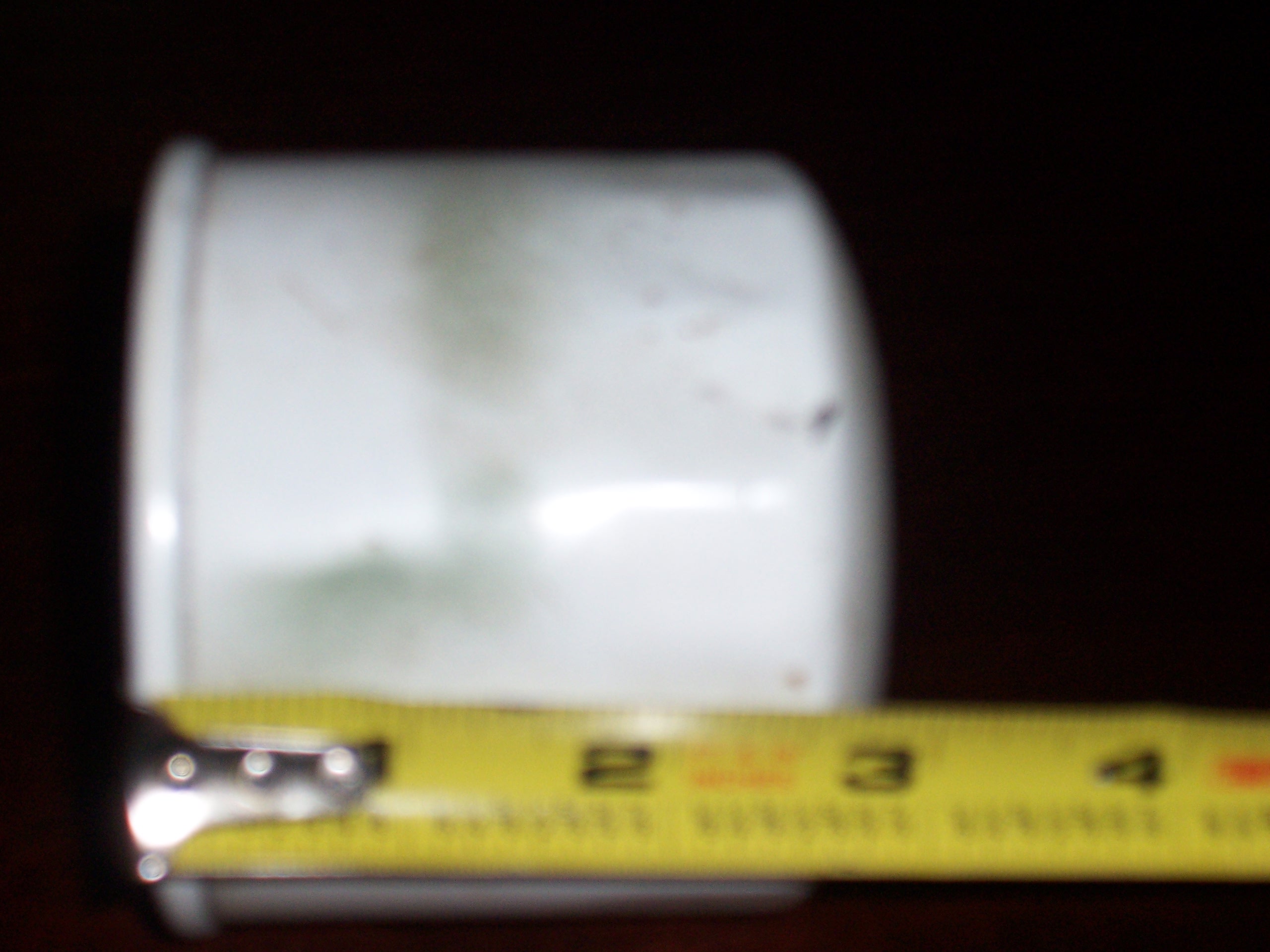

Bah. Stranger and stranger. The guy I bought this YM186D from said he had just put on a Hoye oil filter. He included an unopened new one.
Today I discovered the generic white filter on the tractor is an inch longer than any common filter for this model. Likely its a Wix 1568 (4.072") mentioned by Winston. No wonder the power steering cylinder bumps it.
Meanwhile the Hoye filter that the seller included is just under 3 1/4". I'm pretty sure its a 1334 (3.194"). When I put this correct filter on, the interference problem will go away. Thanks everyone for the good advice and please excuse me for starting a snipe hunt.

Having worked in the Graphic's Printing Ind. for over 30 Yrs. As a Multi color sheetfed Pressman I've printed a few 100.000 books.:D with most of the equipment in the shop made in Germany you learn not to through anything away that still may be needed. Rained in so just ran to the shed and found a old Orig. Filter that was still in my Parts box. for the 2000. So I'm sure it came from fredricks most likely. White with Grn. overspray.
B52779C Made in Thailand. 3"

Carey - if that YM2000 oil filter is from Fredricks its probably part # 1334 in their catalog. I assume that's a standard Wix etc 1334 (Honda, Nissan, Subaru) filter.
   / Shortest oil filter for Yanmar? #15
OF-1334 Oil filter, spin-on – 3.19” tall F20, F175, 135,
155, 195, 240, 1300, 1301, 1400, 1500, F18
Repl. 119660-35150, 129150-35150 &
129150-35151
FWIW here's what they show now. Mine is closer to 2.7/8" It's over 7yrs. old and Spalding may have put it on. It was Bought ASIS. so who knows were the overspray came from? I kept it because I switched to a Fram Steve gave me the # for. You had to take the Side cover OFF to get to the old filter. I have a pair of Filter Pliers and it was still hard to get to.
