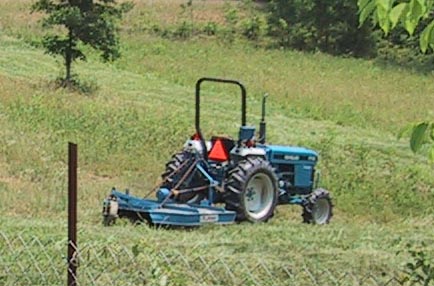

If you want to see a chain on a brush hog here is a picture of mine.
