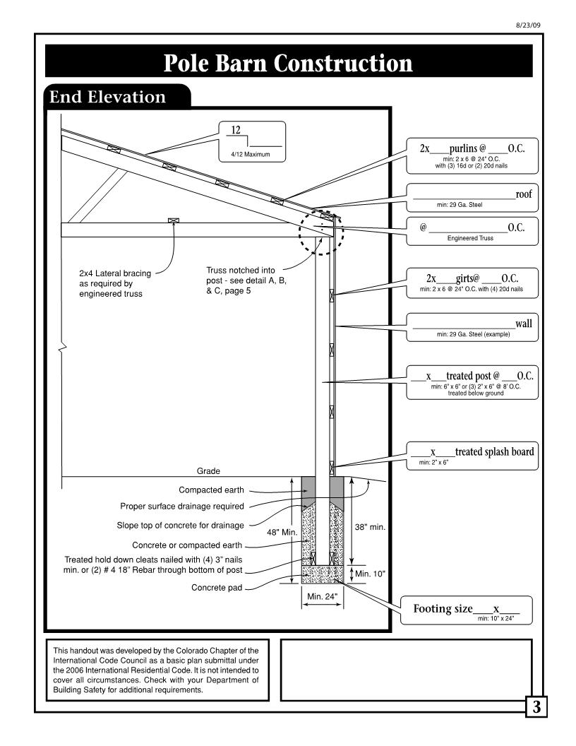

The State of Colorado wants at minimum a 24" concrete pad. Does not matter what the guys here put under their post. You must follow the local code and put what your local building official wants under the posts.

Yes, it's good guidance, that's what I would do whether it's code or not. There is nothing more important or difficult to fix later than the foundation of a building.

A concrete pad under the posts is a given. Without the pads under the posts the poles will sink. That's code around here and truly just plain common sense.
It's pretty ingnorant on their part to say that a 24" cookie is needed.
Big difference between a 24' building on 8 foot center vs. a 80' or more on a 10 or 12 foot center.
