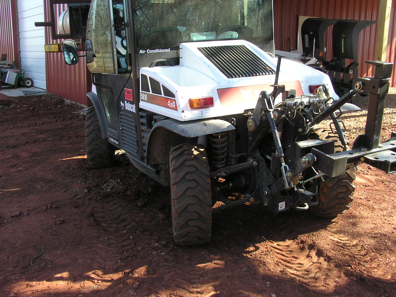

Here is something that you can't do with a tractor, but the Toolcat can do crab steering.
If you are in the slick stuff and slide close to a fence or a building, use 4 wheel steer to set the needed angle for the rear wheels, switch to two wheel steer to set the same angle for the front wheels, then drive away like a crab moves.
I use it to get close also.

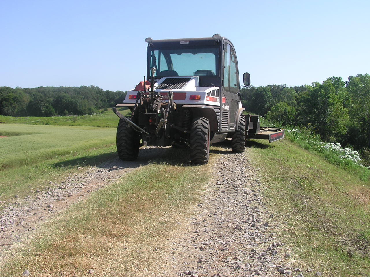

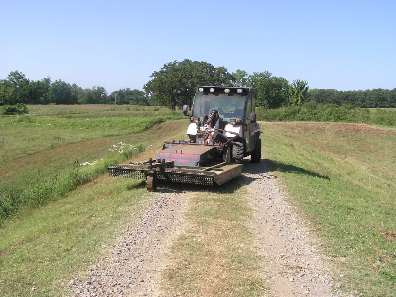

Or to offset the brush hog.
