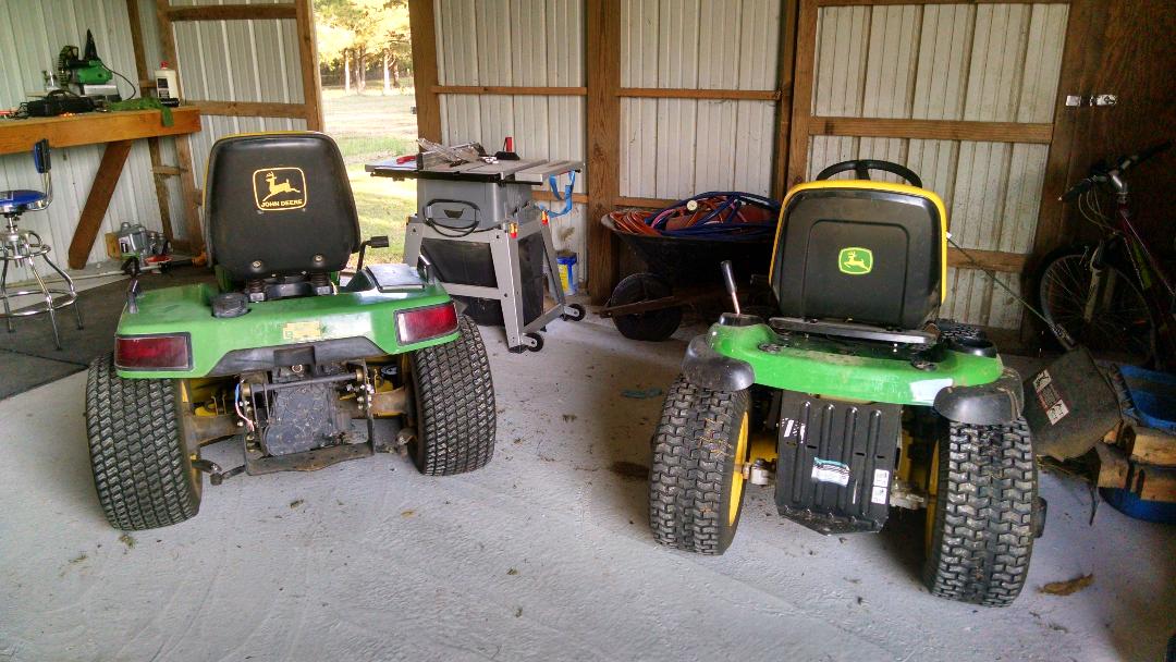

   / Should I buy this 425? #18
Wow, that tractor looks great.
Is that a horse hitching post in front of the barn?
Also, what are you using on the floor with the pictures of the tractor inside?
Richard

#20
Richard
Yes, it's a hitching post. Previous owners had horses as well as stalls in the barn. I removed all the stalls and poured concrete. Nothing on the floor. I need to put down a sealant but it's way down on my project list.
