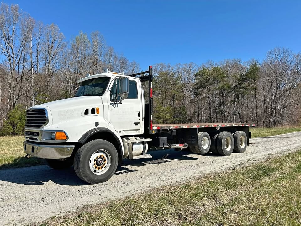

I’ve been eyeing this one, but its a lot more spendy. ($36,000)
Mercedes 450/1700. Allison 4000. Air to rear, pintle hitch for pup.
311K mi. Full locking tandems

Learned a lot about tandems in the past few months. Generally, there’s 2 types.
There’s standard duty tandems, typically with a 7L to 9L engine 275-330HP and an Allison 3000 series. Usually a 12-14K front and 40K rears.
The standard duty tandems with have tandem axle interlock and usually an exhaust brake. Maybe locking diffs.
Then there’s heavy duty tandems with a 10L to 15L engine 300-500HP and an Allison 4000 series. Usually a 16-10K front and 44K rears.
The heavy duty tandems will generally come with locking rears, air to rear, jake brake and a pintle hitch.
I’m leaning toward a HD tandem. Mostly because if I’m buying a high mileage truck, I’d rather it be heavy-built. Also, I have pretty much put locking diffs on my list as a must have.
Exhaust brakes are helpful up to a single axle, pretty much useless on anything heavier IMO.
Get the jake brake.

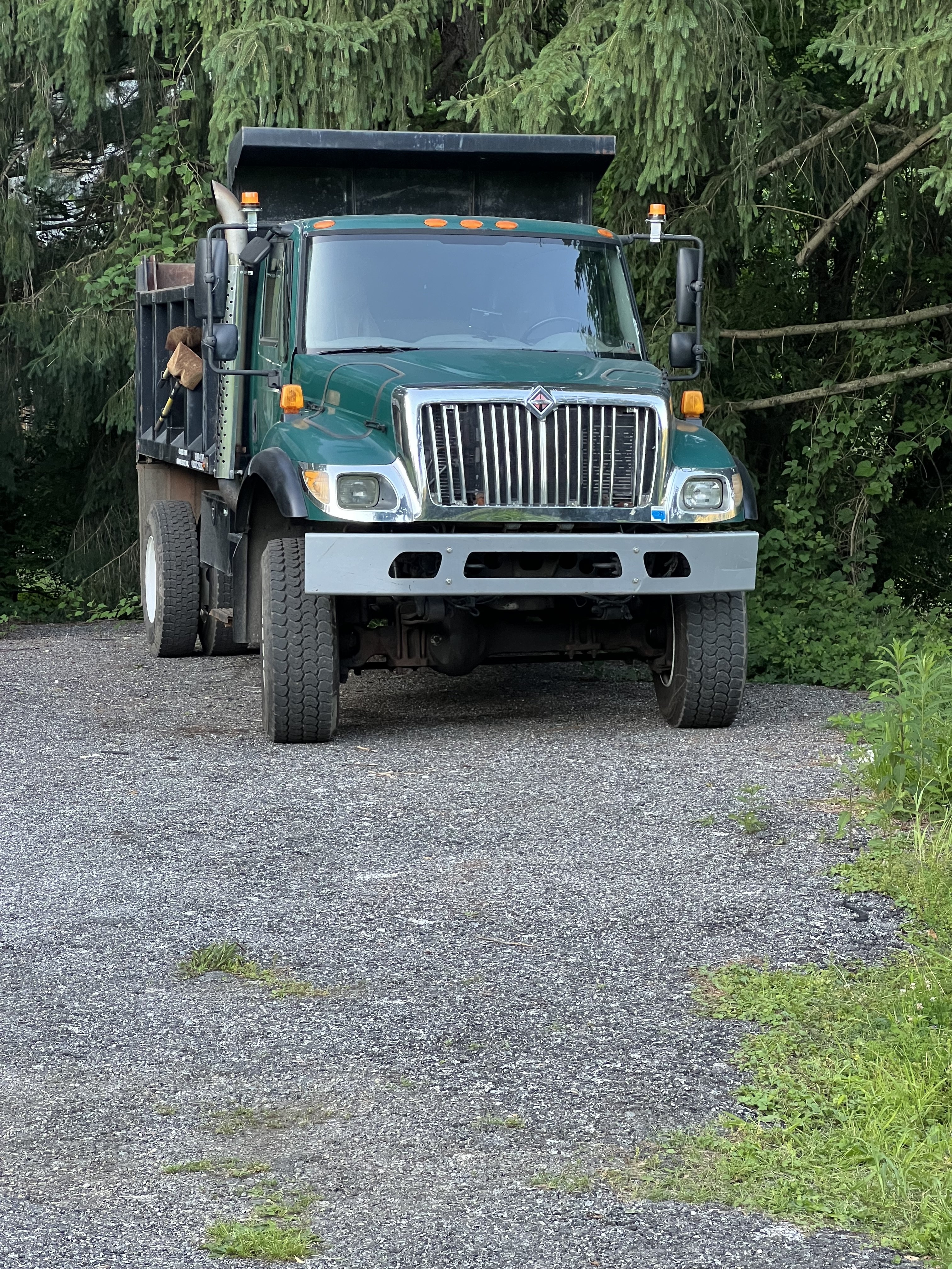

I actually started off a few years back looking for a 6x6 to avoid the problem of locked 6x4 rear axles pushing you straight forward.
When I lock the rear in my IH7500, it’s steering diminishes to straightline pushing a lot, too. Lockes 6x4 would be worse for sure.
