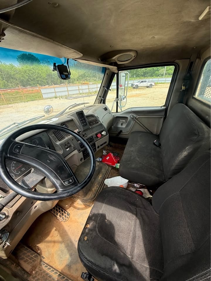

The issue with buying ANY used truck or tractor is how the previous owner maintained it and if they actually took care of it or not. With no maintenance records, I presume there aren't any, you are buying a 'pig in a poke', with the potential of major repairs looming. It might come out smelling like a rose but it may come out smelling like a turd.
From the overall looks of it, I'm leaning towards the turd end. 20 grand isn't a lot but you could very well have 20 grand in repairs as well. JMO.
