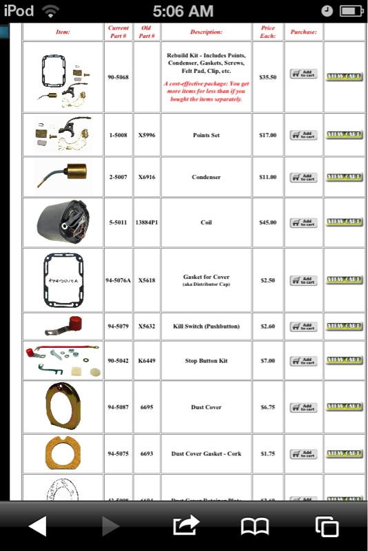

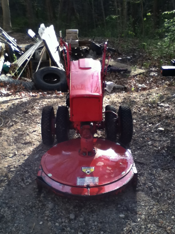

Ok hey guys just got back and picketed up the gravely today! So I pressure washed it Ann's it looks great. So the next things is the Magnito to get it off I had to take the duals of and then the bolt twists forever why? Also how do I do the timing correctly also I found the vin and it's a 1974 model so thanks
   / Should i buy?
#20
and how could I forget
