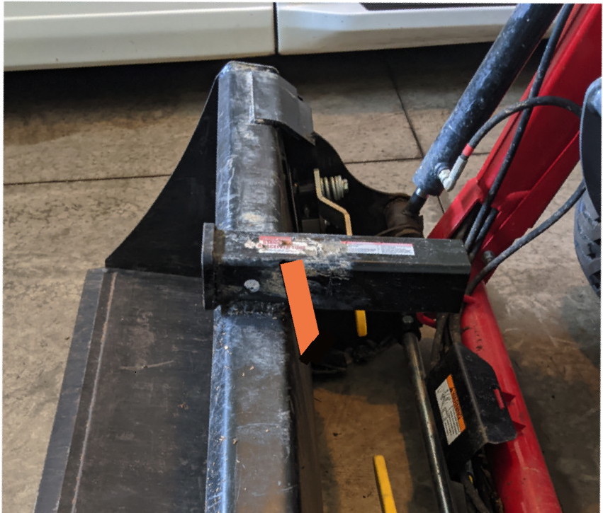

Should I hack the back end of this sucker off, or no?
   / Should I hack the back end of this sucker off, or no?
#21
Cool, good enough reason to keep it on the loader then, I guess just the back end of it will come off.
Yeh, thanks everybody, for the feedback.
#22
I woulds weld a reinforcement strap around the corner of the bucket top, then cut off the tube behind the strap.
Bruce
That's a good idea, thanks! Actually, I saw pic, somebody else did that too.

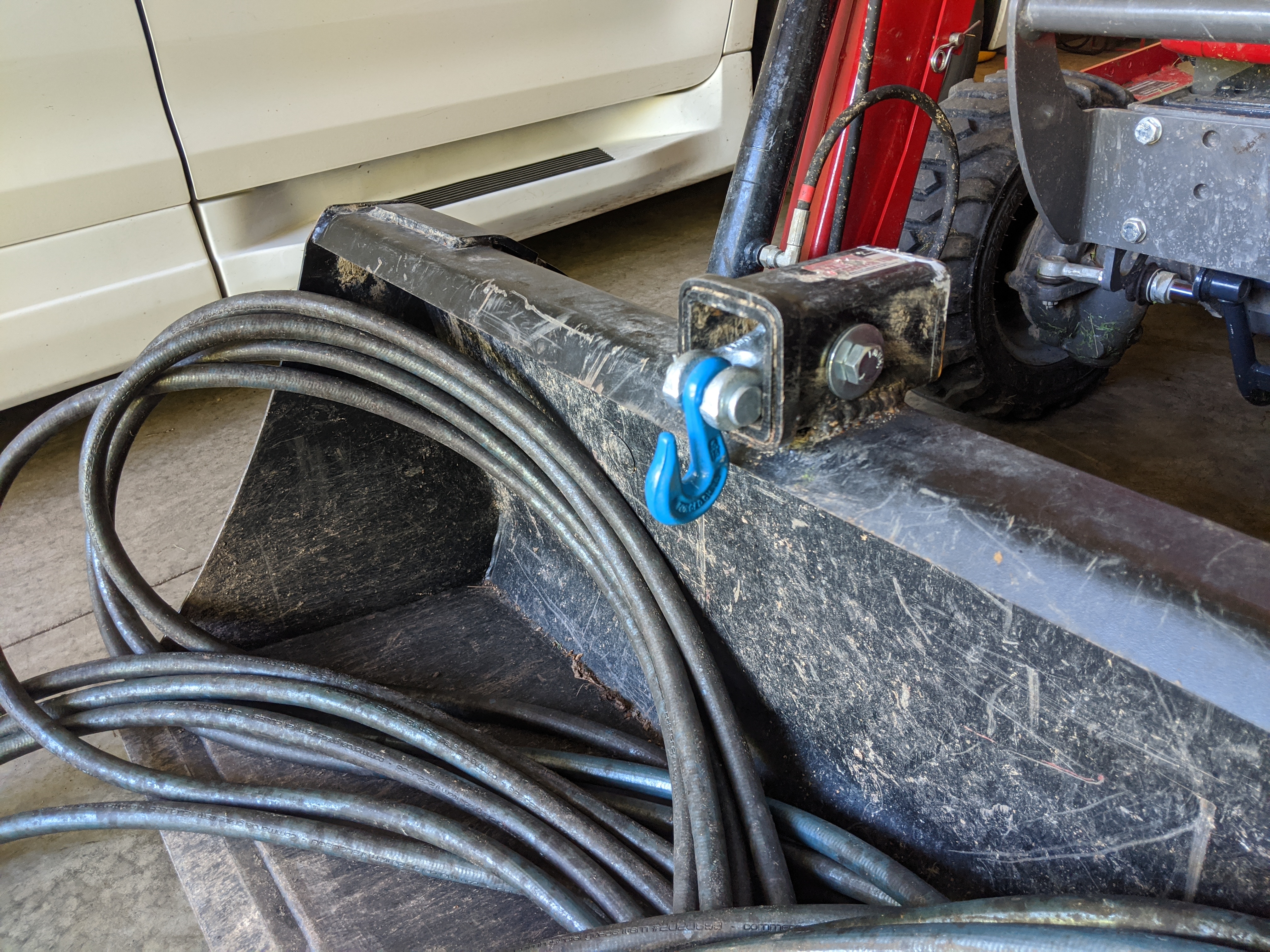

Along those lines, I was thinking about hooks, sorry totally different subject but you maybe have some thoughts on it. Should I be reinforcing the top of the bucket if I'm putting on hooks? It's just a scut, I can't imagine being able to even lift anything heavy enough that would damage the bucket as is, but I dunno.
   / Should I hack the back end of this sucker off, or no? #23
Why weld on hooks? Use your 2" receiver.
   / Should I hack the back end of this sucker off, or no? #24
If you are going to leave it on, please put a decent weld on it. That one looks really bad.

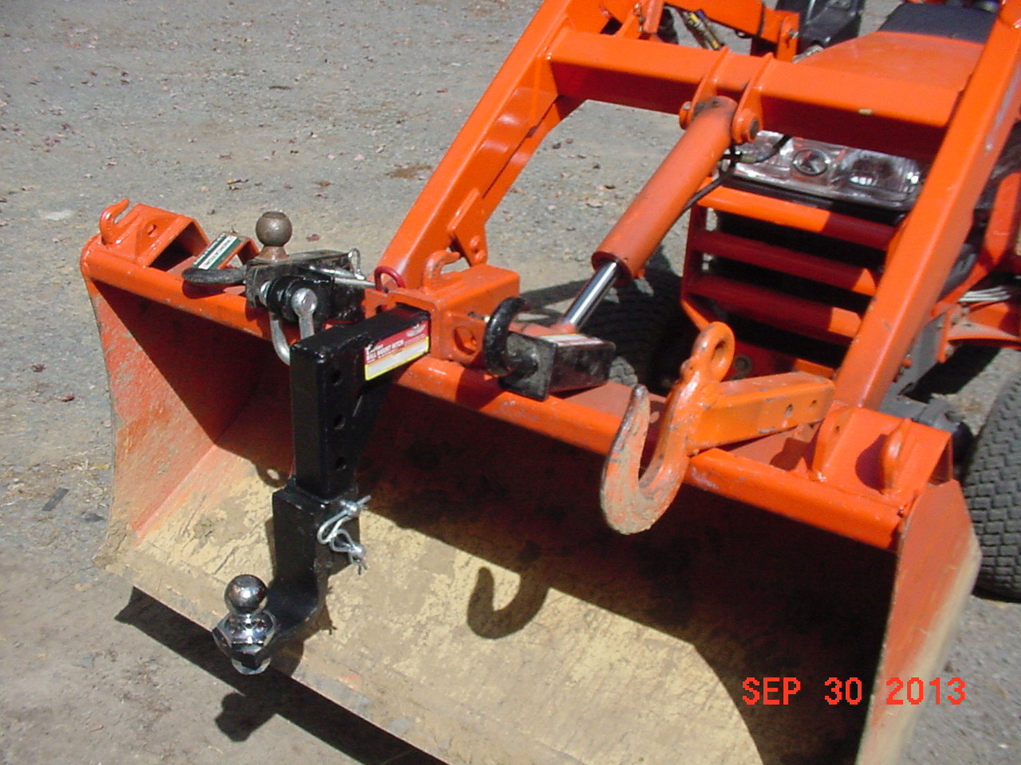

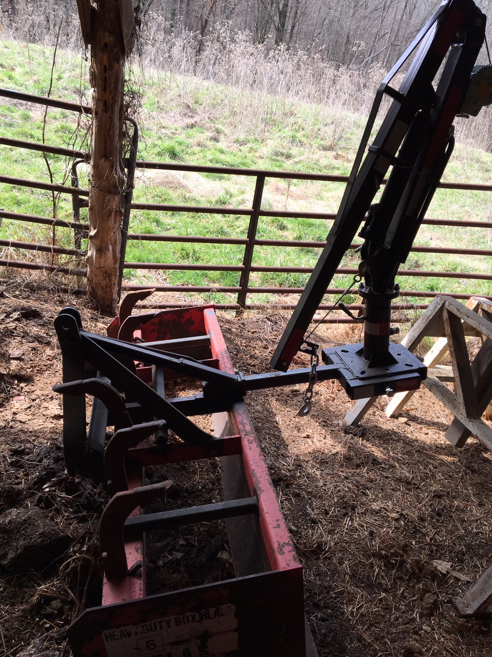

   / Should I hack the back end of this sucker off, or no? #26
Or try this.
That is what I have, and bolted on.
It is basically worthless, because the ball is too low to be seen when approaching the coupler.
For trailer positioning I now have a ball attachment that slips over one fork instead.
Much more convenient using forks with a ball, instead of bucket with the ball out of vision.
   / Should I hack the back end of this sucker off, or no? #27
I wouldn’t shorten it. Just cut the welds off. Much neater..
   / Should I hack the back end of this sucker off, or no? #28
Maybe shorten it up a bit, but I would keep it... IT may be useful...

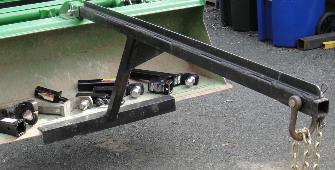

If you've never moved a trailer by pushing it ... It's much easier than moving it behind you. I used to tow aircraft for a living. All sizes, from little 2 seaters to 727's. We always faced the load. So much nicer.
Here's what I put on the smaller Yanmar. It's ideal for parking the little utility trailer in its tight barn stall. Looking forward is more precise than backing!
This is low enough to go under the parked trailer. And it's convenient, remaining attached. A version on a crossbar could be created for heavier trailers.
Or, a different basis for a project: HF sells a couple of short receivers (for adding to a utility bumper) and a $12 light one for ATV's.
