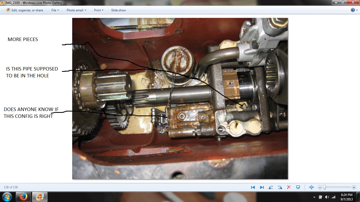

I took this MS 135 apart today to see why the lift wasn't working.
This is what I found.
I'm not really comfortable as to how the linkages work, (I removed the 2 bolts "from the left/pto control, holding some aluminum thing, soas to not damage anything).
I'm wondering about the pipe that is not seated in the hole. WHY?
And of course all the broken parts.
Could I run it this way?
Thanks,
Gary

I had a MF65- I think the metal and bronze parts are from your hydraulic pump. There is a metal pipe that runs from the bottom up the the cover for draft control. I would image with loose parts cleaned out that your PTO would work but no 3 pt function.

You are right hasmat. The pump broke apart. Thanks!
So I found a new one on ebay for 350. (I guess not too too bad). Should work as new when done.
Been reading about pump putting out too much pressure. I just hope I can figure out things so it won't break again.
Thanks everyone for your thoughts.
The only thing I can't figure out is where the spring came from?

Now I have another question (besides where the spring came from?). I took the dashpot off by unbolting the (2) 1/4" bolts. Is that an acceptable way to put it back together?
Seems I read where ya might remove a "cam"?? to lift the cover off. I still don't see any type of cam.

Hey,the spring i think is from inside the draft control mechanism and if you are replacing the pump would be already installed in the draft control. Best of luck replacing the pump - it is quite easy job to do although i split my tractor to do mine so access was easier (I wouldn't do that unless you have a flat concrete workshop floor) - Al
