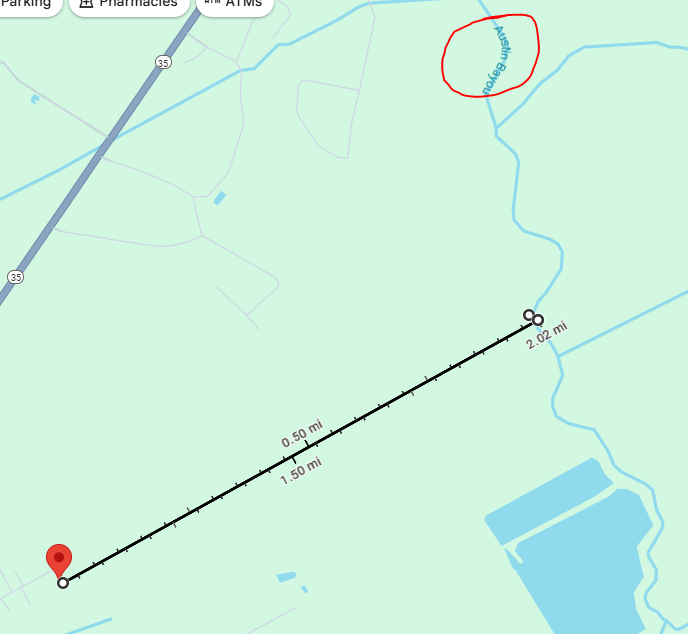

I would like to ask how far from the coast you are. The amount of corrosion around the house that you describe seems similar to what I have seen being quite close to an ocean. Are you? If so, it might explain at least some of the refrigerator and air handler damages. (Just trying to assign "blame" here; is it just the water, or is it possibly airborne salt from coastal breezes, or a combination?)
I've lived in a place with similar levels of chloride, and we did not have the air handler or faucet issues that you describe, so I do not fully understand what is going there, and as your water tested slightly alkaline, that generally helps. I wonder if the sediment that you were describing somehow makes things worse. I did live for a time on the beach and the salt in the air there was really tough on aluminum and exposed metal, but we did not have refrigerator or air handler issues as you describe, so that one is an "I don't know" from me.

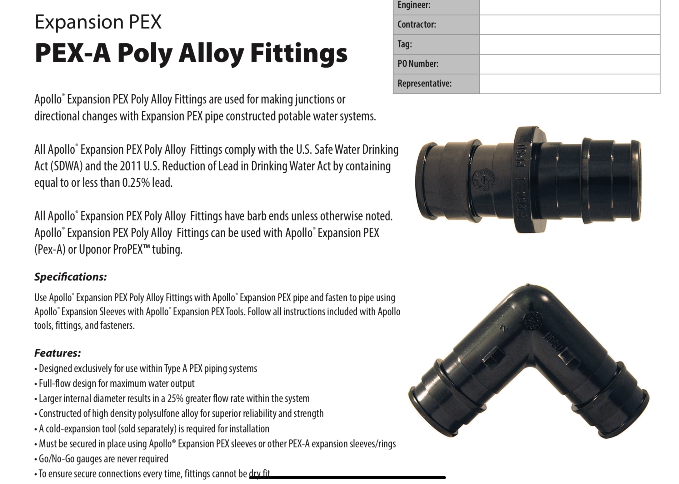

Here's an example of some non-metallic PEX-A fittings that would also work for RO water.
This seems like a bit of a project, but it also seems as if you have been putting out fires in many directions for a while now.
yes we are near the coast and I have suspected for a long time that was part of the reason for things turning to dust so fast. Even things outside the house. Our patio furniture doesn't last more than a few years before collapsing on the job. But I am not sure we actually live close enough to the ocean for coastal breezes to factor in. We are definitely close enough to bayous if that counts.
Ok thanks!

   / My well water is terrible. Should I just use pool water? #78
@strantor I think based on my very limited experience (n=2) that your location is close enough to count as close to the Gulf for getting some salt in the air, but not enough to explain the fast turnover of your evaporators.
All the best,
Peter
That is in line with my feelings on the matter too. I think it there is a combination of things going on. Some salt in the air, everywhere, and some chlorides from the well water inside the house.
I have attached a study of atmospheric corrosion which shows that, depending on how you represent the data, my area can be said to be somewhere barely affected and severely affected. And it seems that the air can be corrosive far far inland. Like as in the whole state of the Florida has a corrosive atmosphere according to some of the representations.
  • mappingatmoscorrosion.pdf
