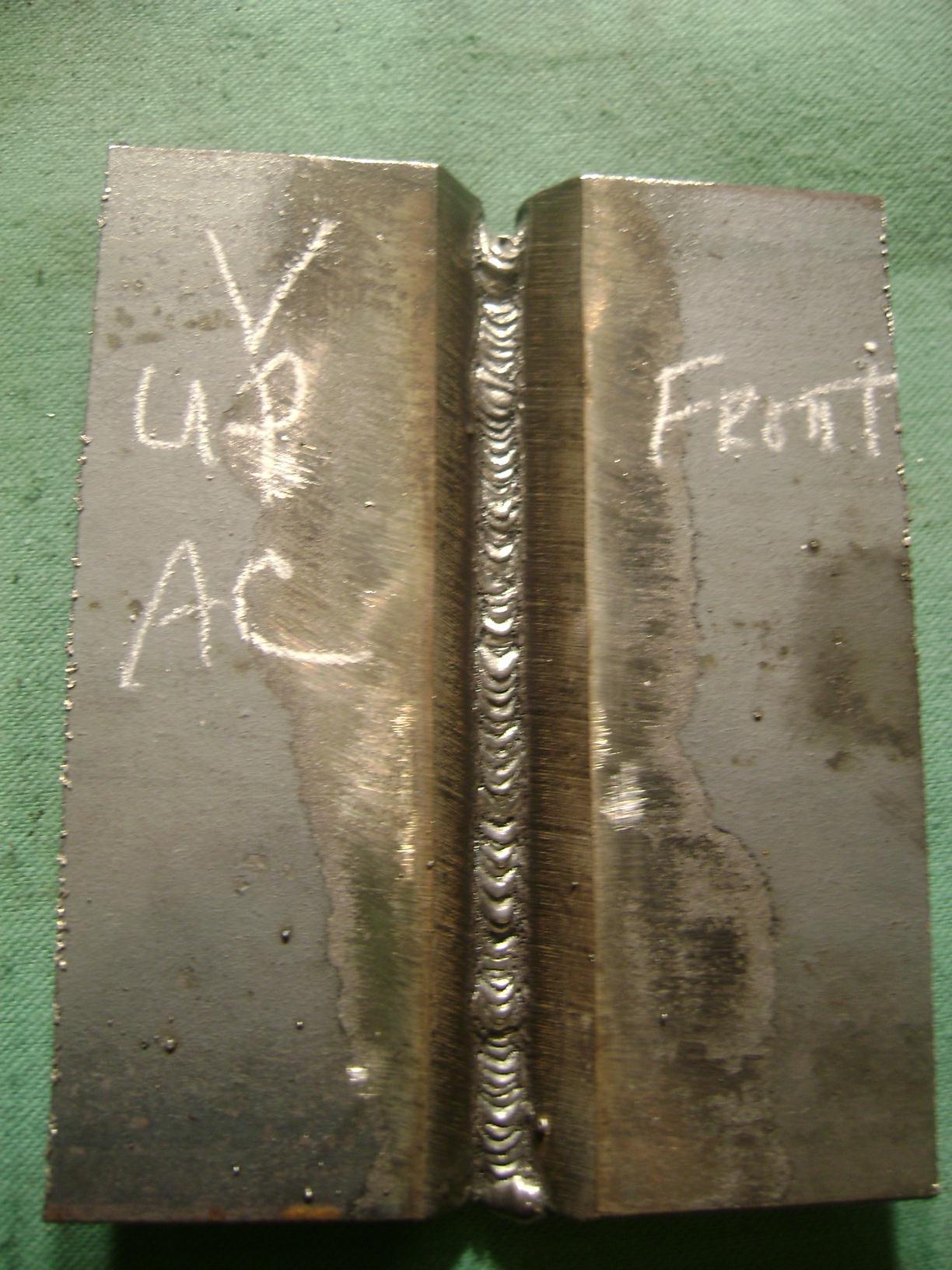

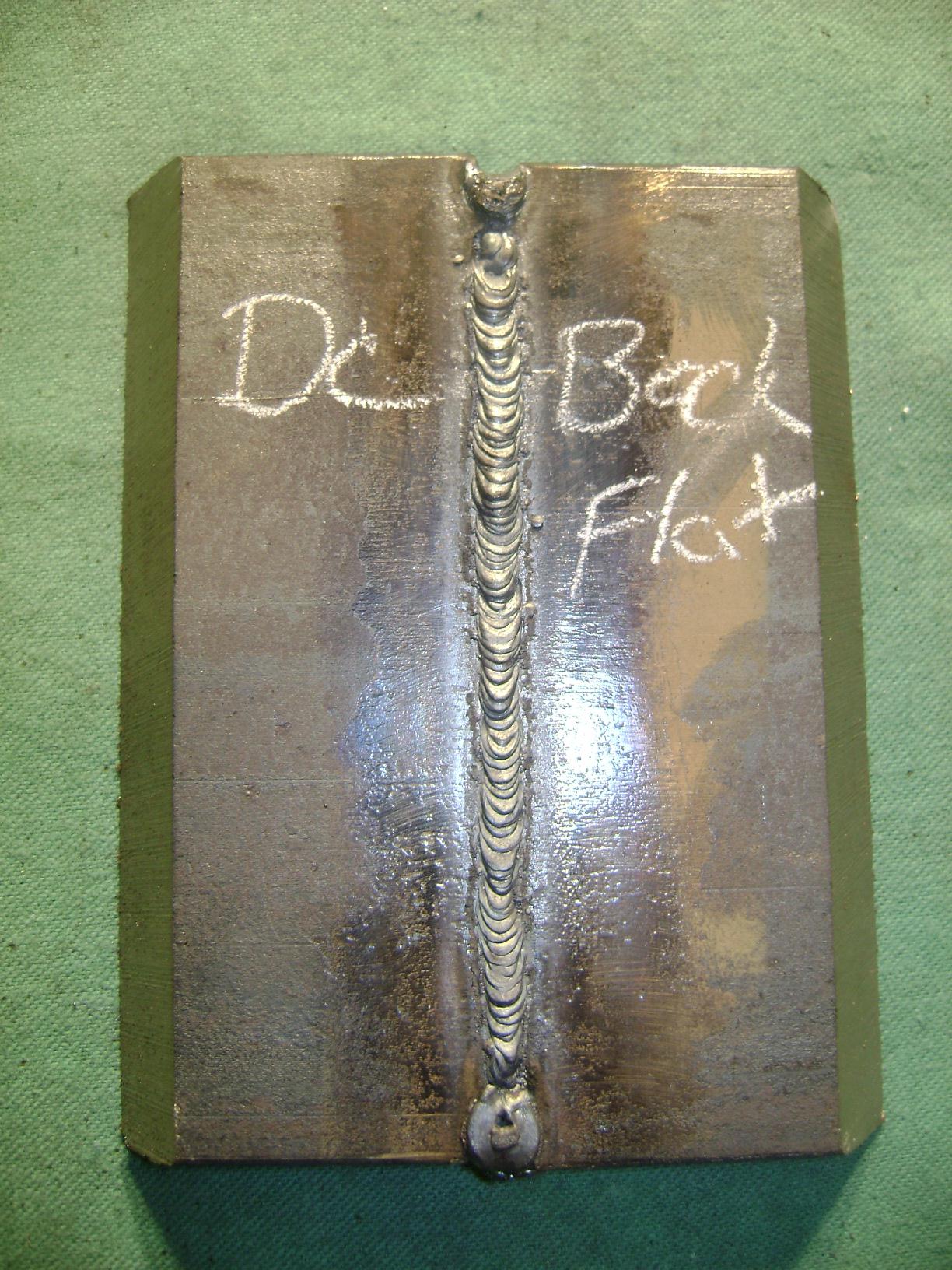

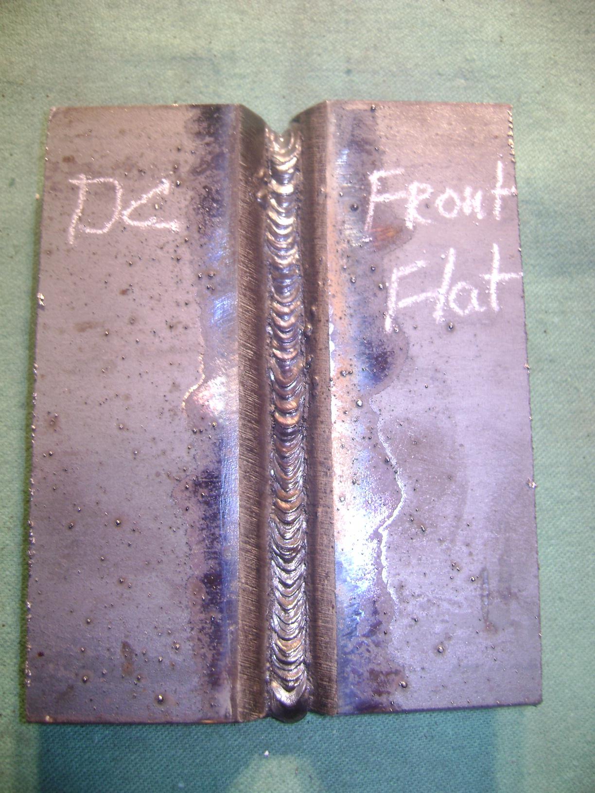

The thought of using AC never crossed my mind until joining these tractor sites. Awhile back I did some side beside comparisons. Vertical up hill open root plates with 6011. The last picture is an overhead weld I made on AC. The sound of the welds being made on AC really got my attention! :shocked:
The sound of bacon frying(DC) as opposed to the crackling of a brush fire(AC). :laughing:
Great pic's BTW. Your AC overhead looks much better than I could do with DC. :eek:
Always enjoy your pic's.
   / Should I keep or convert my old AC stick welder? #18
Well thank you!:thumbsup: You have to remember now, I've been welding for almost two whole weeks. In time I hope to get better.;)
