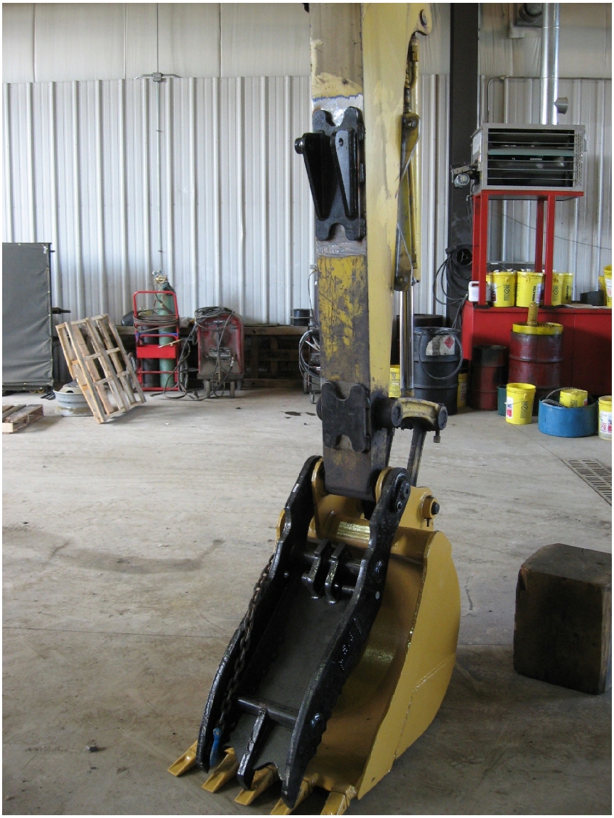

Here is a few Photo's. The grading bucket and wrist have been removed by the previous owner.
This is the engineering sketch of my Thumb.

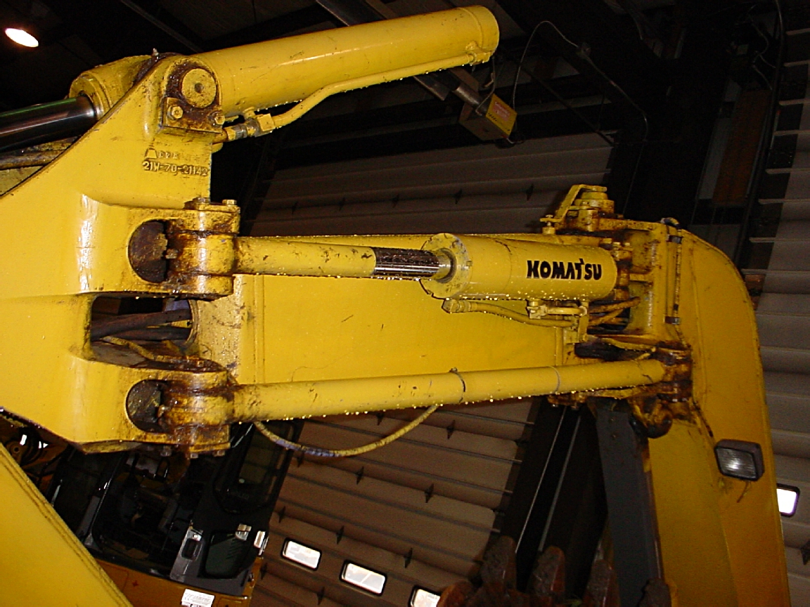

I didn't realize they made them with hinges on the boom, looks interesting!!
Good Luck!
Komatsu's replacement for the PC75UU-2E is the PC78MR.
The PC78MR has all the computer load sensing do dads, a cab made for a big Beef eating American, low range on the track drive, and a boom swivel at base similar to Kubota's KX-80-3.
The offset hinge boom is a wear point. The 3 worst spots on my PC75UU-2E are the hinges and the lower cylinder pin at base of boom. This machine saw a lot of grease. If it had not it would be junk, as new pins and bushing would go about $12,000 to make it tight.
The other thing to watch out for on the PC75's are the limit switches on the hydraulics. If the are activated and malfuction they frezze the hydraulics. $$$$$! I was told to never activate them.
I figure I can put 1,000 hours on this machine and it will still be in the same shape if I keep it greased. By same shape, I mean kind of worn but still quite useable, especially as it will not be seeing 8-10 hour days, 6 days a week.
If anyone wats to swap for a low hour Cat 307/308 or a Kubota KX-80-3, I'm willing. (yeah, right!)

I didn't realize you were so close till I saw Hazelton's on the picture name. Is that where you got it? I live about 7 miles from there. Can I borrow it? :) Just kidding. That swing boom must be an interesting drive.

My thumb has finally shipped. Hope they can install it next week.
I'm chomping at the bit to do some footing work on this monster 64' x 36' home with attached 42 ' x 32' barn!
Plus dozens of other projects I can do with this Komatsu.

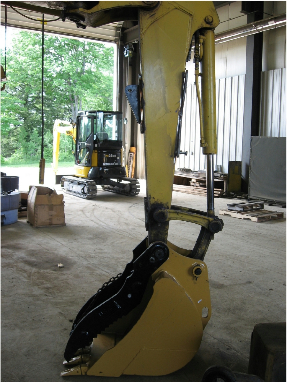

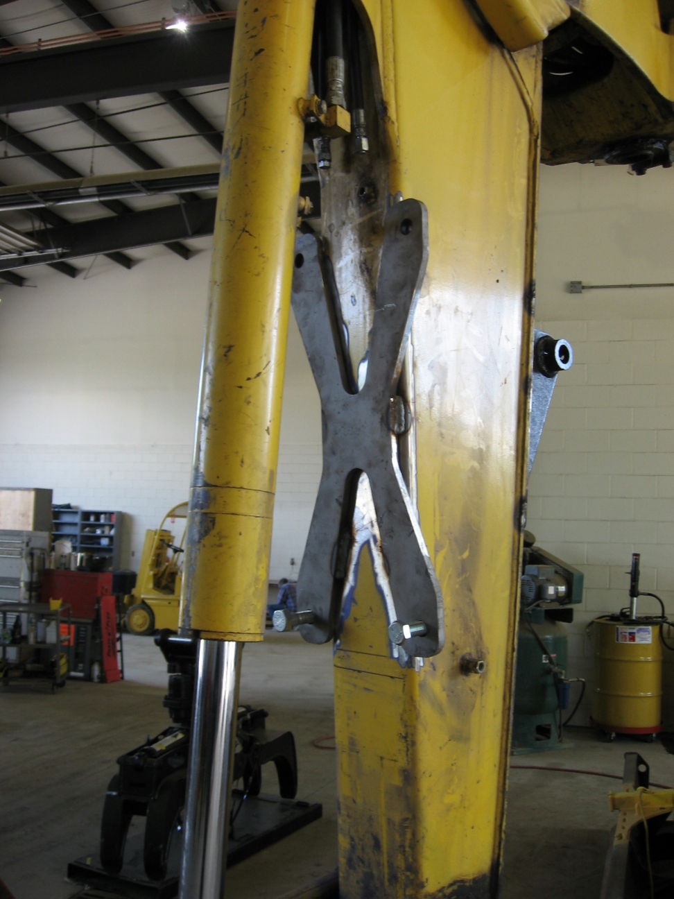

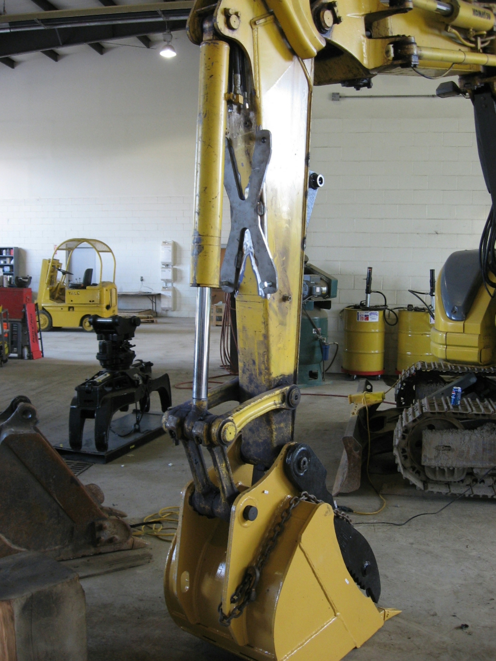

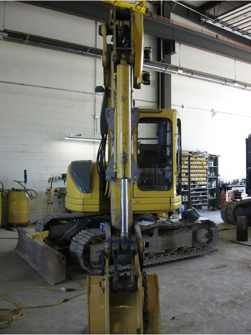

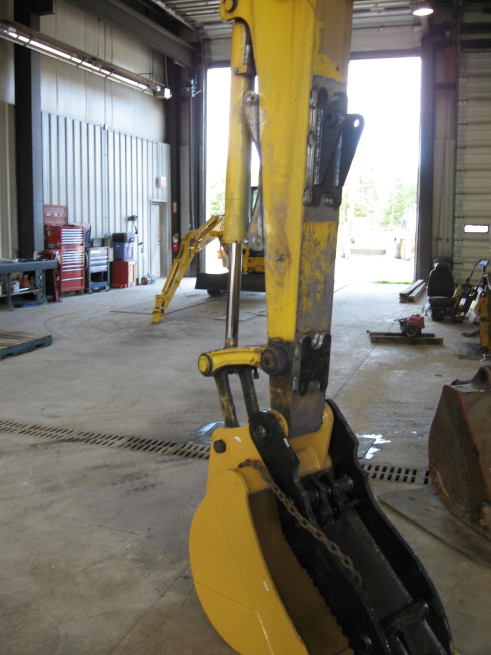

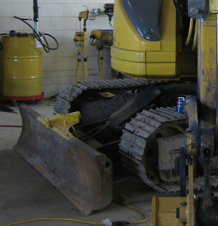

Well after a lot of fiddling around the thumb and other stuff are finally being installed.
I am a bit bummed that I did not receive a 4 tooth bucket, but the price was sure right.

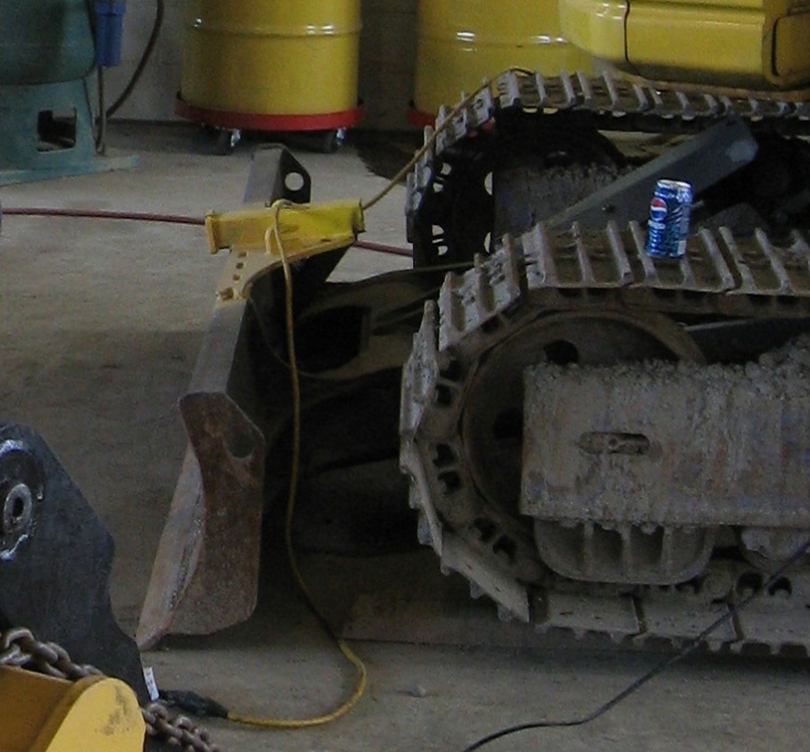

During waiting for parts I had added a jib boom base plate to the dipper arm and a receiver hitch with pull hooks to the dozer blade.
The jib boom will extend about 16 feet past the bucket pivot and I am designing for a lift capacity of +400 Lbs and a +3 0' hook height. I figure this will be a cheap man's crane for lifting roofing trusses, a square of shingles, sheathing etc. up to the roof of our yet to be started future home.
The receiver hitch is a great way to move a dump trailer or my 27' camper around the farm.
