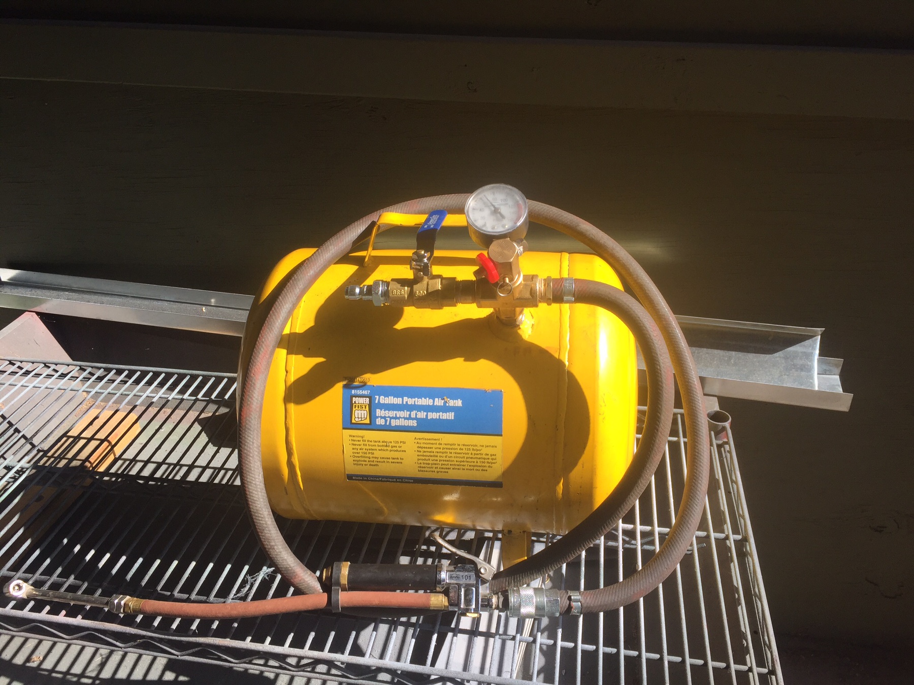

I used to have a "surge tank", made from an old propane cylinder that I could plug it in at the end of a long air hose, to give ready volume to my air impact wrench, which was at the end of a short and fat stub hose. It really did the trick.
I've just installed a two-stage 5hp IR with 80 gallon tank, and am plumbing the workshop with 3/4" copper, so I won't be needing that sort of action. There used to be kits to make an air tank out of a propane cylinder.
I added larger fittings to a portable tank so that it could be also used as a (small) surge tank. With the addition of a ball check valve filling only takes 4-5 seconds and inflating a tire is waay quicker.
Terry

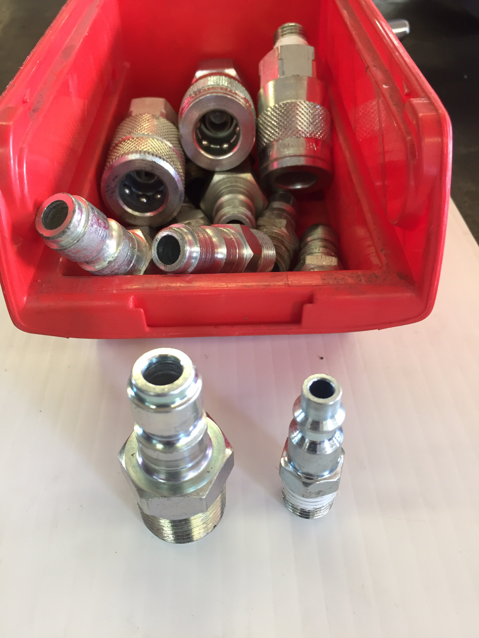

I use 3/4" & 1/2" hard lines exclusively with 3/8" automotive couplers. All hoses are 1/2" & 3/8".
I just snapped a side by side comparison of 3/8 automotive vs 1/4 (on the right) for visual effect.
