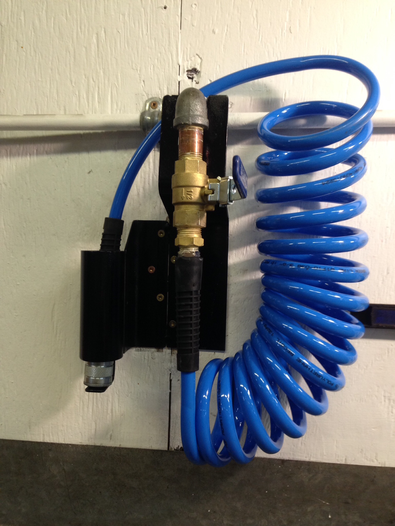

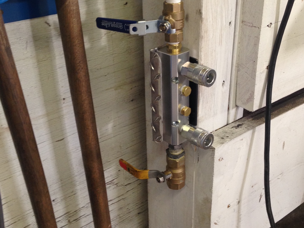

If you are concerned about that restriction, eliminate the fitting. Connect the hose directly to the supply line. I would install a ball valve before the hose, so you can turn it off when you have a failure.

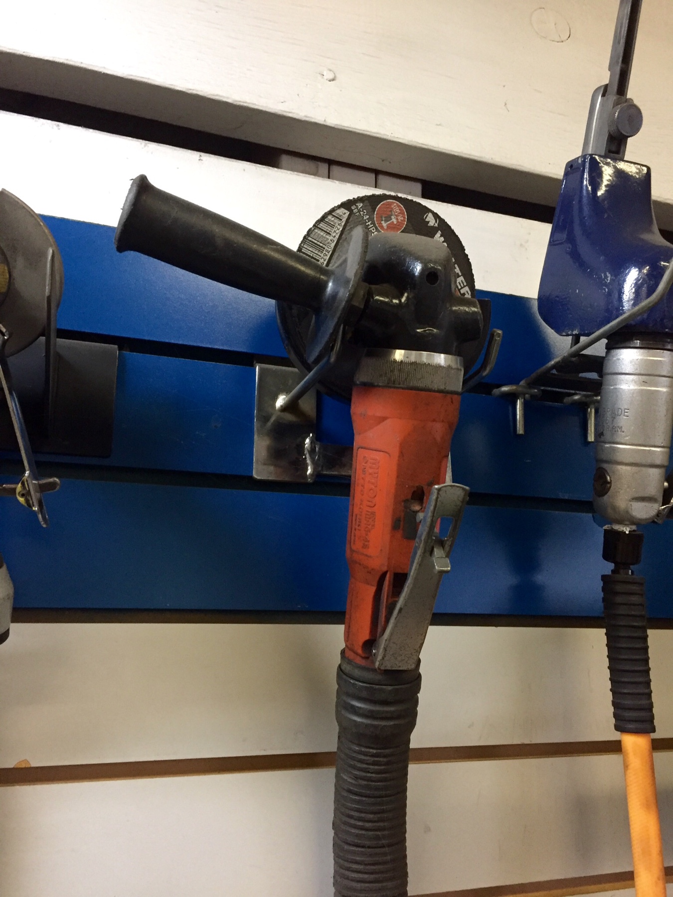

My Nitto Koiki angle grinder uses 20 CFM. (.9 HP). I've used the same style 3/8 hi flow automotive couplers in my shop for almost 40 years.
Good plan on installing ball valves. I use ones with an exhaust port. Makes attaching / re-attaching easier.
Terry
That's the problem with true high volume fittings. You have to discharge the line to connect them. Not very convenient, if you change tools a lot.

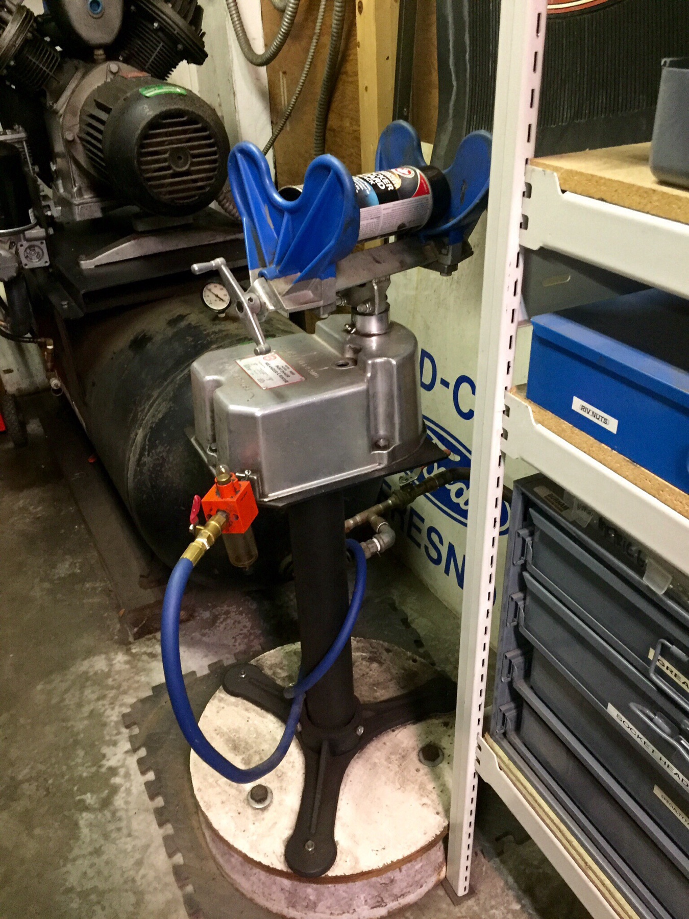

I don't HAVE to exhaust air pressure between the wall outlet and tool to reconnect. Sometimes if I leave something hooked up but not in use (such as the air shear or paint shaker) I like to relieve pressure on the lines and cylinders. But that's just me

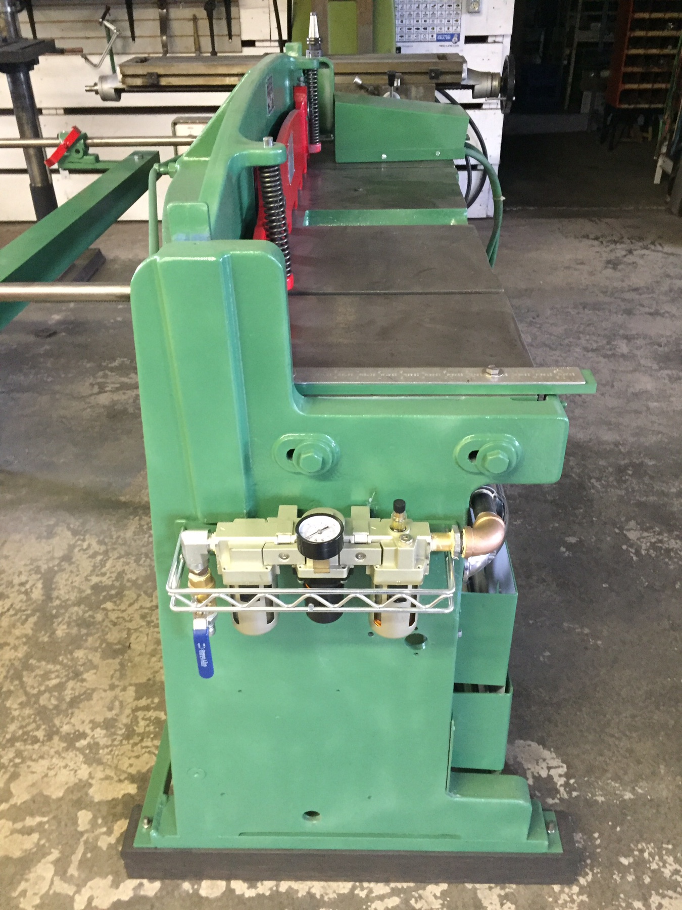

It doesn't look like you use that shear, could you crate it up and send it to me? :thumbsup:
   / Should I swap my airchucks from general ones to auto ones? #39
LOL. I picked it up cheap earlier this year. The sheet metal shop that had it converted it to air.
I had to re-tweak the geometry, rebuild some linkage, replumb the air and add safety guarding. New paint does wonders...
