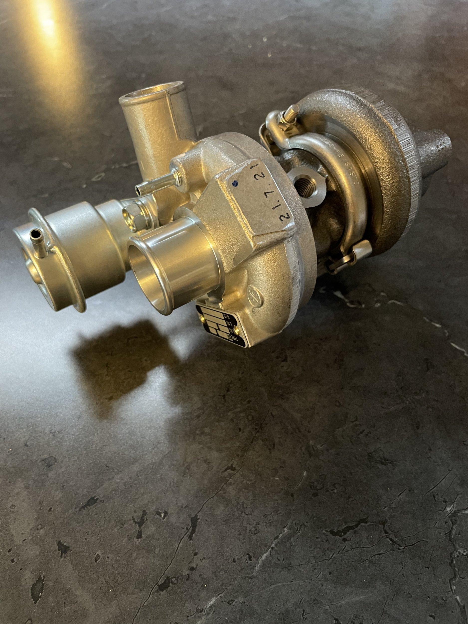

This is my solution;
This is going on my L2501. We’re expecting 45-50 HP and 28-30 PTO. I’m expecting to have it installed in the next couple months.
Mike

There’s no ‘hope’ here. The results will ‘prove’ the effectiveness of the turbo and turbo setup.
We already know the tractor frame will support 39HP and the turbo will produce a bit more, for a lot less money.
There are a couple successful L2501 turbo setups that have been running, without issue, for more than 50 hours.
It’s going to be a good project, I just need to find a local PTO dyno so we can verify our results.
Mike
Are you really sure that the engine and drive line components will support the boosted engine output?
Usually turbo'd engines have reduced compression ratio because of increased cylinder inflow temperatures or they have special coatings on the piston crown to take the higher peak gas temperatures. You realize that you will have to turn the fuel flow up also.
50 running hours will only prove you don't have an early engine death. Tractor engines are designed for 1000's of hours of dependable operation. I'd advise you consider more operating time before you declare success.
The proper way to design an engine and powertrain is to design it for a turbo and then de-rate for lower power models all the way to normally aspirated. The lower rated models will generally have greater durability. The alternative is upgrade the weak components as you uprate the engine. That means more parts inventory and additional manufacturing costs.
Unless you have a lot more info on the engine design details that are generally only privy to the engine manufacturer, make and break development programs are generally very costly.
Good luck on your endeavor.
Mike
Well, this is orange, and it's turbocharged. Seems to give it more power (if not sense)!

Make and break development programs are generally very costly.
The bottom line to the above 1,151 messages is The Fred intermittently got the incremental power he wanted at fabulous expense in down time.
The Fred's concluding Kubota post was January 3, 2021:
"I DO still hate my tractor!"
I have been posting here since 2011. I cannot recall ONE thread where adding a turbo to an engine not specifically set up for a turbo proved successful for the owner.
Not what I’m going for, although, it’s highly entertaining! :D
