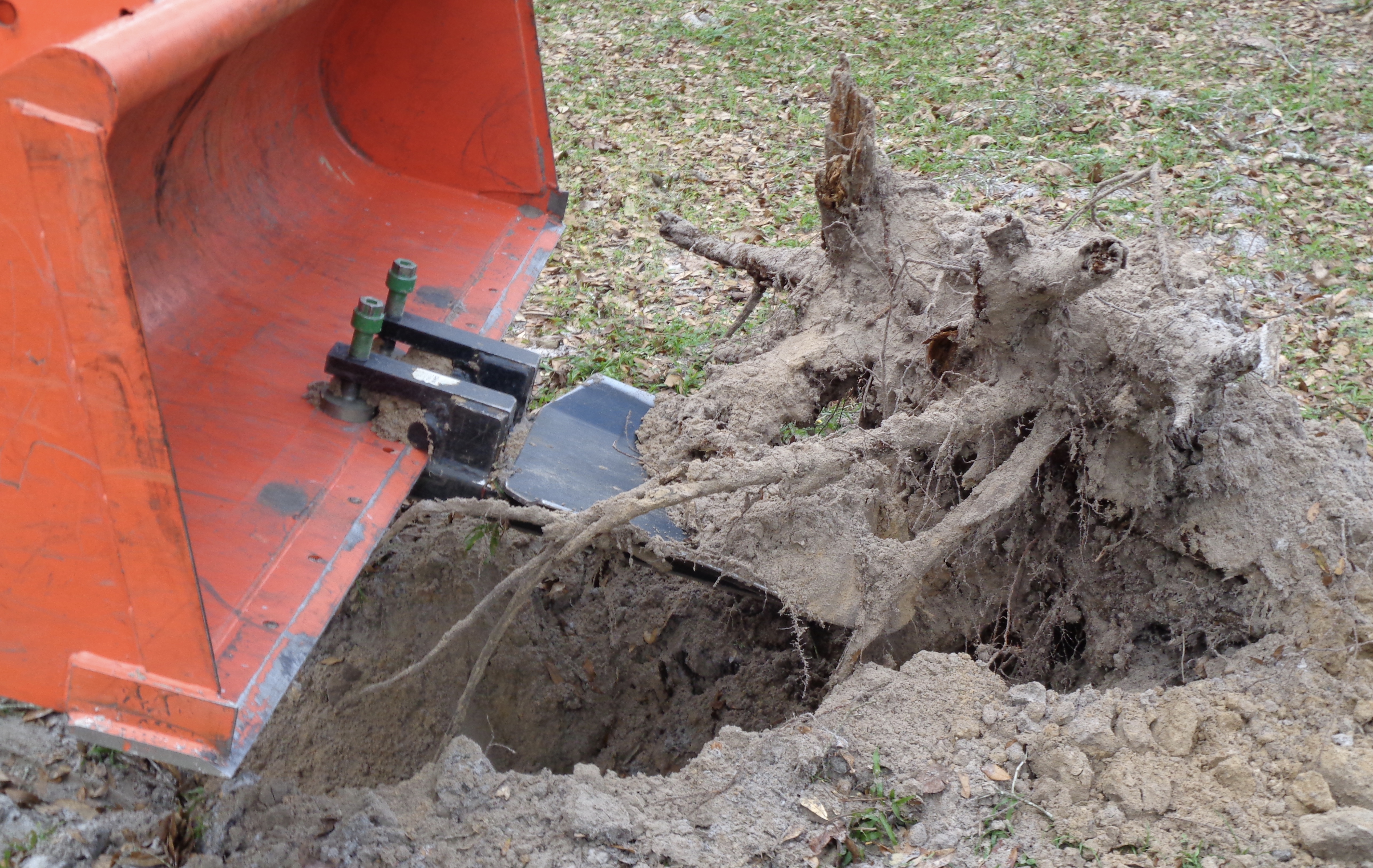

I cut stumps near grade level then treat immediately with undiluted 2,-4d herbicide. Wait one year and the small roots will have decayed and stumps come out pretty easy. The stump has to be dead for the roots to rot, hence the 2,-4d treatment.
Roots decay 12 months in Florida. Your decay rate may differ.
