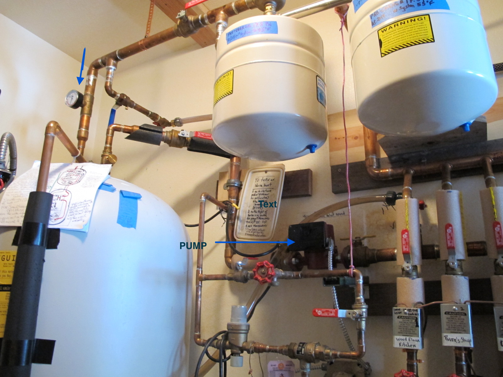

Sure, glad to.
The heat source is nothing more than an electric 50 gallon Hot Water Heater filled with half water/half propylene glycol. I chose a Marathon brand because they have a fiberglass/epoxy body and won't rust.
This type of heat is simple and cheap initially, but does cost electricity. It wouldn't be reasonable longterm where electrical costs are high because an electric HWH doesn't put out many BTUs compared to a natural gas or propane boiler. It is a darn good way to get up and operating though....
So although these hydronic floors we built would be up to the task if they were carrying warmer water, the HWH itself just won't keep up. An on-demand type hot water heater run off nat gas or propane would probably be a good compromise between what I have and a real boiler like the Munchkins.
Remember, we built using the cash we made as we built. Didn't want a loan or debt. So we built with alternatives.... the HWH was cheap to install, but I also plumbed in some extra fittings fluid fittings, along with a propane line (capped) and a outside vent all into the utility room so we can put a real boiler in there any time we want. It would only take an afternoon. So far, this works OK.

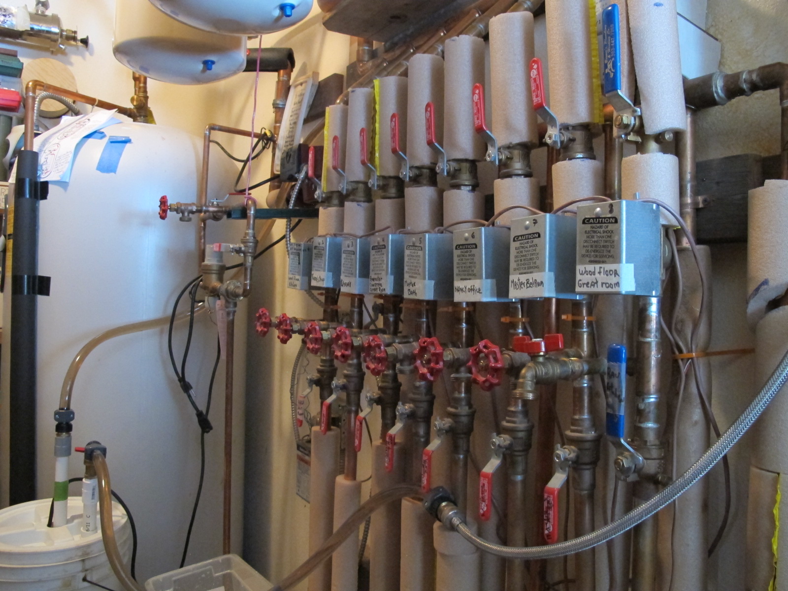

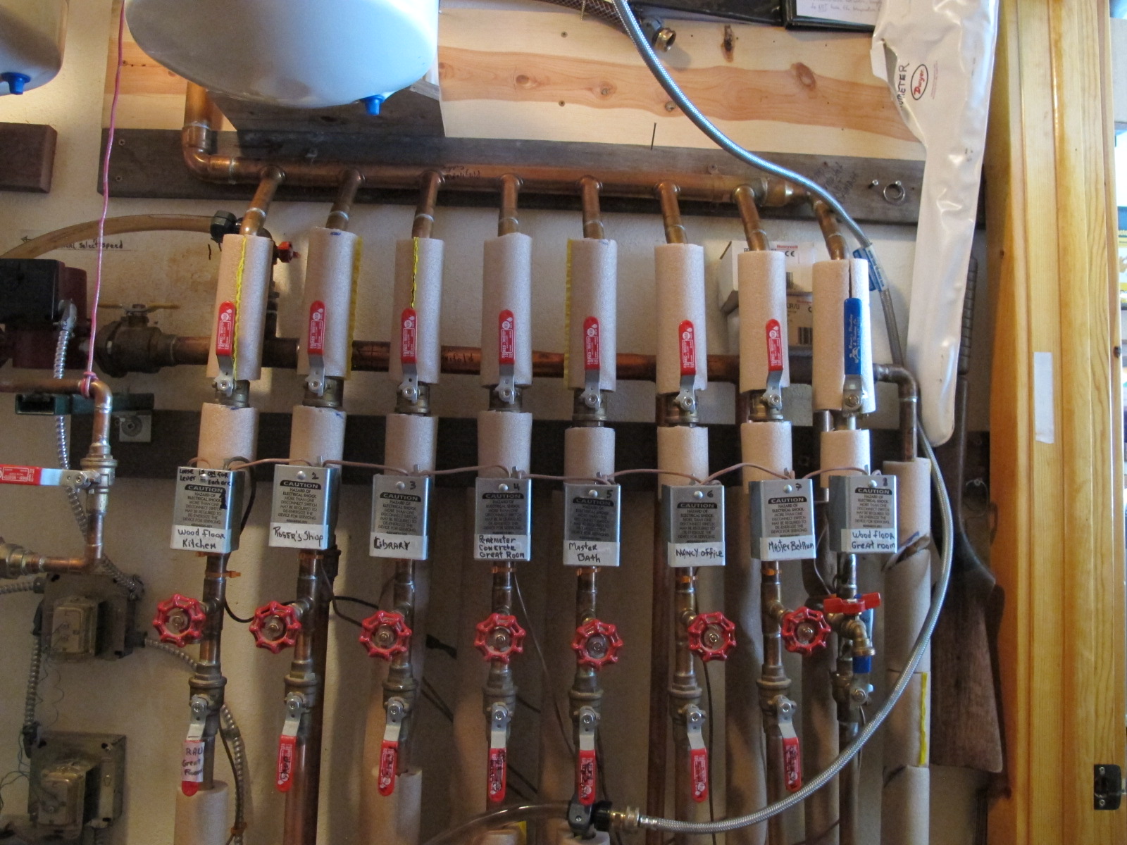

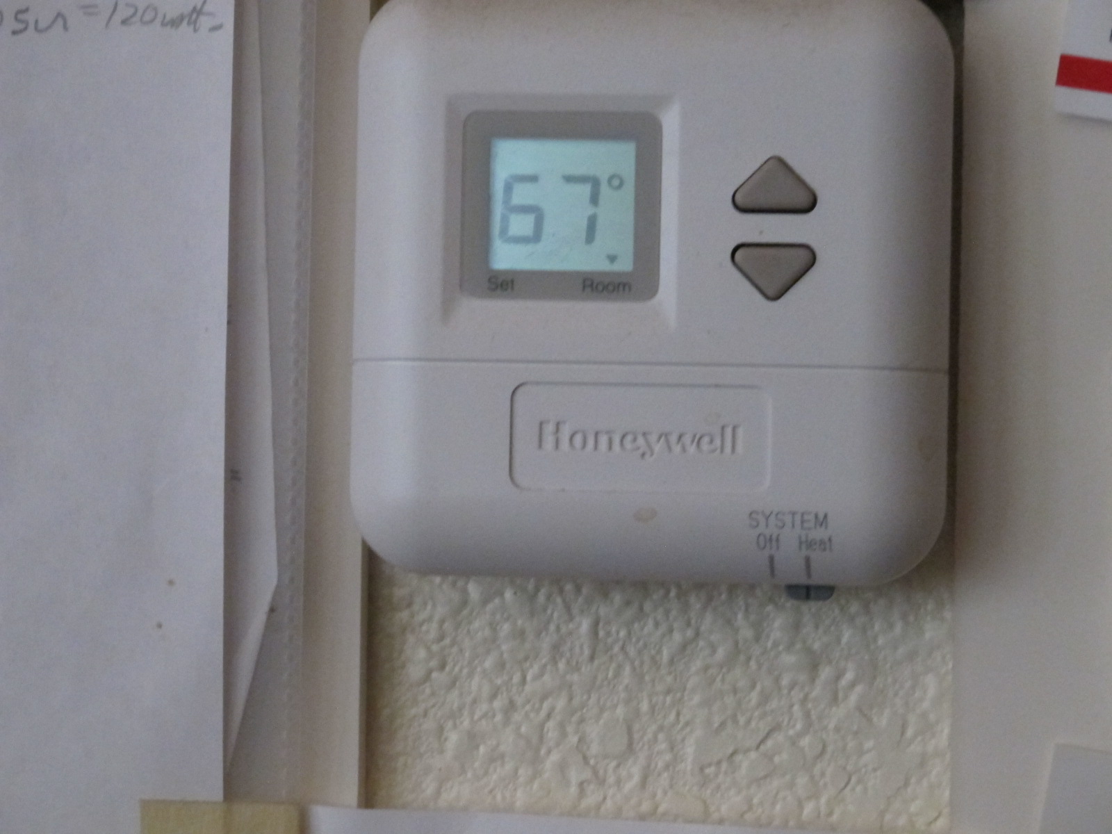

Yes, there are 8 zones in the house - all come off of the central manifold you see in the first photo. The zones are balanced for resistance by making each zone have the same length of heating pipe buried in the cement . The main room of each zone has a simple thermostat placed on the wall of the main room in that zone. Each thermostat then controls its own electrically-operated on/off flow valves which you can also see in the photo of the zone manifold. And since I like to tinker, each valve also has a manual over-ride so I can take any zone out of the system without affecting the rest.
Each thermostat can call for flow or not - or I can override it. Note that the zone manifold itself is simply made of plumbing fittings soldered together. Making up the manifold one weekend saved a few grand right there.
The pump for the whole system runs continuously any time any thermostat is calling for heat....it seems completely sufficient - which surprised me since doesn't run any faster or slower if all eight zones want heat at the same time. I've included a photo showing the pump. It is very small and quiet.
Any hydronic system is slow to change temperature and this one even more so. There's a lot of mass and not many BTUs. There's advantages to that. And one of those advantages to a low heat hydronic is that the floor and walls and room air are all about the same heat give or take a degree or two. So a simple cheap wall thermostat works fine for temperature control.
