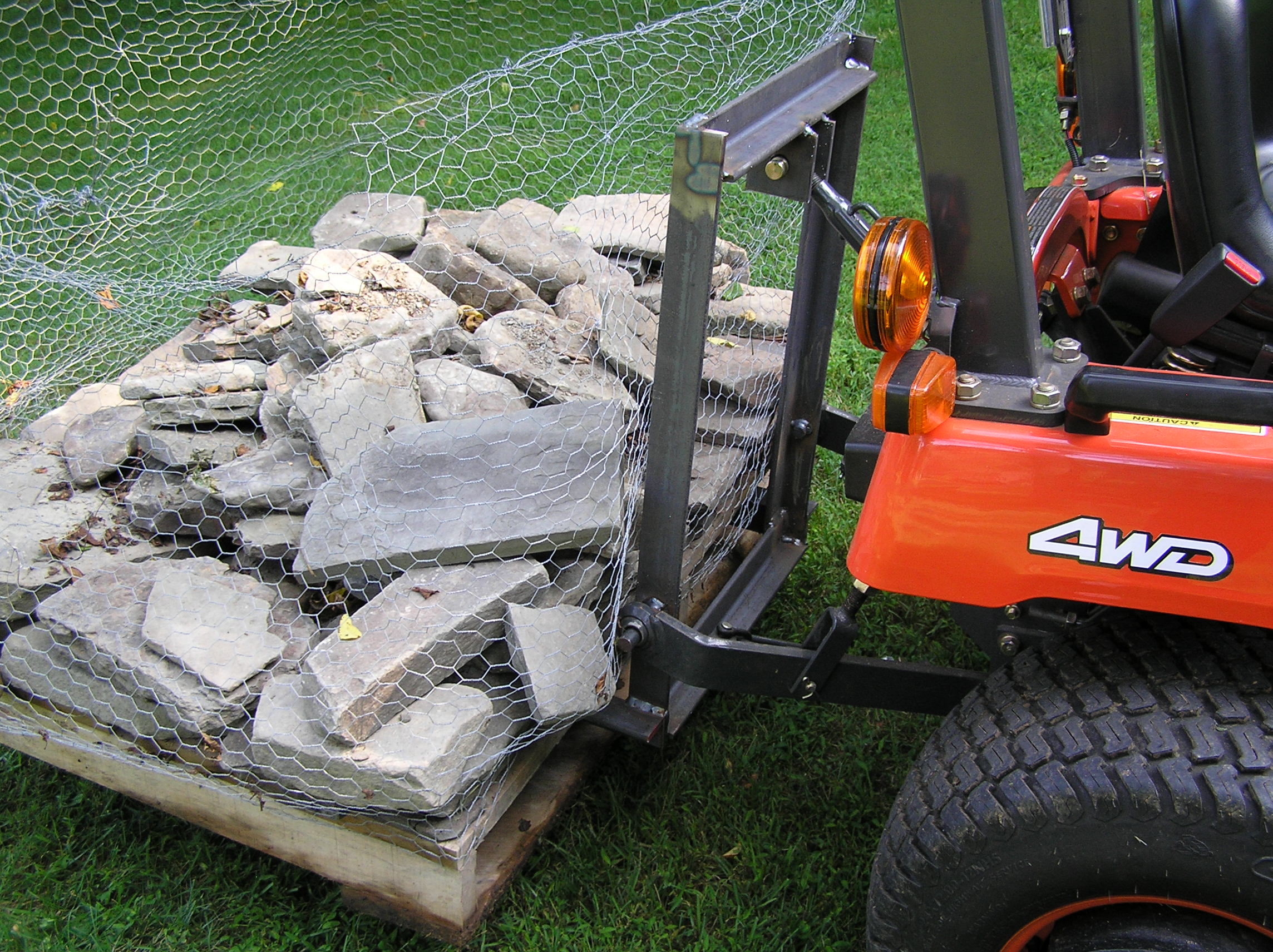

I bought the HD 1000 lb capacity carry-all from TSC and then added some old planks. However, I found I always needed my 500lb box blade on the back of the tractor as a counter-weight and for trail maintenance. Since I have not used the carry-all in years I am selling it.
