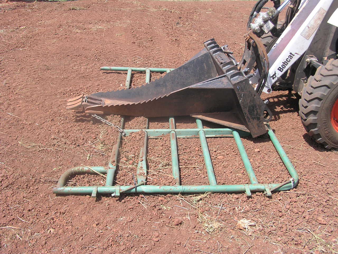

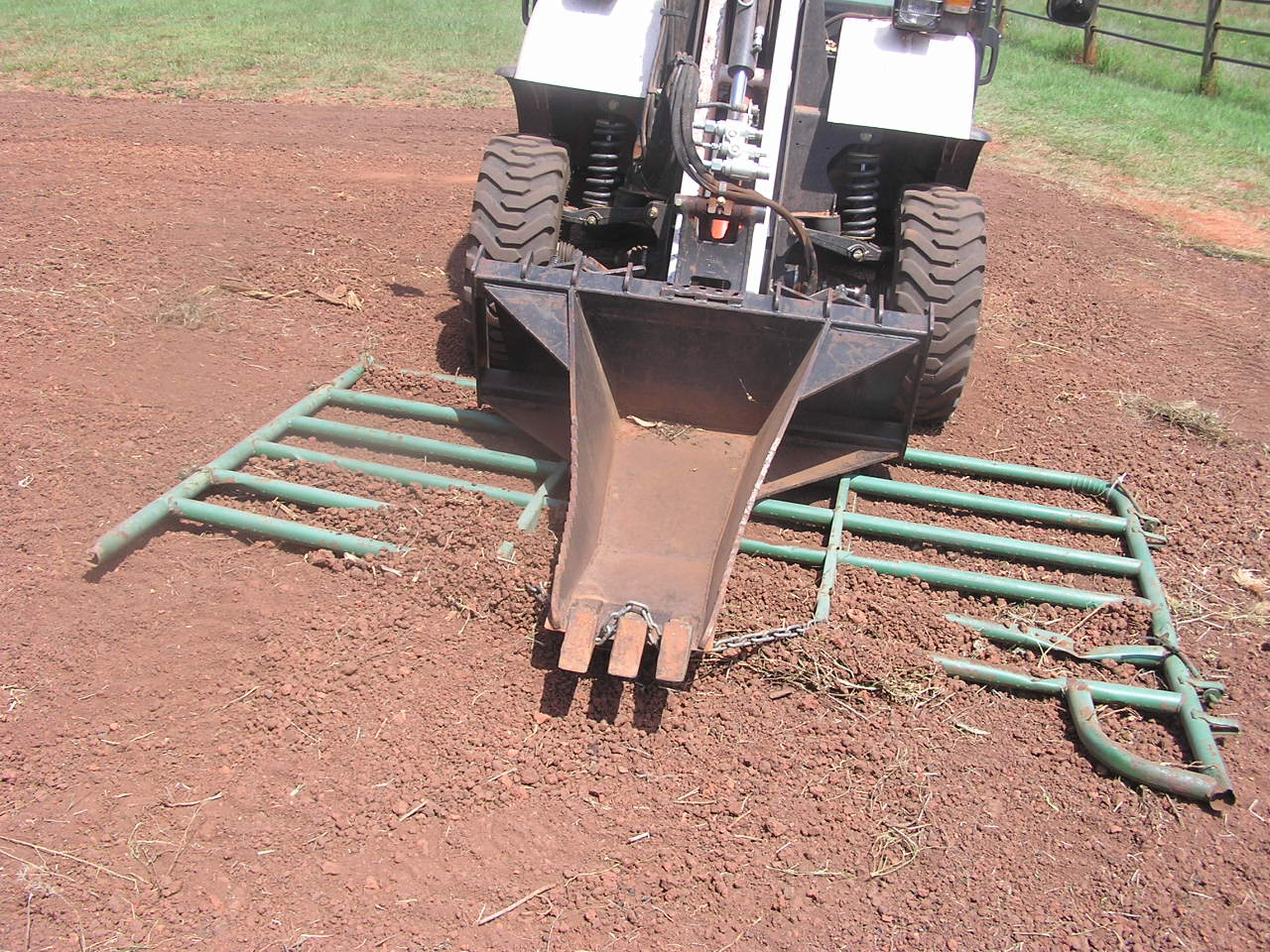

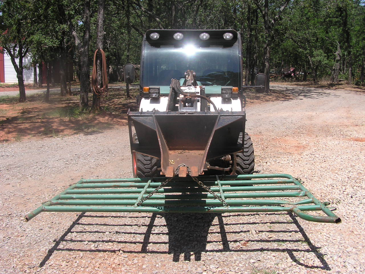

IF I had drag it would most likely look some thing like this, not very attractive, but I do not have any drag, but I do have a soil mover,
Glad I already had my dinner, that would RUIN an appetite.
