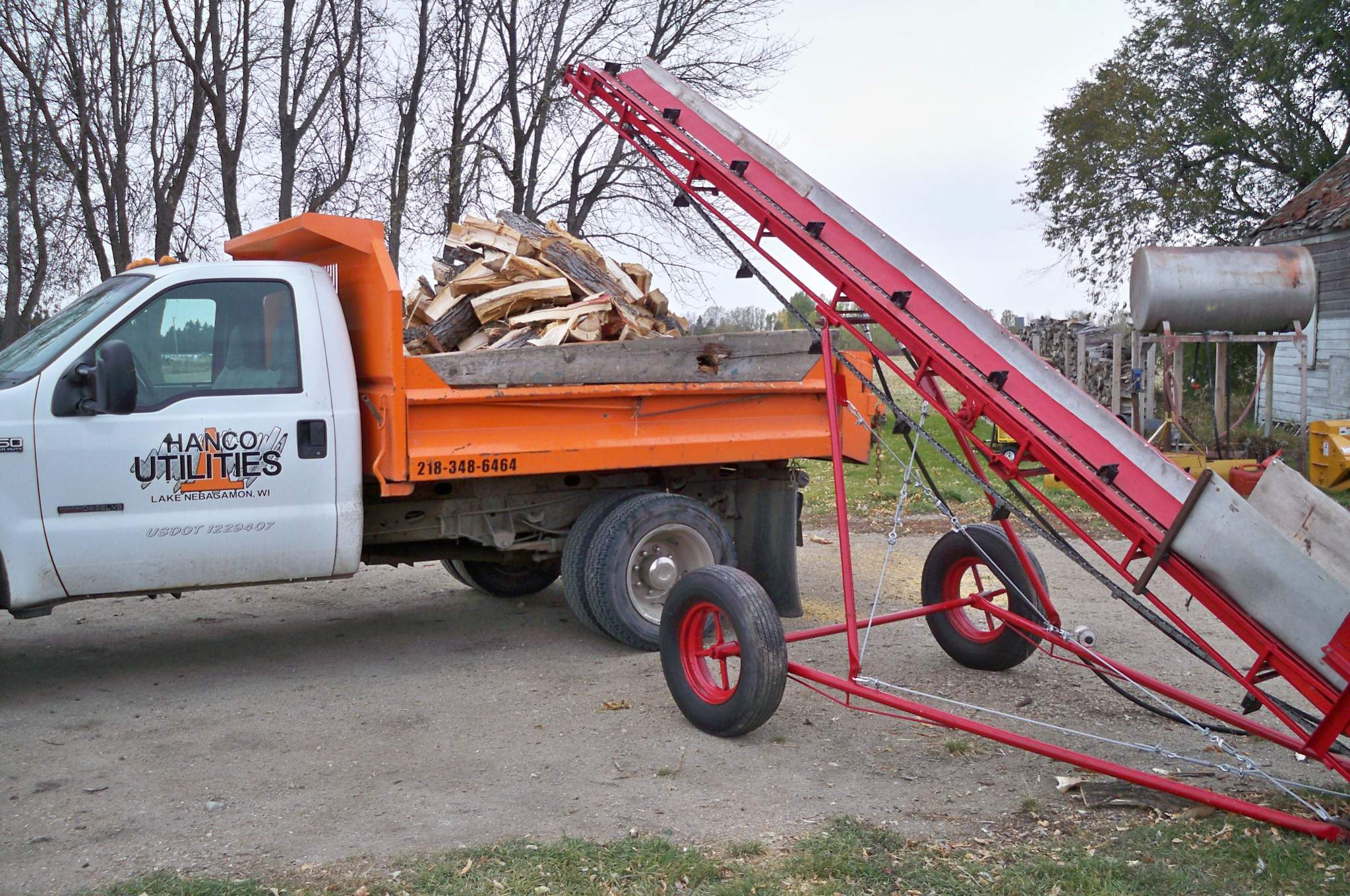

I built this firewood conveyor two years ago.

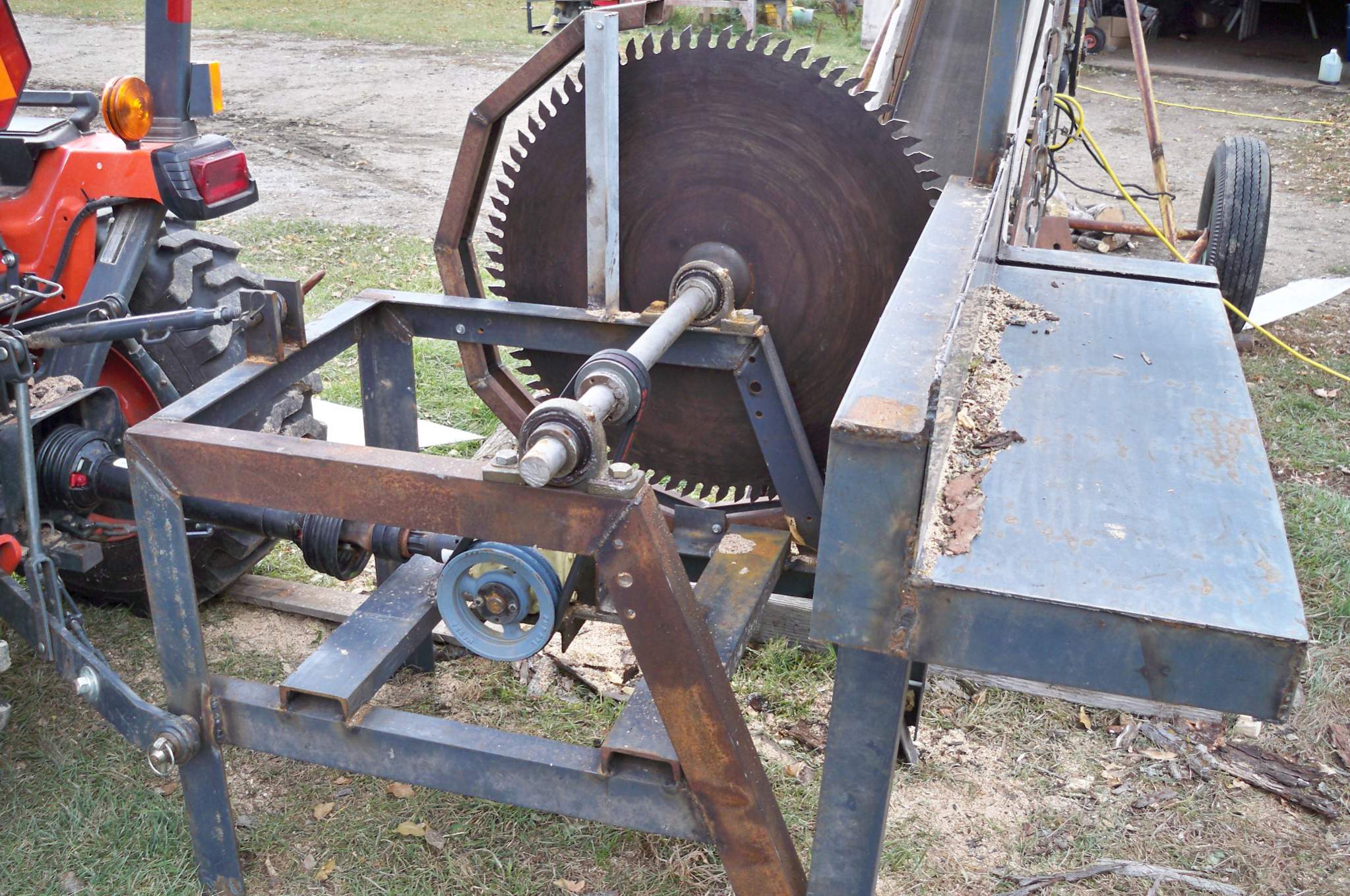

I built this buzz saw about three years ago. It was constructed from scrap metal. I purchased the gearbox, drive line, bearings, and blade. I then machined the saw arbor from a 1-1/2" steel shaft. The 31" blade spins at 1300 rpm and can produce about 3 cords per hour when staffed with three good workers. I can make a little over a cord per hour when working by myself.

working on a deal kinda like that myself...Pops had a working saw...I'm working towards powering it off the PTO
