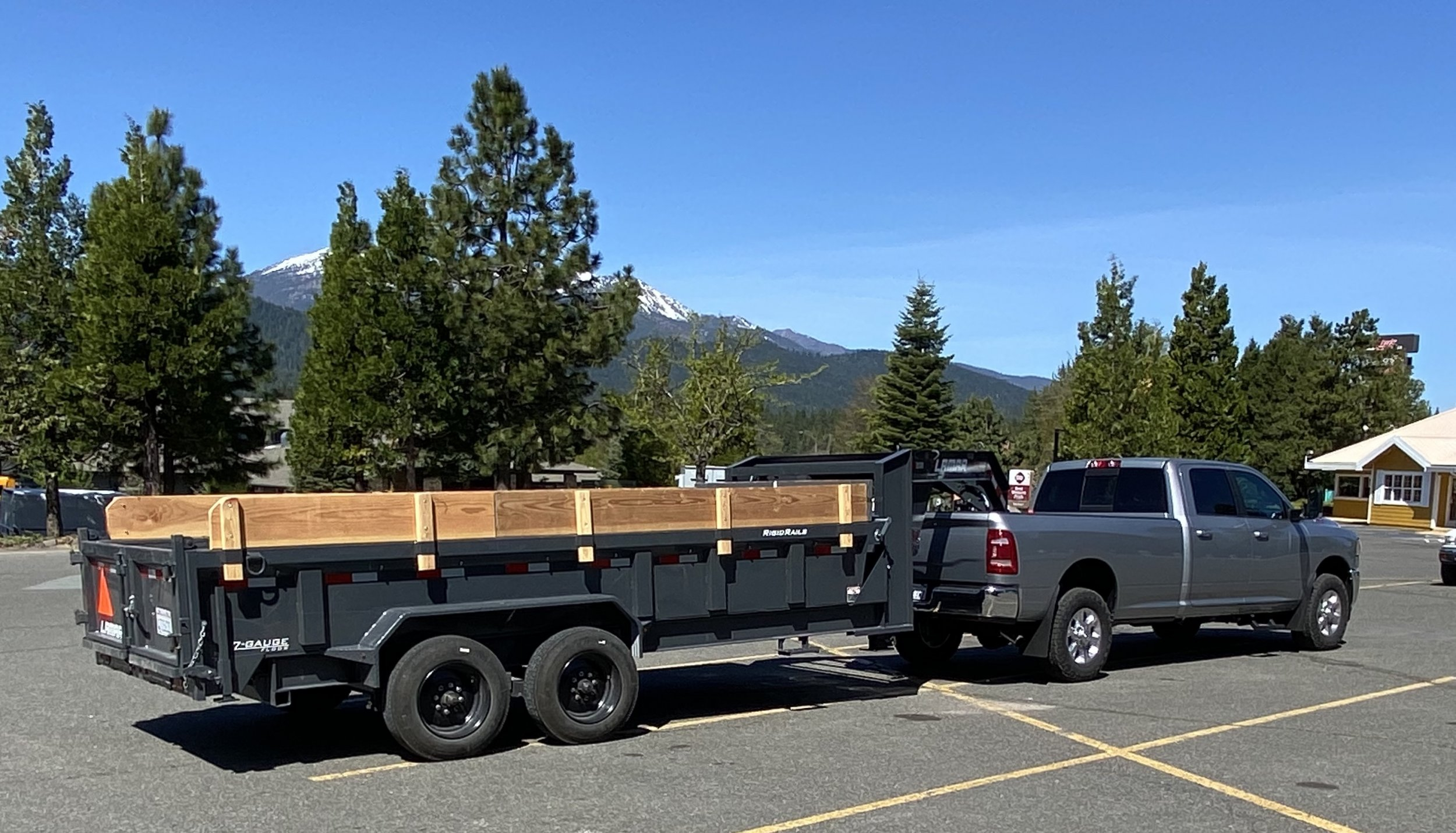

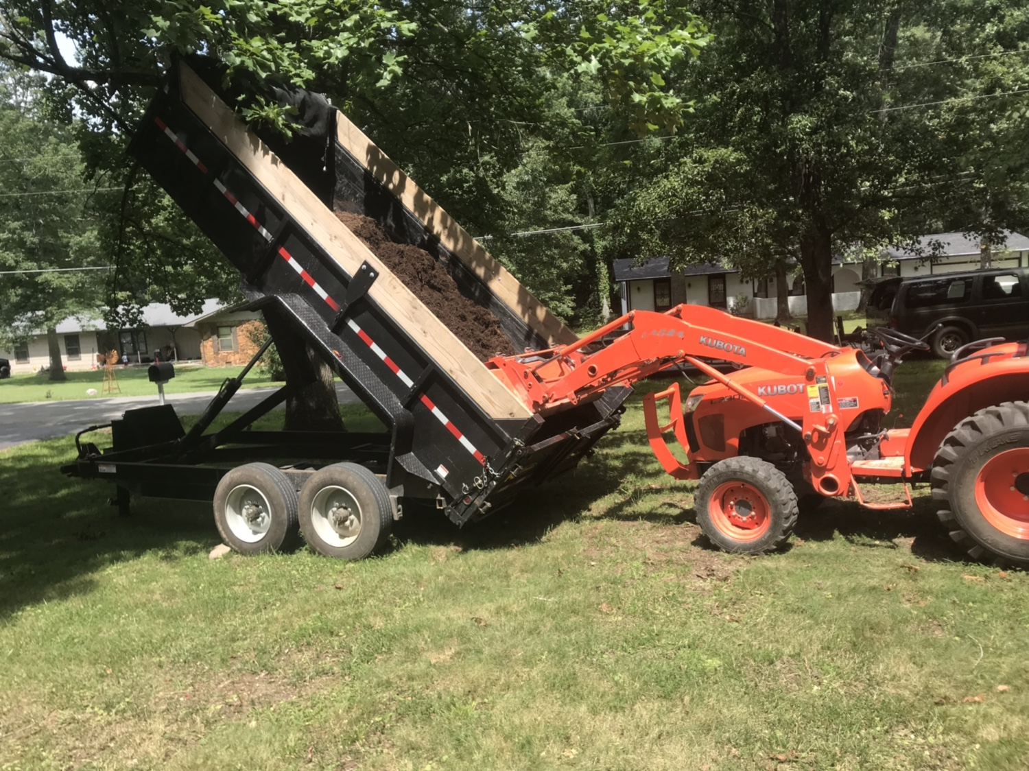

In my case, as far as unloading, I split my wood when I get home. Whether by hand or tractor splitter, it's easier to work off the trailer than off the ground when splitting. Sure, a dump trailer would be nice at times, but over all, very impractical for me! ~~ grnspot
X 2 Why dump the wood on the ground just to pick it up again.

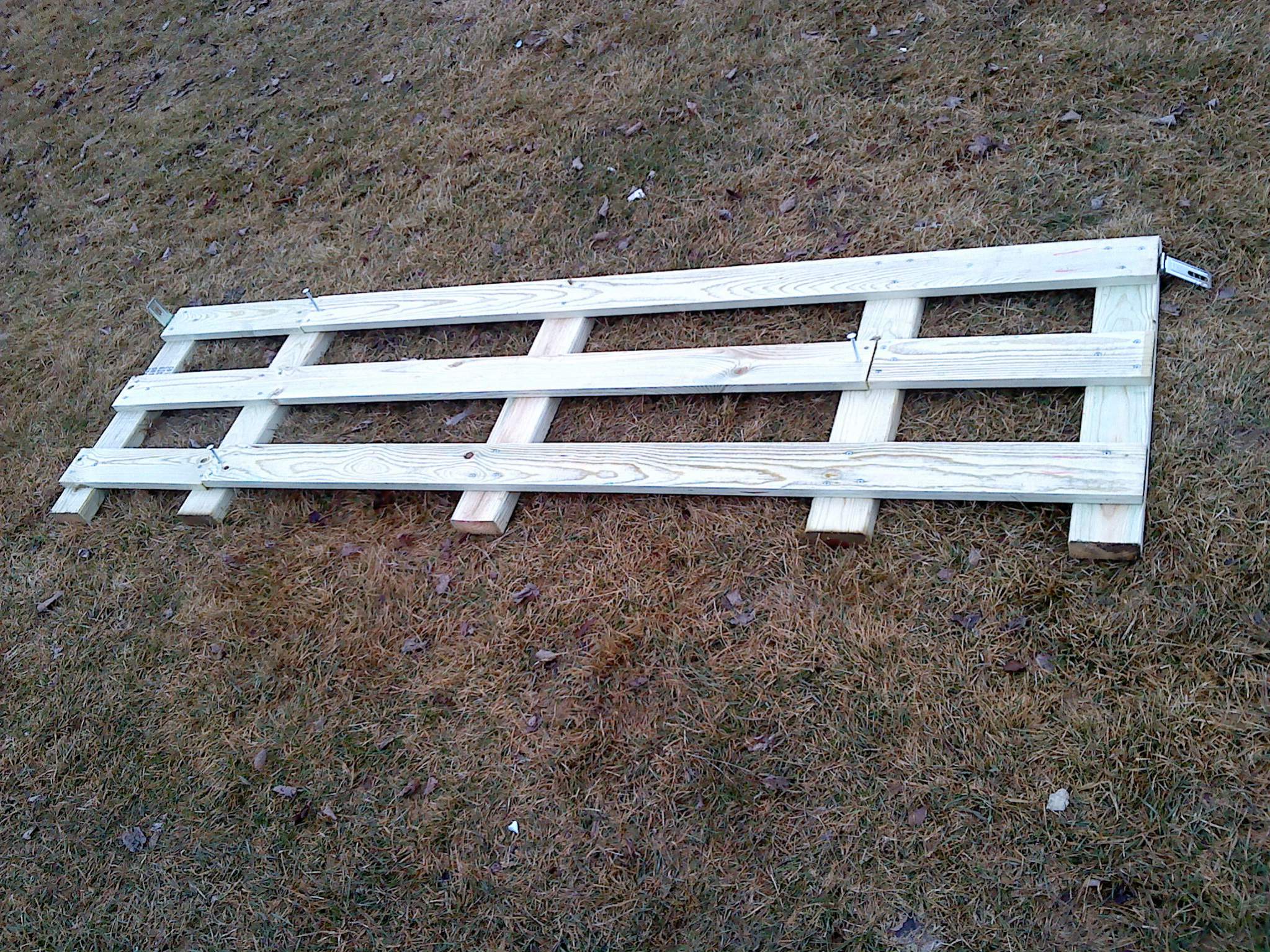

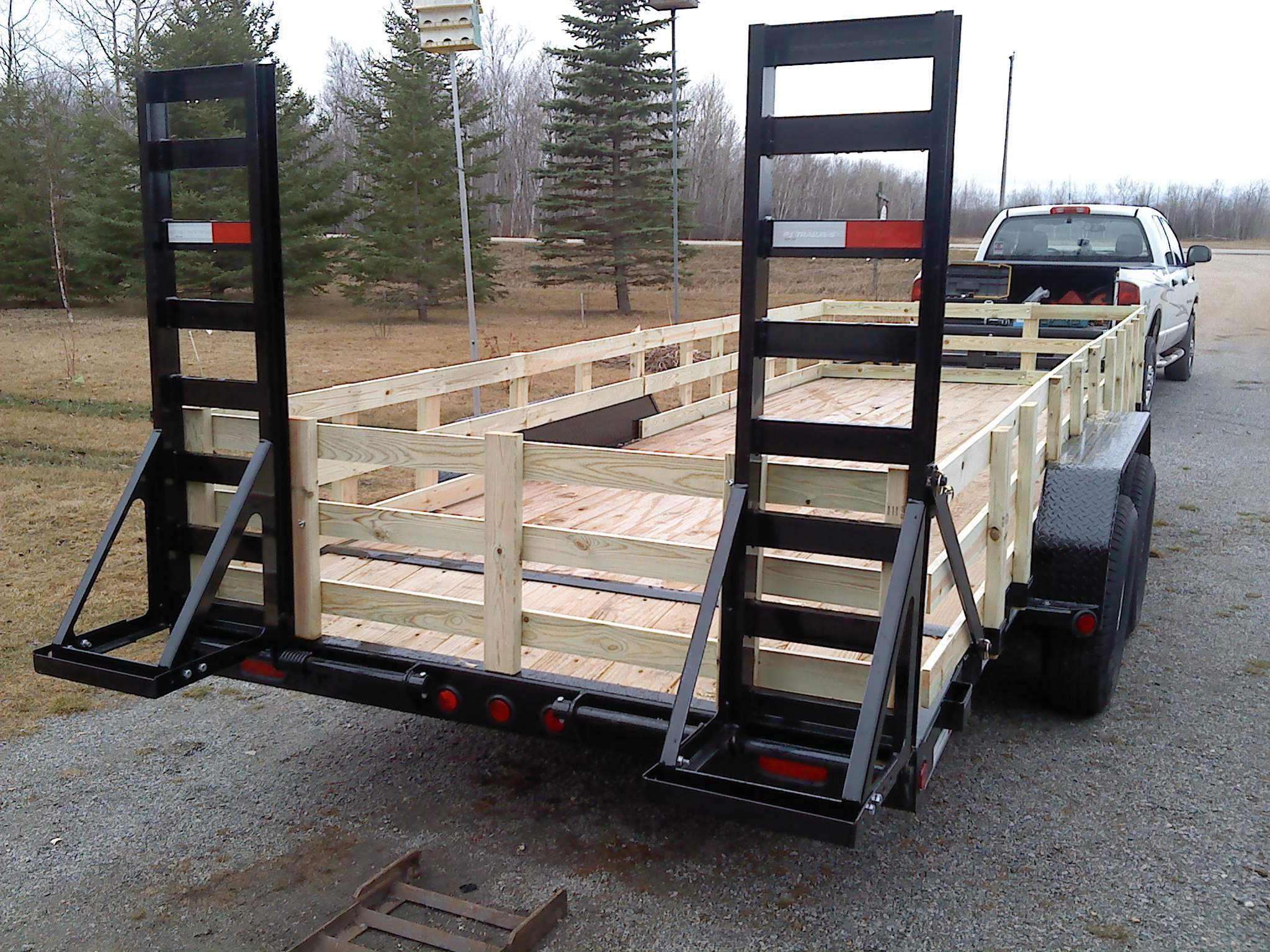

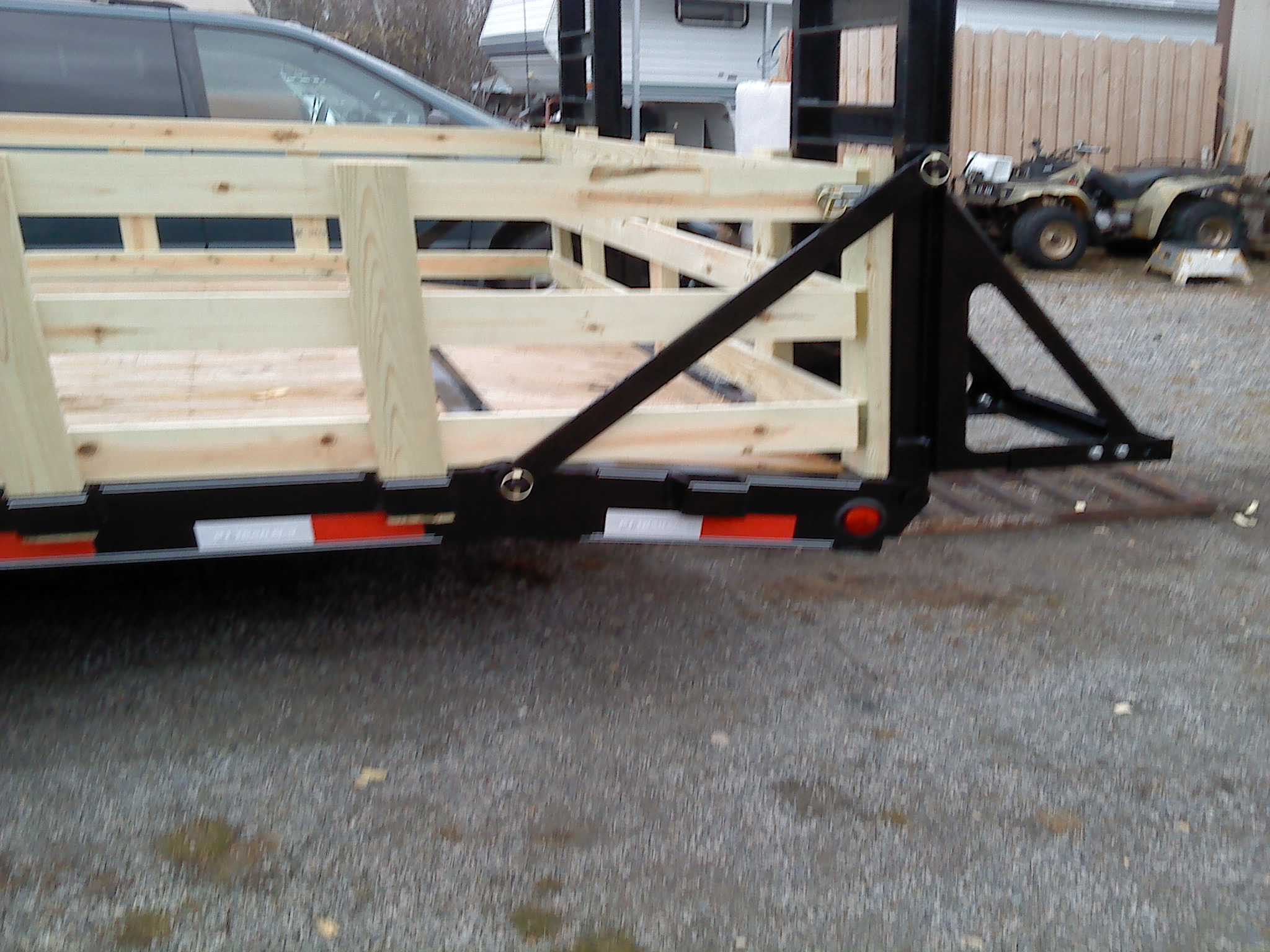

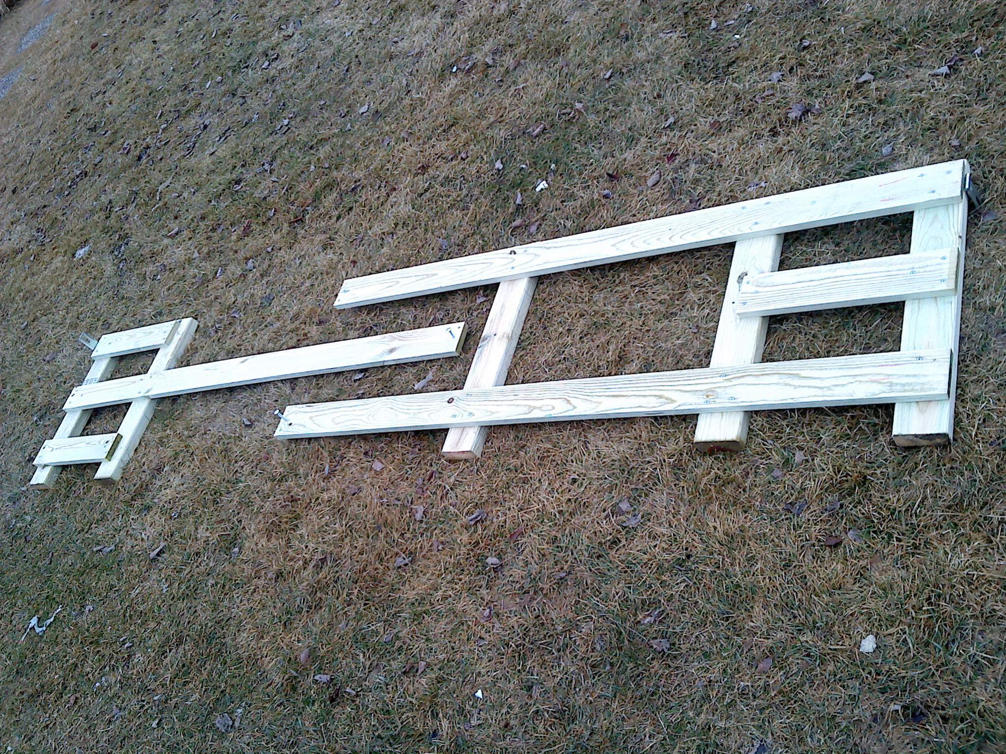

How is the rear section attached?
That was my backyard engineering challenge. The trailer is 7' wide, but I needed the stake sides (plus front and back) to fit into a 6.5' pickup bed, so I built it in two sections and attached them at alternating points with three carriage bolts and wing-nuts. They are then attached at the corners with hasps and clevis pins. Now, the dovetail presented a bit of a challenge as there were no stake pockets, but I counted on getting support from the ramps, since they'll be in the up position while using the sides, so I included them as a structural brace. The tailgate is simply wedged against the ramps, and the end result is very stiff and strong, while still easily installed or removed and disassembled. Sorry, one of the pics got a little blurry due to bumping the cellphone, but hopefully, you'll get the idea.

Does your trailer have the lay flat ramps?
   / Show your trailer sides #24
Nope. They're spring assisted to be able to lift them with one arm and pin them straight up like in the picture. They are twice as long as the dovetail, so they would stick up and take up too much cargo space if they were to be folded flat against the deck. I think they'll work out fine as is.
