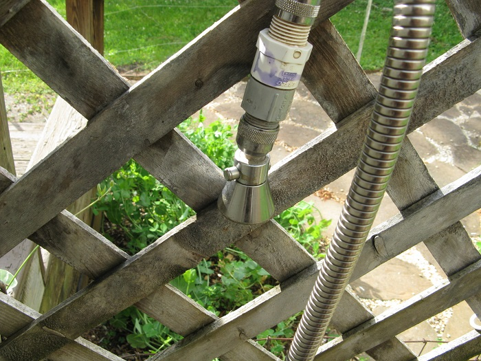

Here are pictures of the outside shower valve together and with the "fan" end unscrewed. Very easy to maintain. Have a 2 1/2 gallon "Tiny Titan" hot water heater on the cold water from the outdoor spigot; so, needed a low flow, but it still has a "blast" to it. Water fans out from that cone that unscrews.
Think I bought it years ago at either Lowes or Home Depot.
