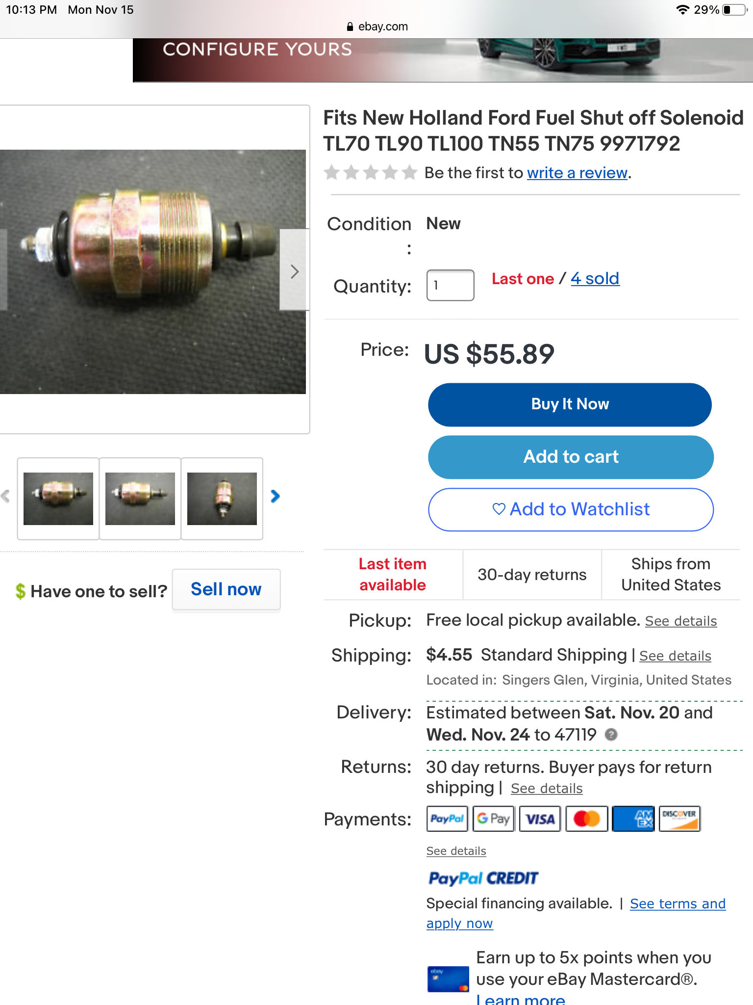

I have a New Holland TN75DA tractor, it will not shut off when I turn off the key. I have to put in gear and let it die. where is the fuel cutoff solenoid or wires?
/ shut off solenoid #2
It's on the end of the fuel injection pump. Your problem could be a bad ground.
/ shut off solenoid #3
It may look similar to this. (Not sure if the TN75 is the same as your TN75DA)
