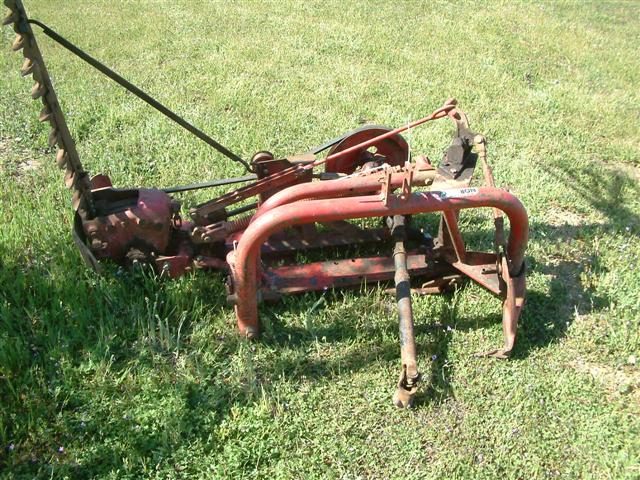

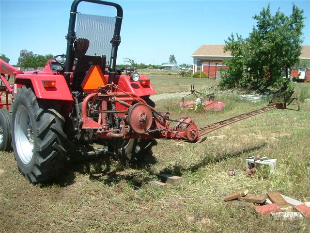

I bought this Massey Ferguson 41 sicklebar (7ft) at auction for $600.
Spent another $150 on new sickle sections and guards. Also $20 for a spare drive belt. It's a good mower. I use it in my oat hayfield.

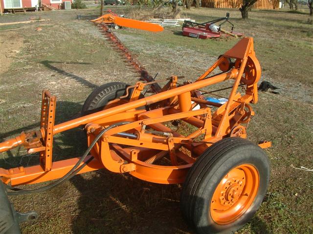

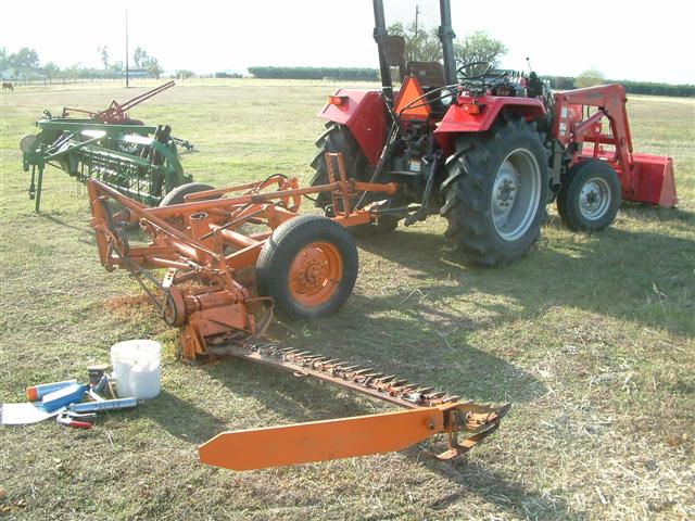

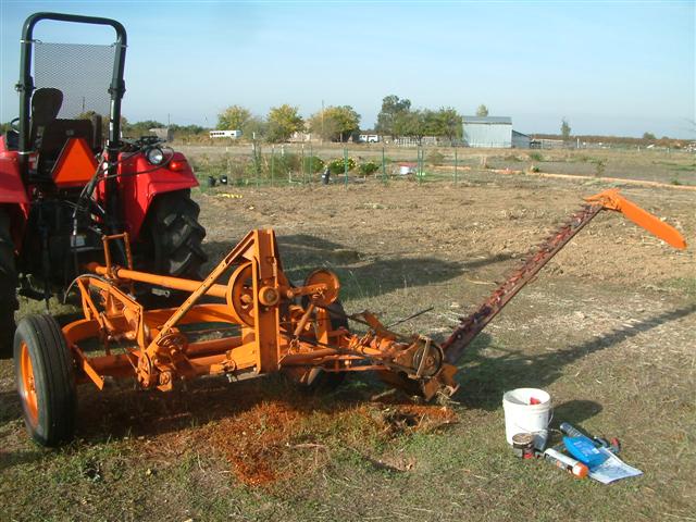

I bought this Allis Chalmers 80T pull behind sicklebar (7-ft) for $150 from a neighbor. Everything works, including the hydraulic ram for raising and lowering the cutting bar. Need to replace the sickle sections.

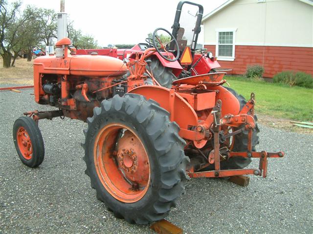

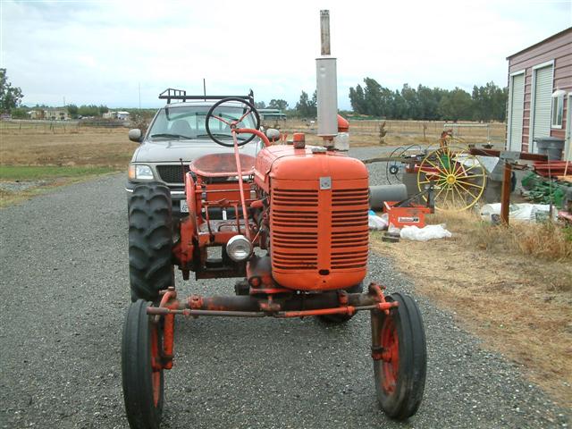

I bought this 1951 Farmall Super A tractor for $1300--including a mid-mount sicklebar mower (6-ft). Haven't had a chance to use the mower yet. The guy who sold me this mower works for CalTrans and got this mower from work (excess equipment sale). It was use to mow ditches and highway interchanges.

Any of these mowers would probably do your job.

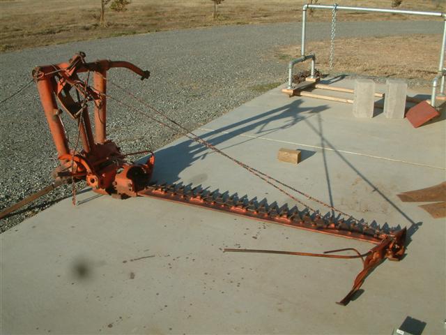

I'm a fan of the New Holland 451. It has a brilliantly simple knife drive (no pitman), and it uses the up and down motion of the tractor's 3-point hitch to multiply the lift of the bar (no hydraulics needed). Also it can be assembled/adjusted off-center to be outside rear tires that are set wide. Most 451's have 7 foot bars, but some have 9 footers. Good luck with your search. DickB
My MF41 sicklebar has a similar mechanism to lift the bar to about a 30 deg up angle.
It's the gizmo attached to the right hitch pin in this photo.
