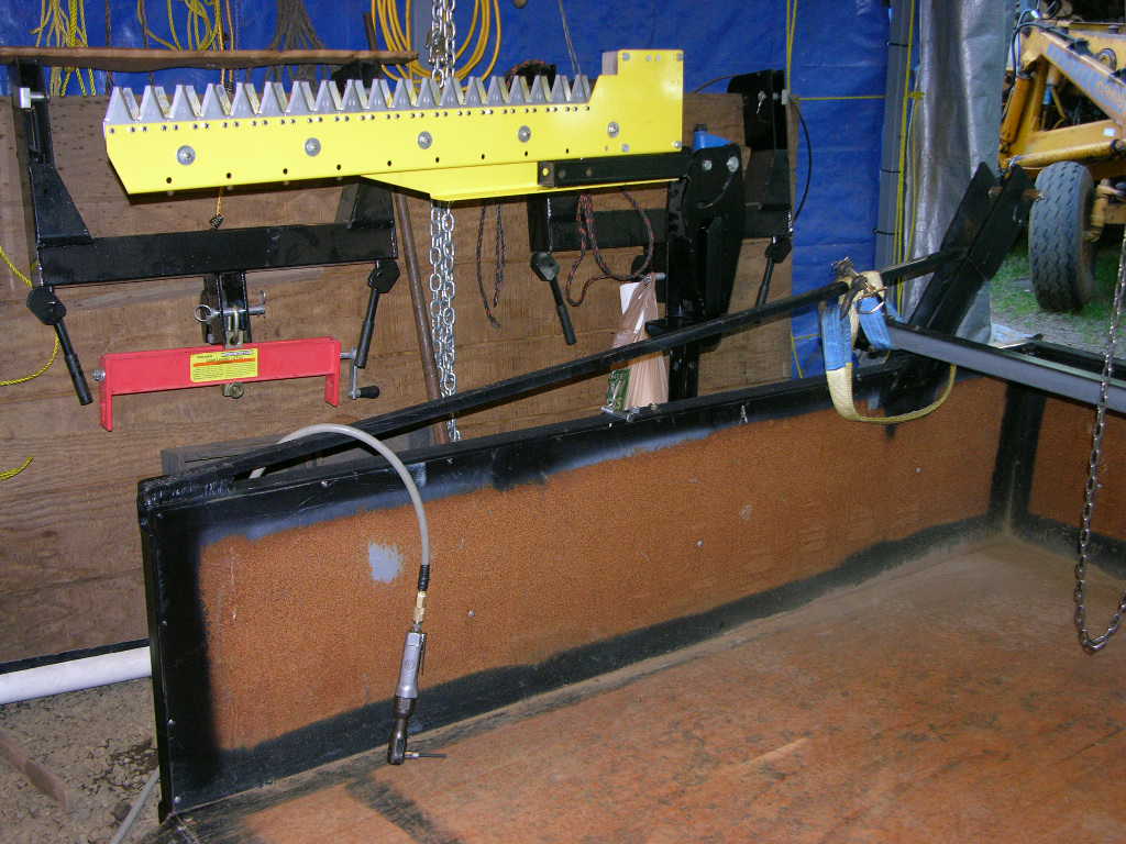

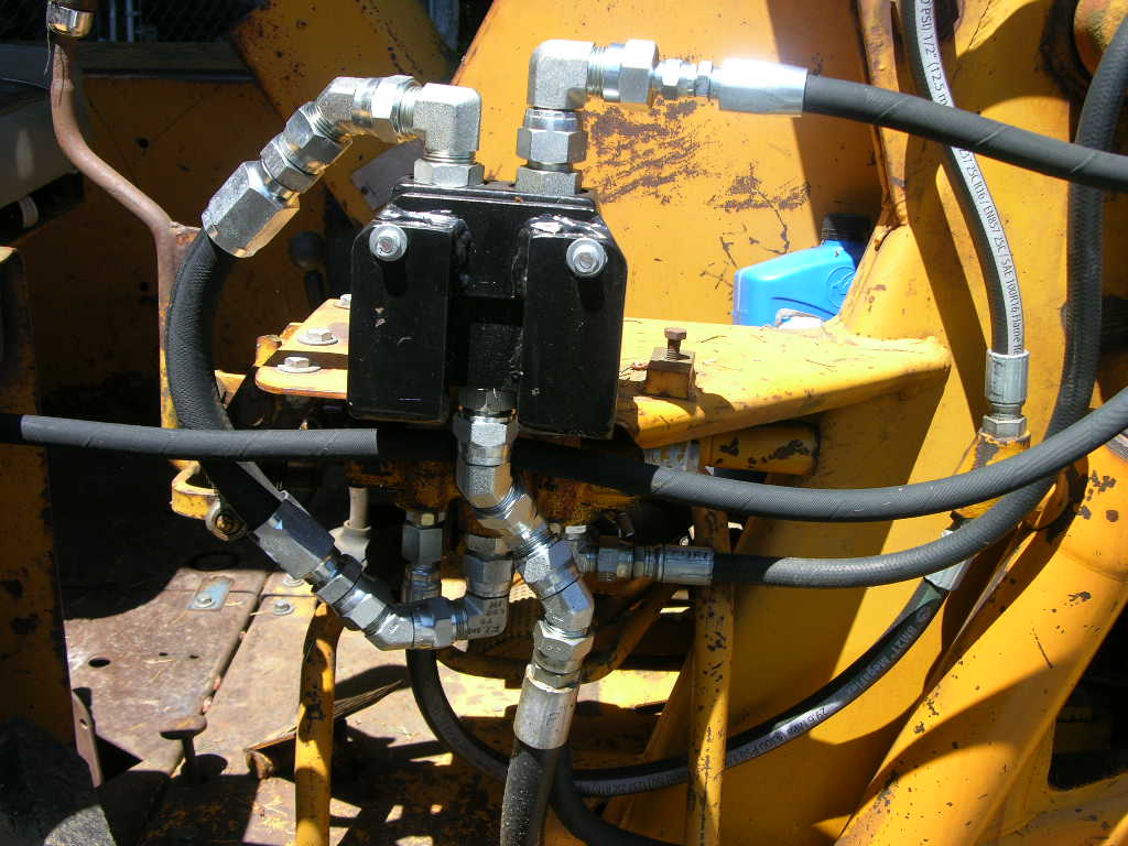

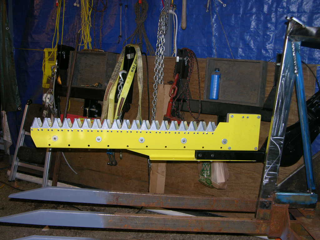

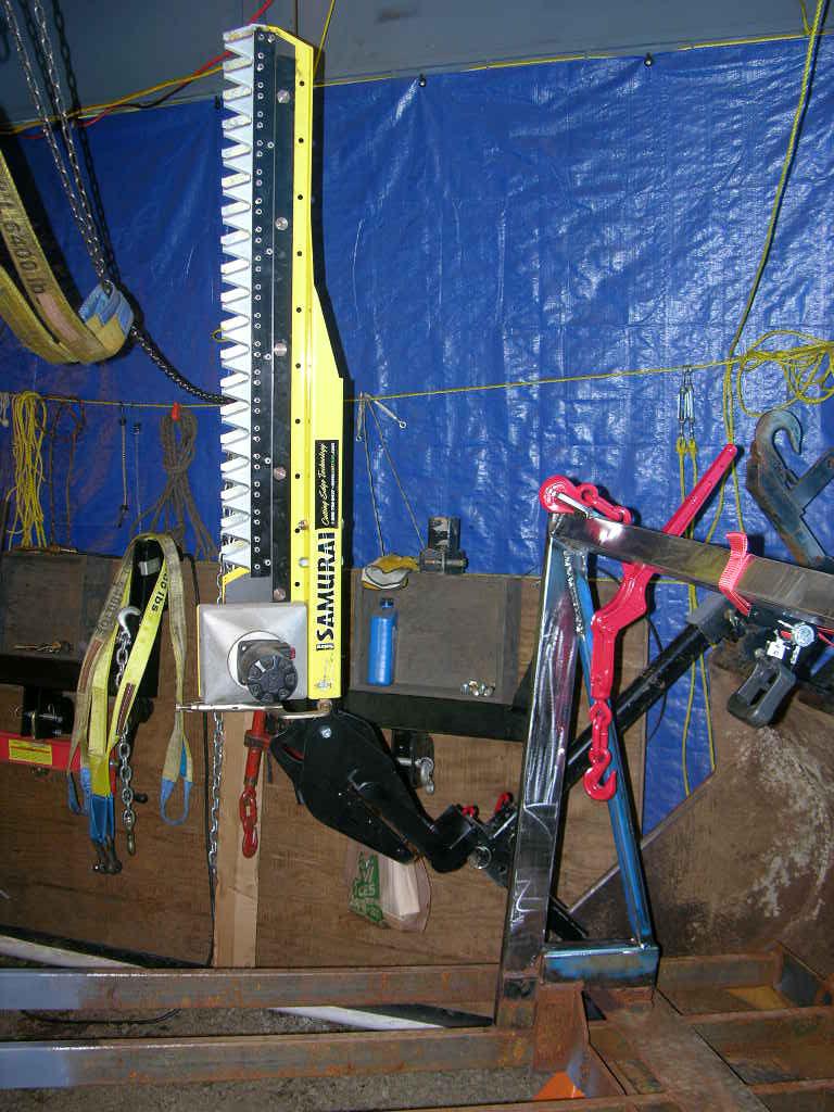

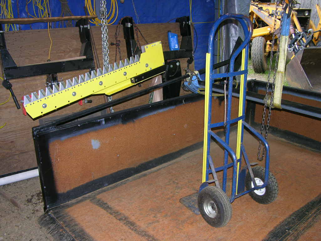

Gotta go finish the last couple bits of my "brain children", but here's a few teasers so far - The hydraulics are mostly temporary in order to "git-r-done" so I can use the stuff to whack back my hedges (neighbors - not as bad as SA's, but close) - then if I get the new shop enclosed before winter I'll re-do most of what's in the pix using hard tubing, except where it HAS to flex.
Apologies to Coyote Machine, my excuse is too many projects/too little time and space - hopefully you'll see something here that'll give you other ideas.
Oh, and I'm using the Prince RD112-30 flow control valve, 'cause I didn't want to restrict flow to the hoe when not using the Samurai - it has no relief built in, not sure if that was wise - it needed to have main pump flow run thru it and out the EF port to the rest of the system, with the CF (controlled flow) going to the sickle. ATM I just have a bunch of JIC adapters plugged into the bulkhead, won't know til I try a few things whether I'll need to change anything...
Feel free to ask questions about anything you see, I'll get to them probably later tonite or tomorrow. Gotta go weld some doo-hickeys onto some thing-a-ma-jigs, etc, so my newly modified brush forks will stay on the bucket and come off fast (but only if I want 'em to)...Steve

The first pic shows the sickle mounted over the outermost tine of a set of brush forks I built out of 1x3 .120 wall tubing - I'm hoping it'll let me get low enough NOT to have to pick up laurel trimmings by hand - the plan (wish?) is for the sickle to cut stuff and have it fall across the forks.

Pic 3 shows the flow splitter, temporarily hooked up with a bunch of 45 and 90 degree fittings for a trial run - eventually most of that will get replaced with hard tubing. The pump used to go into the bottom of the loader valve - now that line is moved to the input of the flow control, the upper left fitting is the EF port which goes BACK into the loader valve - the top right fitting is controlled flow - right now it's going to bulkhead QD's on the loader via 3/8 hose, ultimately that hose will get replaced with 3/4" hard tubing (same weld-on mounts will fit) so I can mod the mounts for my 6' flail and run it on the front.
Pic 4 is slightly different mount location, I've added 2" receivers midships on both sides of the brush bucket. Not shown is the option of mounting the cutter across the bucket for trimming those pesky low-hanging branches that keep trying to remove my hat when using the ZTR. Again, lazy/old way is NOT to have to handle EVERYTHING 4-5 times :mad:
Pic 5 sorta shows the (still in process) quick attach method for the brush forks - when it's done, it should be well under 5 minutes to swap from forks to bucket, with or without the sickle.
