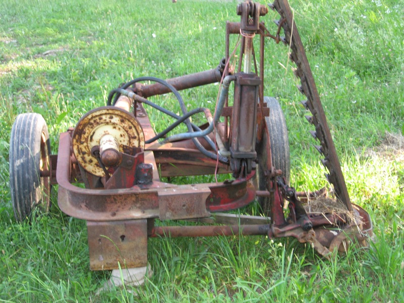

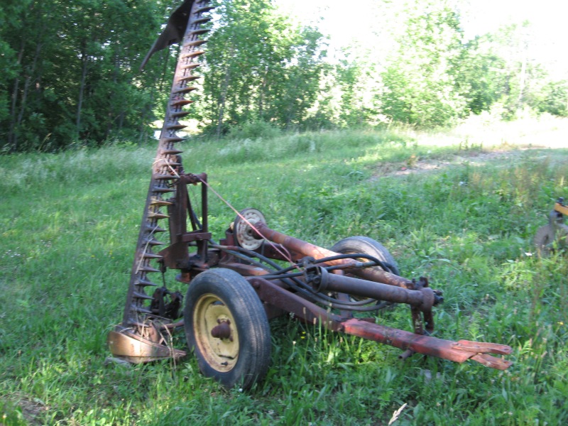

Chuck Lind: If you are interested PM me and we can work something out, I used it to mow about 18 acres last summer and it still works well.
