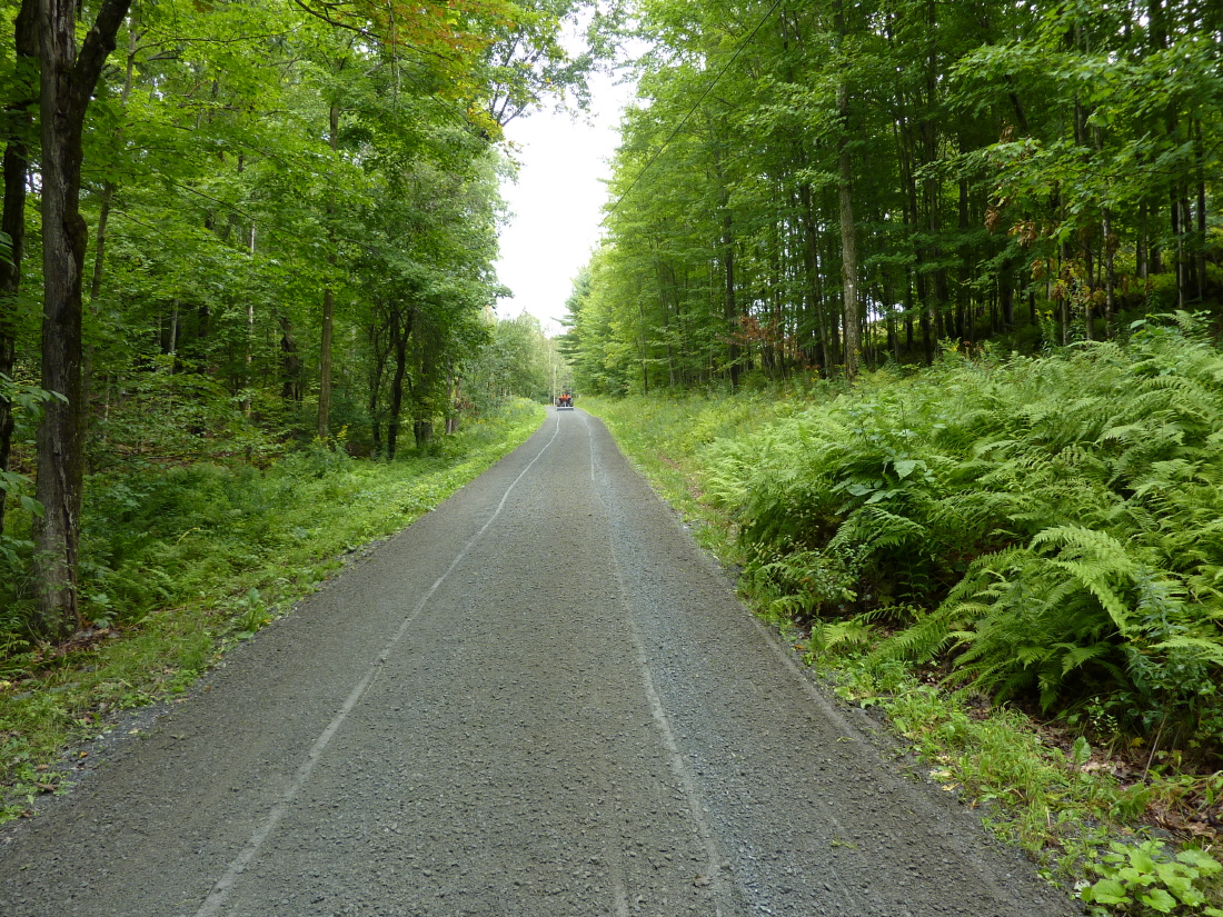

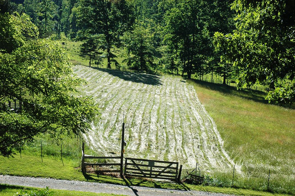

Sorry to hear about your sicklebar grief super55. I like my sicklebar. I couldn't mow a lot of places with out one. I do replace guard teeth and knives once in a while but it is just routine maintenance. The thing I don't enjoy is mounting it on the tractor and getting it set right. Seems to take me more time than it should. <img src="http://www.tractorbynet.com/forums/attachment.php?attachmentid=479869"/> <img src="http://www.tractorbynet.com/forums/attachment.php?attachmentid=479868"/> gg
Are those current pictures, or were they taken last year?
Last year. I like to mow after a frost kills all the ferns so I can see better

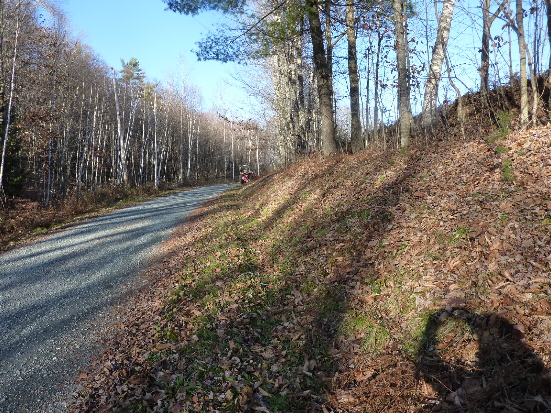

Last year. I like to mow after a frost kills all the ferns so I can see better <img src="http://www.tractorbynet.com/forums/attachment.php?attachmentid=479872"/> gg
I like to mow after the bees are dead.
