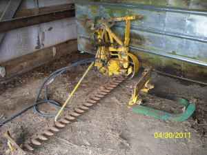

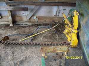

I've been eye-balling this one. Side mount and runs off 1000rpm PTO.
   / Sickle Bar Mowers
#12
How are the Kuhn FA 372 sickle bar mowers? The guy said it was an FA 392, but I am assuming he ment FA 372 since he said it has a 6' bar. Does anyone have any pictures of one? I tried looking online, but couldn't find much on them.
