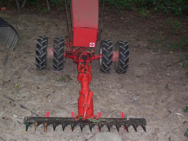

/ Sickle Bar Questions #8
I use mine for cutting Autumn olive bushes and green briars.
Solo

/ Sickle Bar Questions #9
I've used a Gravely with a 5' sickle bar (4' seems to be much more common) for 30 years. It's great for mowing briars and up under trees, etc., but sometimes grass (esp. soft Orchard Grass) can be a pain. When grass is leaning, it helps to mow in the right direction. It does vibrate a lot at higher RPM's. We used to joke about what happens to a young fruit tree when you attempt to mow up close. If you see it start to shake, it's too late. It's going to have the "Gravely wilt".
Incidentally, the knives (triangular cutters) for a Gravely sickle bar can be replaced with John Deere knives, and the JD knives last a lot longer and are less prone to breaking. They can be 3rd party replacement knives for a JD; they don't have to be JD brand.
I've also used a 7' JD sickel bar on the back of my tractor. Smooth as can be in a large field, but very unwieldy in tight places (like in an orchard).
These sickels can cut 3/4" saplings with ease. They can also cut legs off small animals. :(
