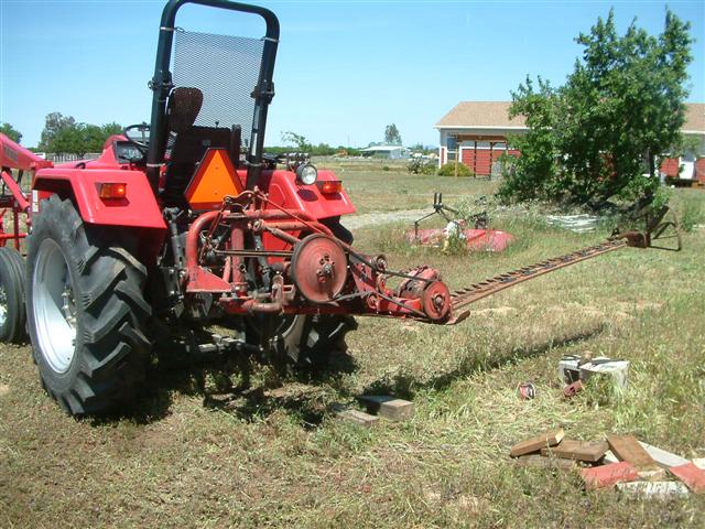

I'd go with the NH unless you enjoy the challenge of refurbishing a sicklebar (cutter sections, rock guards, hold down clips). Any type of $400 sicklebar is going to have to be extensively serviced, almost rebuilt because of parts wear and alignment issues.
Whatever you buy, get the operator, service and parts manuals so you have the information you need to get the thing running and keep it running.
So far I've rebuilt two sicklebars--a 7-ft Massey Ferguson 31 and a 6-ft Allis Chalmers pull type mower. I paid $550 at auction for the MF31 and put about $200 in new parts to get it working. It's finally mowing pretty well but it was a struggle to get it going properly. The AC mower cost $125 and needs new bearings in the drive mechanism. I'll fix it one of these days.
The MF31 is a bit of a hassle to attach to the 3-pt hitch on my Mahindra 5525 because of the way the pins on the mower are arranged. It takes me a good 20 minutes to get that thing hooked up correctly.
Good luck. And be careful out there--it's easy to cut off a finger with a sicklebar mower.
