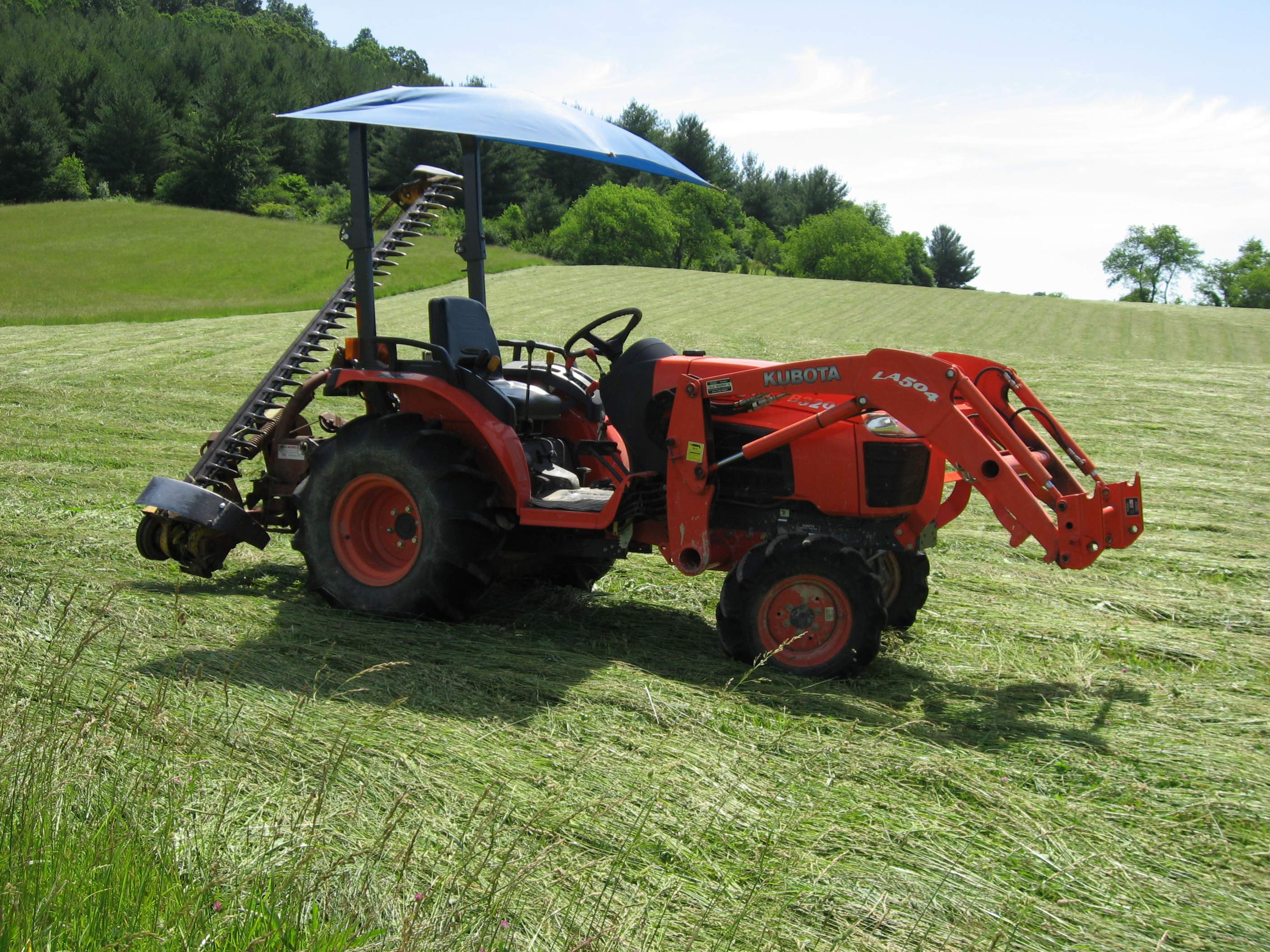

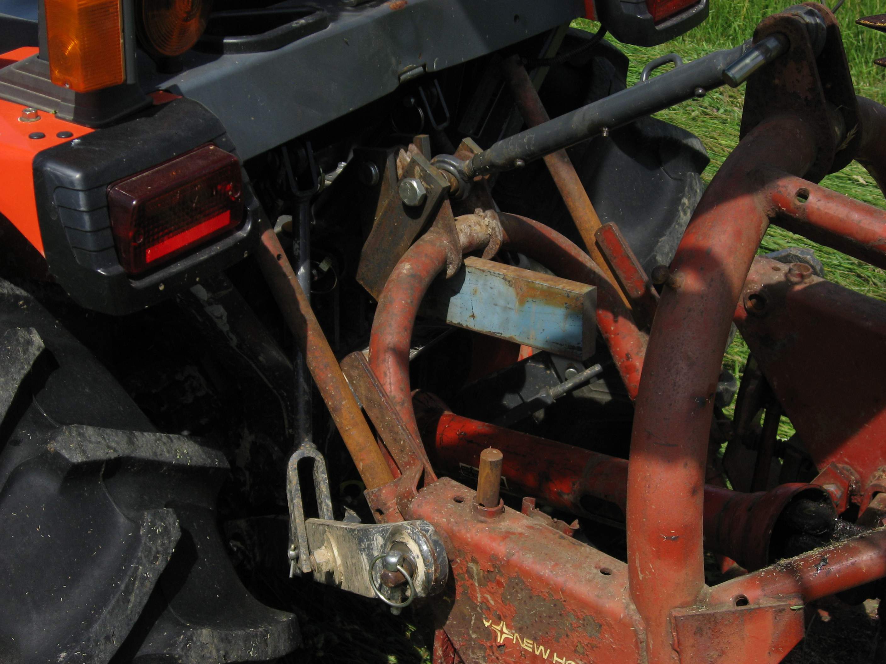

The 450/455 and 451/456 New Holland sickle bar mowers were probably some of the best ever made. We have both an old 450 from '68 and a 451 from the '80s. I have mounted the 451 on my little B3200 before, so your M6800 should be no problem. That said, I had to make an adapter for the toplink. It's a pretty straight forward adapter and NH even sells a couple different ones, they call it a compact tractor adapter. You may or may not need it, but you will have to adjust the yoke and lift cable length to fit your tractor. An owners manual would be a good investment.

There are issues with hookup on NH 450 and 451's on Kubota's because of the unique hitch on the mowers. Ken Sweet

The upright parts of the yoke might hit the lift rods on your 3pt hitch. I doubt it will be a problem, but the potential is there. As I mentioned, there is a bracket that moves the yoke back and will cure this. Once the mower is setup for your tractor it will be as easy to take on and off as on any other tractor. There is a ton of adjustable in these mowers. Attached is a pic of a NH 451 on my B3200 and of the hitch setup (with my homemade adapter bracket).
