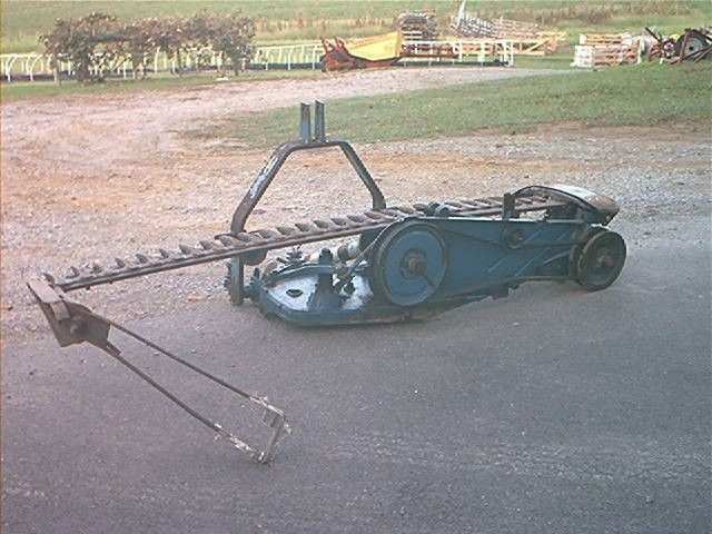

Danny and Greg, Thanks for the response guys. Danny, I understand your position regarding buying from pictures (not exactly SIGHT UNSEEN) BUT this seller is quite active on eBay and I read his buyer's ratings/reports on him. No bad ones. All rated him well. Some were most lauditory. This gave me the boost in confidence to take a chance. Besides, if it is a conspiracy and all his eBay sales and buyer's reports were faked by him and or his relatives to give him a good reputation so he could make sleazy deals on the side (not over eBay) then he is smart enough to refund my money for the product and shipping if he has materially misrepresented the goods in a flagrant manner or he will have to deal with me in person. I'm that kind of guy. I can drive to Kentucky to confront a bold and sleazy operator if that were the case. I really don't think I'll have a big problem and don't think the rave reviews were faked in an elaborate plan to gain a good reputation to sell via other means than eBay.
He claimed that he hooked it up and tried it and that it works OK but needs sharpening so he sharpened it.

I have a 505 sickle mower its the best Ive used around the farm,its great for cutting along the roads,and fields,you dont have a pittman arm so it cuts standing straight up,but dont let it stand straight up it could fall back on the mower to hard,safe 80 degrees is ok,I was looking at the picture of the 505 you are looking at,there is a piece missing,its the spring that keeps the tension on the mower,when you left it up,it will stay level,if its missing it will fall down on the blade side,but thats still a good deal for the mower
