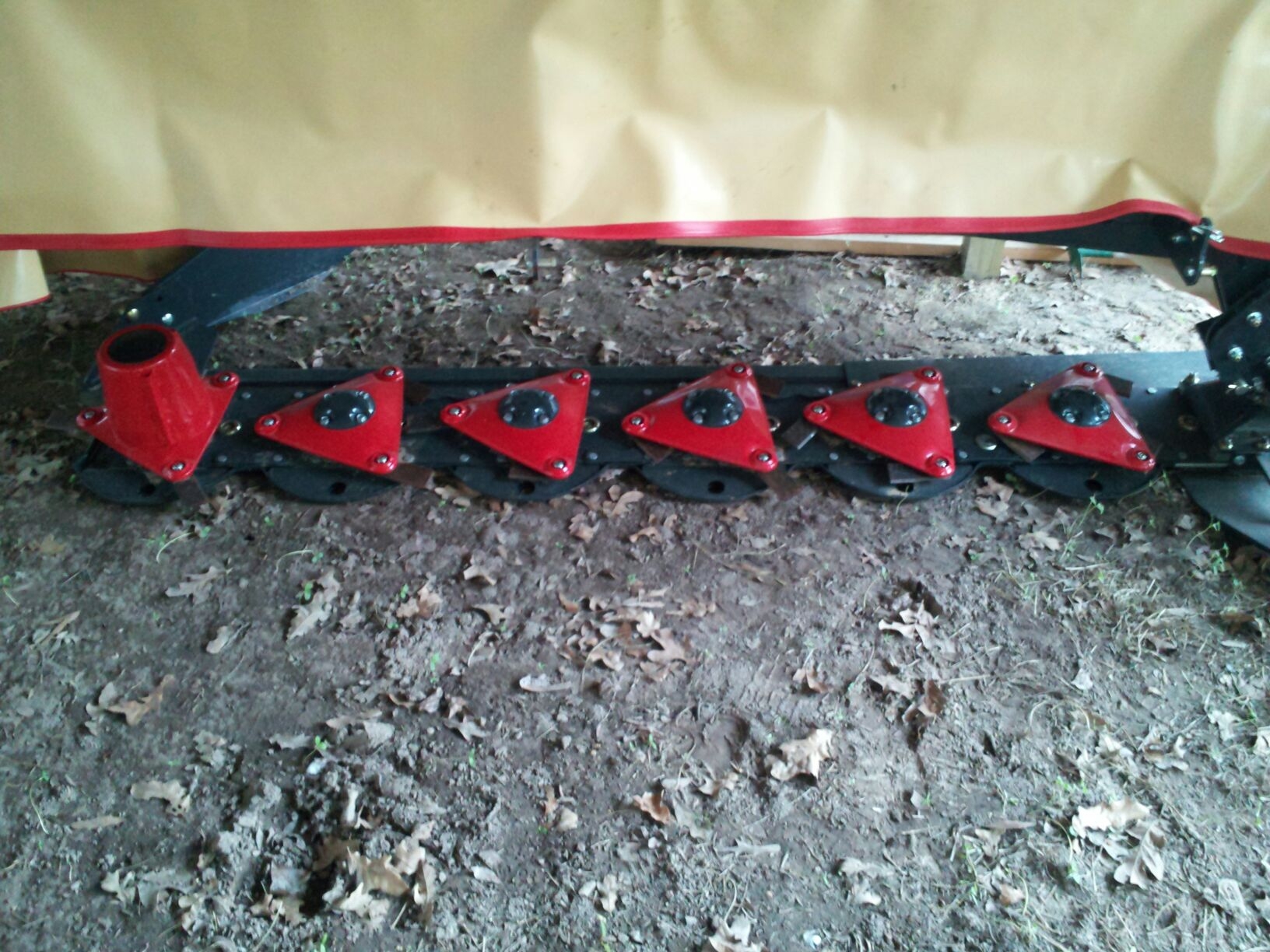

I bought the VICON, the three blade system allowed me to go a wider cut with what hp I have vicon cutters.JPG
They only way it will throw anything on you,is if your cutting with the cover up..

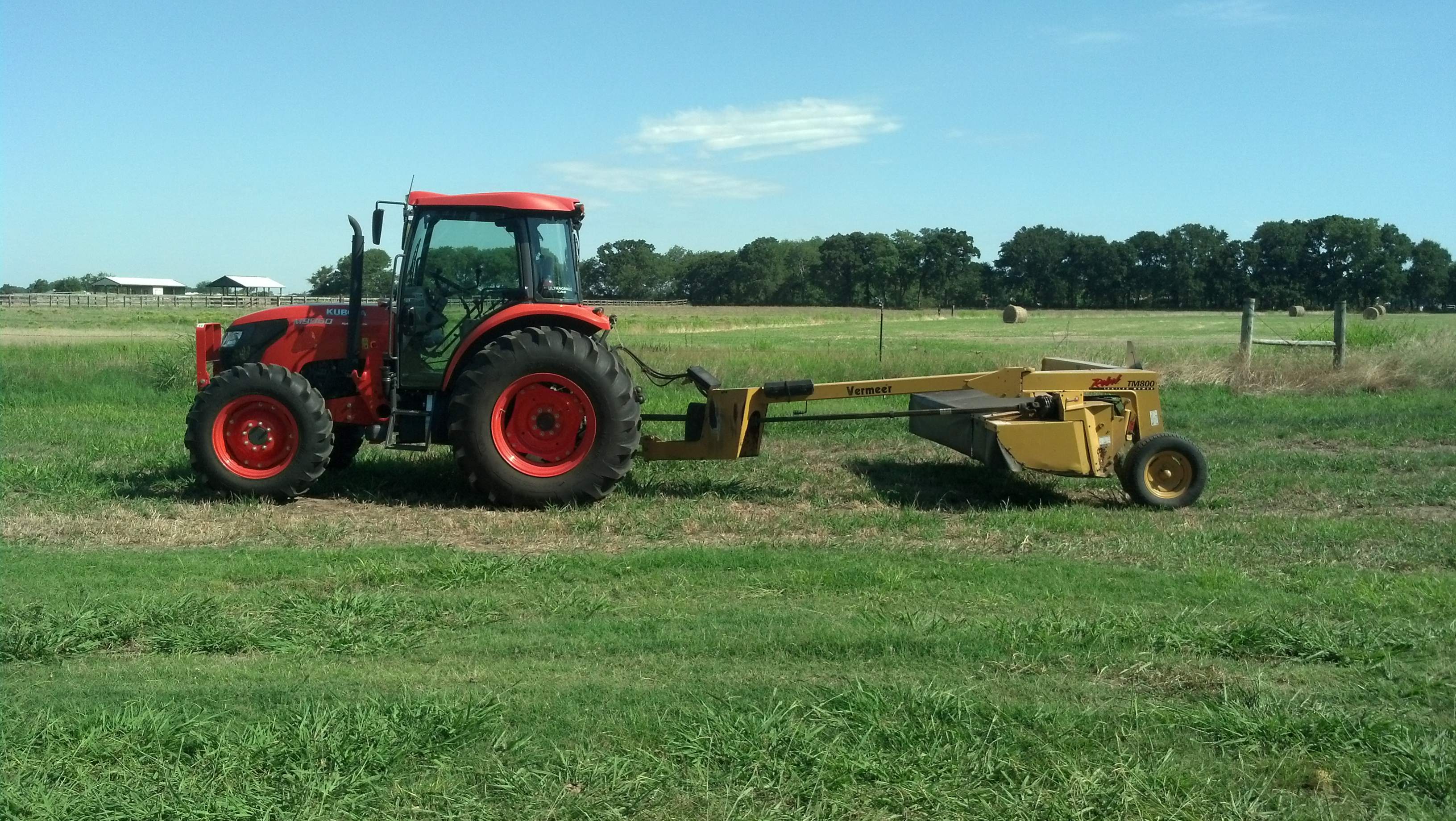

IMG_20130630_100119_196.jpgWe have a Massey/hesston rotary good mower however it seems to be hard on even our big tractor, if we had a caddy not so much. We have just purchased a tm800 and the first thing I saw was how easy it was to change blades. About 15 min for the Vermeer and 45 min on our Massey. Second I bought it used for 6500 and the darnd thing cutts like my a champ. U can see everything you mow . Have not tried it on our little tractor yet but it seems like I can go as fast as the field will let me. I will be cutting a very smooth field in about one hour and we will see how fast I can go . For right now I know the thing can handle 7-8 mph quite easily.
I am thinking about getting a "new" mower and I would like some opinions. I currently have one double 7' Kosch sickle and one 9' JD sickle mower. I am possibly haying by myself this year, so speed is important, and here is what I was thinking about as far as choices. I have varying types of grass, a lot of lowland/thick (if it would ever rain), and some very thin, mostly flat ground. I only go over about 900 acres or so a year. The two choices below are basically about the same price.
A Kosch double 9' hydraulic drive sickle mower. This is similar to a Rowse mower, but I will not buy any Rowse product no matter what.
A Vermeer TM800 disc trail mower 10.5' cut. I don't know anyone that has a disc mower, and I know little about them. I thought I heard that you could mow faster with them. If so would it be possible to mow about as much ground (in the same ballpark or close) as the 18' sickle?
I don't want a mower conditioner, anyone I've seen with those the hay gets moldy before it's dry, even when they turn the row over. I don't want a drum mower, I don't think there are any of those around.
Thanks.
